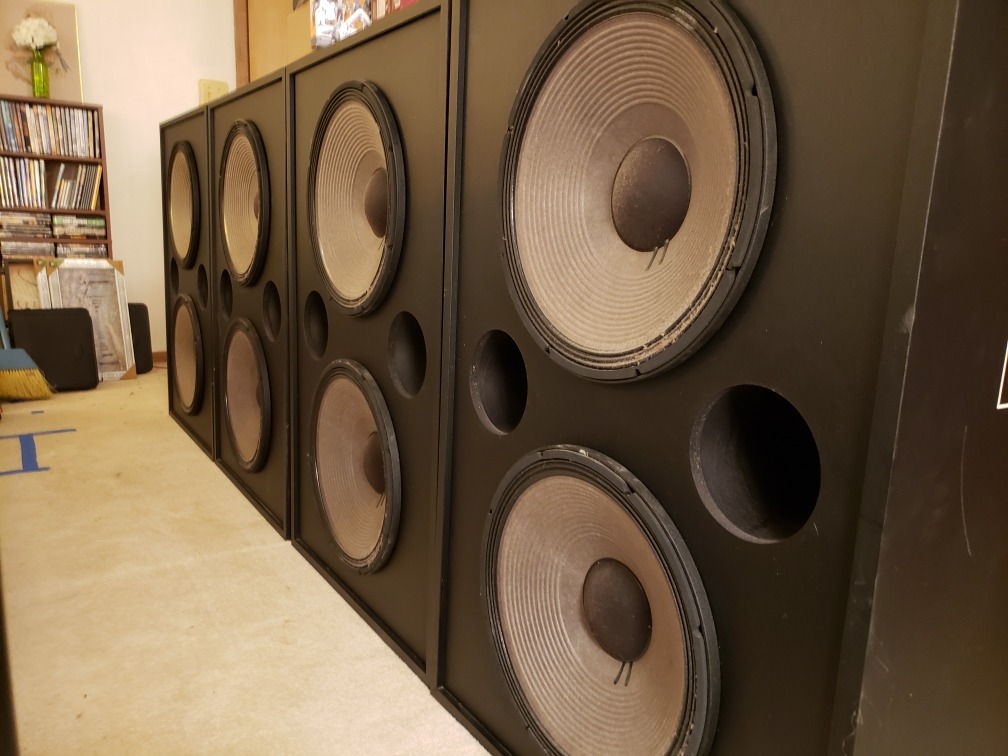

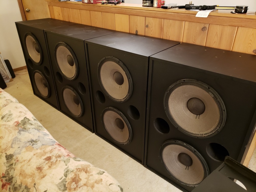

I'm starting a project of incorporating 8 JBL 4648A dual 15" speakers into my living room to try and better pair with the line arrays I've already built.
Here is a link to that thread: https://www.diyaudio.com/community/...ale-25-driver-ids-25-line-array-build.336698/
The plan is the make two "bass towers" on the front wall behind the line arrays and the other 4 will go behind the couch against the half wall that's the exact width of the 4 speakers.
To keep my wife happy, I'm going to refinish them in white.

I only have one of the JBL's in the room right now as I'm still trying to refinish them all.
For context, I currently have five subwoofers in that setup: 1 15", 2 x 12", and 2 x 10." All the subwoofers off and using this one JBL I'm finding that the bass really is "faster." I really thought that the existing setup of five distributed subs would give an equally "fast" presentation as each one is sharing the load and therefore has more headroom.

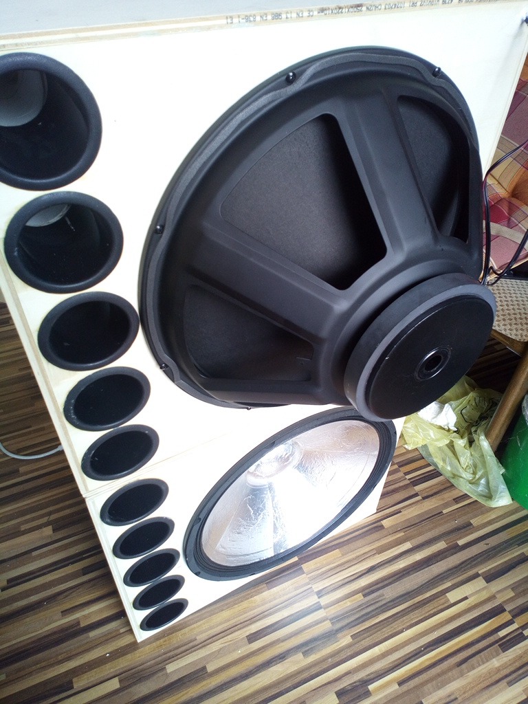

Later I wanted to replace them for four 12 inch Sica 12d full ranges built back to back in one enclosure as a dual monopole, also sandwiched with aluminium foil a speciality I do. But I never finished them.
So efficiency of the bass array was hilarious good draining no electricity from my Behringer Inuke Nu3000dsp amp.
Also I wanted to cover the bass drivers from the backside with alu foil, too. But did not do that until now.
Here I describe how you can DIY.
https://www.diyaudio.com/community/threads/how-to-make-a-loudspeaker-sandwich-cone.402917/

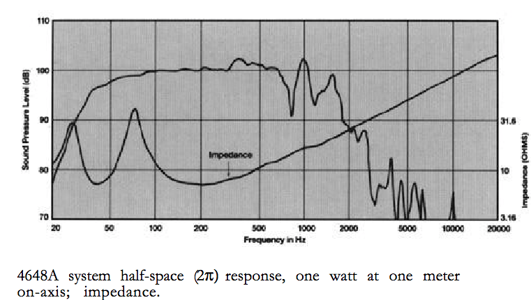

The 4648A box tuning (Fb) is ~45 Hz, the port output becomes out of phase with the speaker output much below Fb.
Response drops ~24dB per octave below Fb, but no amount of eq will fix phase cancellation.
The ported output lags ~ 180degrees from the speaker output, sealing them would make the bass even "faster."
With sixteen sealed 15" woofers, you could EQ flat to 10 Hz, and produce ~107dB SPL (discounting any room gain) while still being under the JBL 2226 driver's Xmax of 7.62mm, assuming enough power.
The sealed cabinets should be capable of ~120dB at 20Hz, some would consider that "crazy volume" ;)
Others would consider that level to be more than adequate for THX certification...
