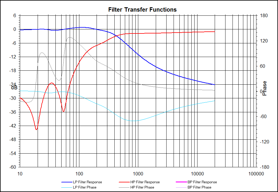

Planet10: Question about the 1st order series XO a couple post back. I tried playing around with 1st order series in PCD with a couple different drivers in a fast crossed around 400Hz, but I can't get the phase anywhere close. Did you end up with good phase in your design or do you maybe not worry about it XO that low?
Pole? Do you mean a cap? With second order parallel I can get the phase fine and okay with second order series. I just started trying to model series crossovers; very weird.
I just wanted to try the 1st order series for less/cheaper parts. I can get the response pretty decent just not phase, much better than the 1st parallel (FR not phase).
Keep a careful eye on impedance and your transfer functions when doing series.
Yes by adding a pole I meant a cap. Make it second order.
The impedance is hovering above 6 ohms and the transfer function shows an impedance spike, but it doesn't show in the driver response.
The phase is very odd for the full range driver below the crossover frequency. Wavy or loopy
This is just playing around, but why does the full range (Red) and it's phase look so weird below the crossover. Is that right?

That's because of the impedance peaks in the full ranger I'm assuming.
If you get a peak in the woofer response due to the cap, you need to make the cap smaller. Try something like 5mH and 50uF on the woofer. And 30uF and 3mH on the full range with reverse polarity.
Is that image a series cross over? It looks like it. My above suggestion is for parallel, but about those values should work for series also.
Yes, that is 1st order series.
I don't get those peaks with parallel, only series. I have no problem getting a nice response, phase and driver rolloff with parallel 2nd, I just wanted to see what could be accomplished with 1st order series. Maybe these drivers aren't so good for it.
