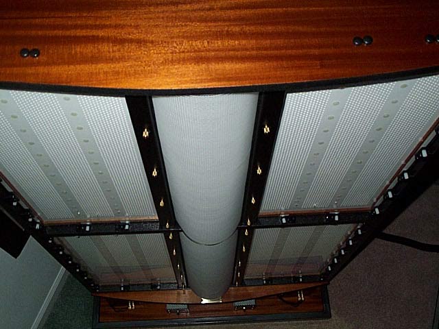

Is this an old Quad?

No, it's not one of the Quad 57s. Not an ESL63 either. Could be one of the newer models (I haven't seen their guts), or someone else's speaker altogether.
The newer models are close enuff to the 63 that you'd recognize a family resemblance, so these are another maker. I assume the damped part in the middle are tweeter panels?

That's Wayne Piquet's work on Quads. He rebuilds them (after bombarding me with lots of questions to learn how). He's into different frames and lots of finish changes. Not my cup of tea, but style is subjective.
