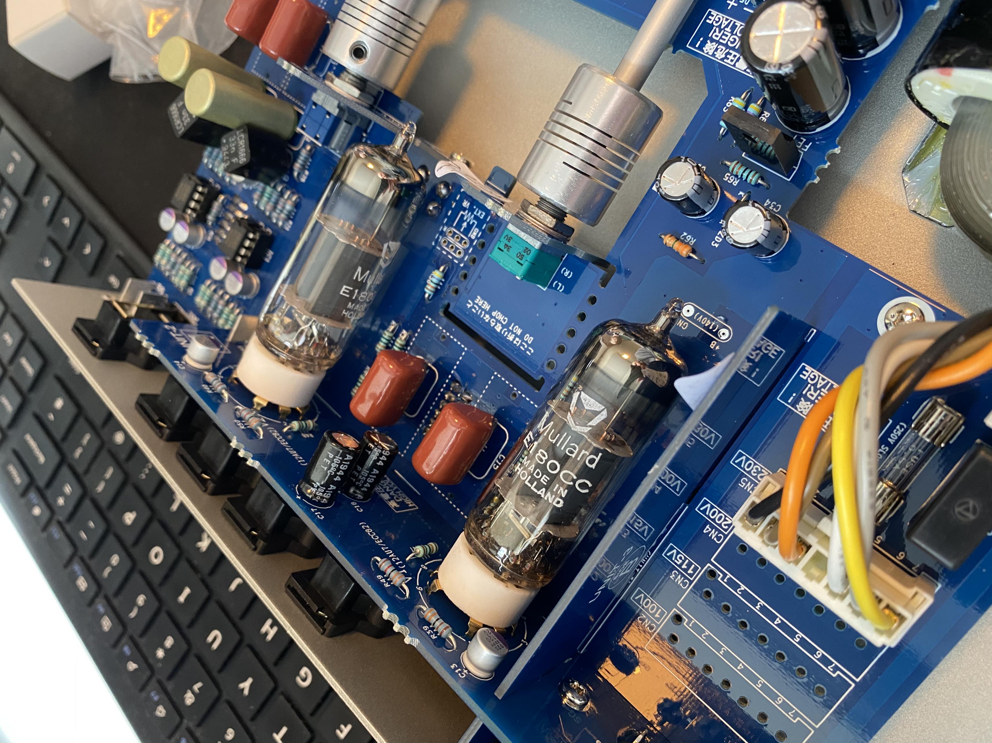

VKung has recommended the 5965a a few times, so it seems the TU-8500 is fine with the higher filament current. This gave me the confidence to try some Mullard E180CC which seem great so far (E180CC has higher filament current that 12AT7/12AU7, but less than 5965a).
Another decent (cheap) option to play with 🙂

Another worthwhile upgrade is to replace the output caps. (Between the two tubes in your picture.) The stock caps are OK but nothing special. The basic Mundorf Supreme caps aren't very expensive in the value needed. A bit of lead bending would be necessary and maybe sliding a bit of tubing or stripped-off insulation over the cap leads would be a good precaution against any electrical grief.
S.
Agreed. I ran the numbers and the stock 0.47uF caps at the outputs will roll off a bit early for my liking (with a typical amplifier input impedance). I used 2.2uf ECWF at the main outputs and also at the outputs of the phono section. They look a bit like the standard ones but they’re not 😉
I think my days of oil / silver / fancy caps are behind me. I’ve got tons in boxes but am generally pretty happy with decent polypropylene and polystyrene caps (that have a data sheet and good specs).
I’d definitely address the cap values before worrying about boutique options.
Edit: I used alternative electrolytics in all places. The standard caps are very decent, but it’s not a huge cost to upgrade to superior parts with 8-10K hour lifespan at 125 degrees C. Electrolytics always kind of bug me, as they degrade over time (more than most other components) so I pretty much always start with top spec parts. I do check ripple current, ESR etc to ensure I’m meeting/improving on the parameters of the standard parts.
