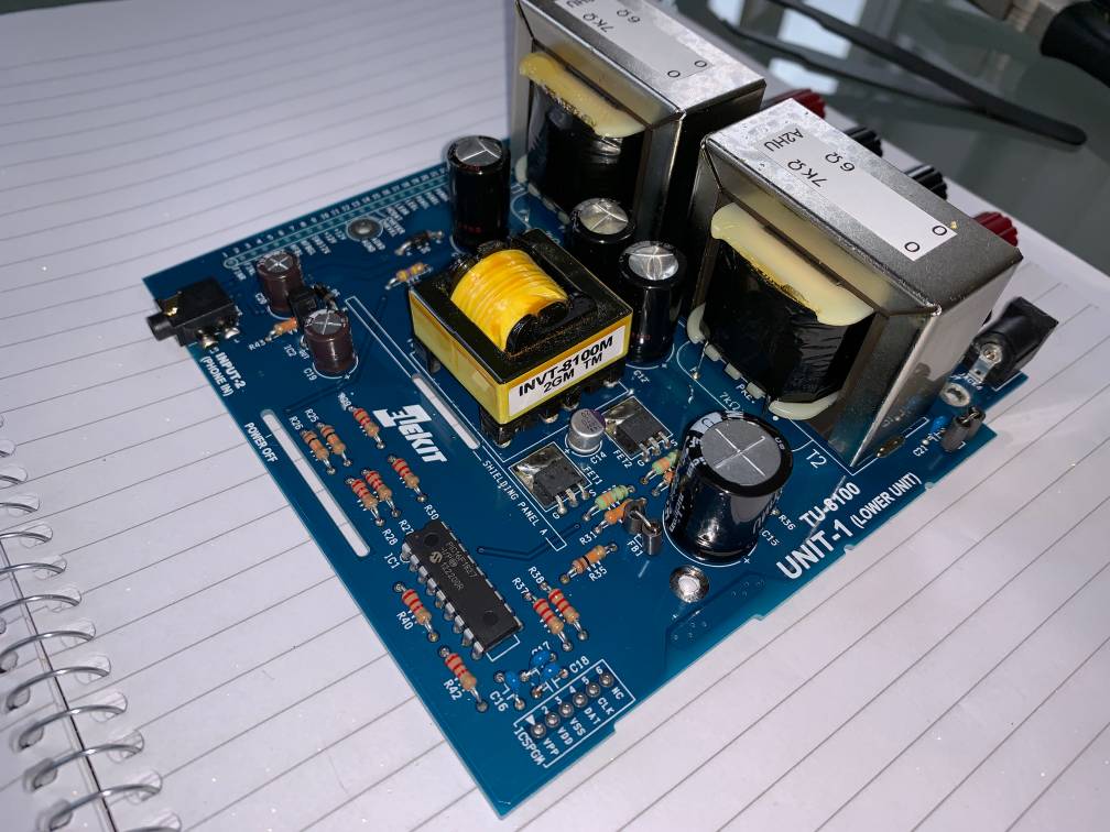

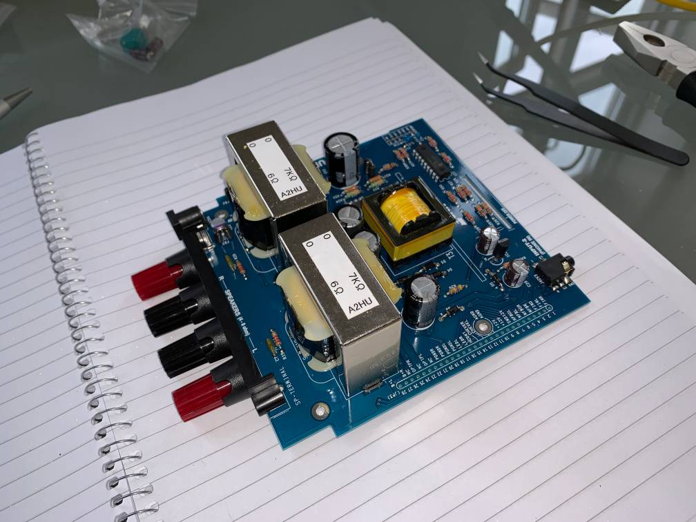

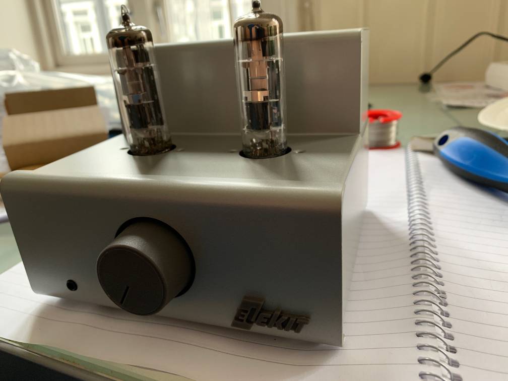

This is my first time attempt at a kit and using a soldering iron. Not sure what had happened. The other transformer laid flat fine but this one was soldered crooked. Is it OK to leave like this? Not sure how to fix it since the tabs had been soldered.
If the soldered connections are solid, I don't see a serious problem - but the far more experience folk on this forum may well know better / different. But if you're learning to solder, you will also need to learn to unsolder to fix the inevitable errors and mistakes, such as this one. (It likely got off kilter when you turned the board over to solder it from the backside - this happens to me frequently.) My soldering kit came with a vacuum desolderer - it's an unassuming device that looks like a syringe, but it generates a strong suction after the plunger is pushed into position and then released. Reheat and melt the solder you want to remove - push the nose of the desolderer as close to it as possible - when the solder liquifies, push the button and at least some of the liquid will be sucked up and away. This may need to be done several times to remove enough solder in a case like this, but it will (eventually) do the trick. There is also desoldering wire - a copper braid that will absorb molten solder. I've had less luck with it, but perhaps that's because of lack of experience. Good luck and be of good courage!
Thanks for encouragement and advice. I was ready to toss the soldering iron out the window. I used the wick braid to absorb the solder and it worked great. I was able to reseat the transformer.
