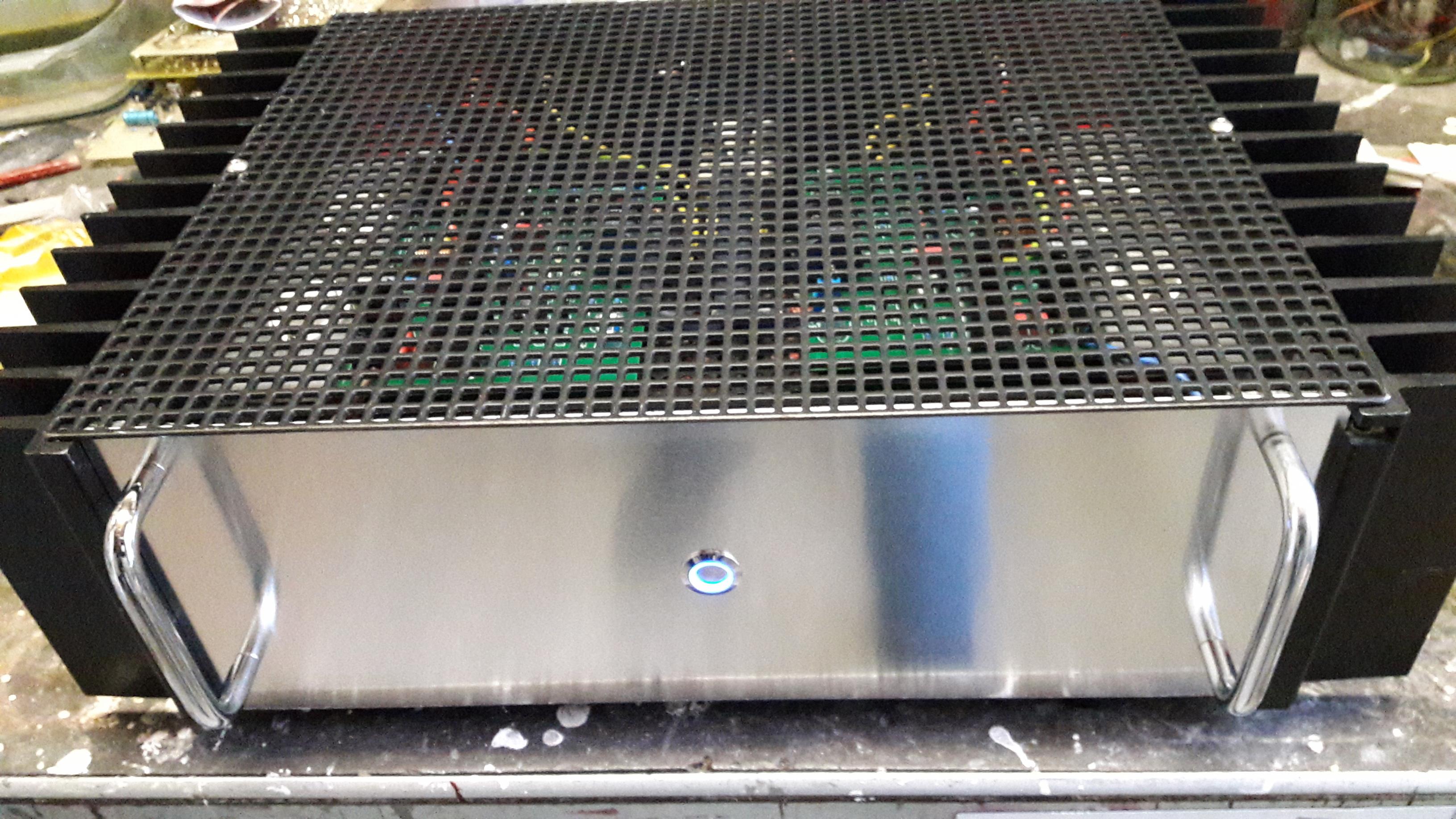

Elektor AXL V2 with Lateral MOSFETs

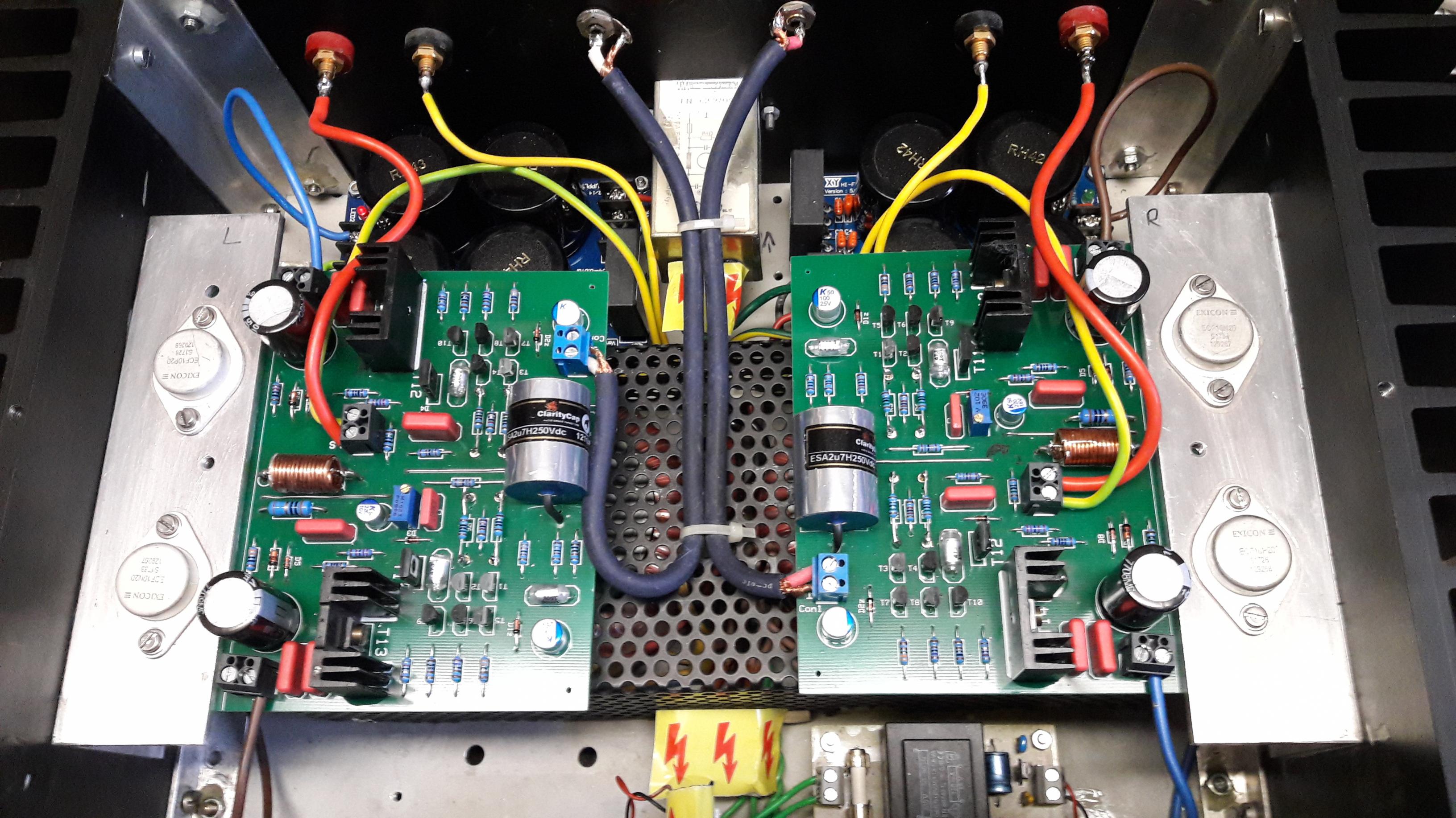

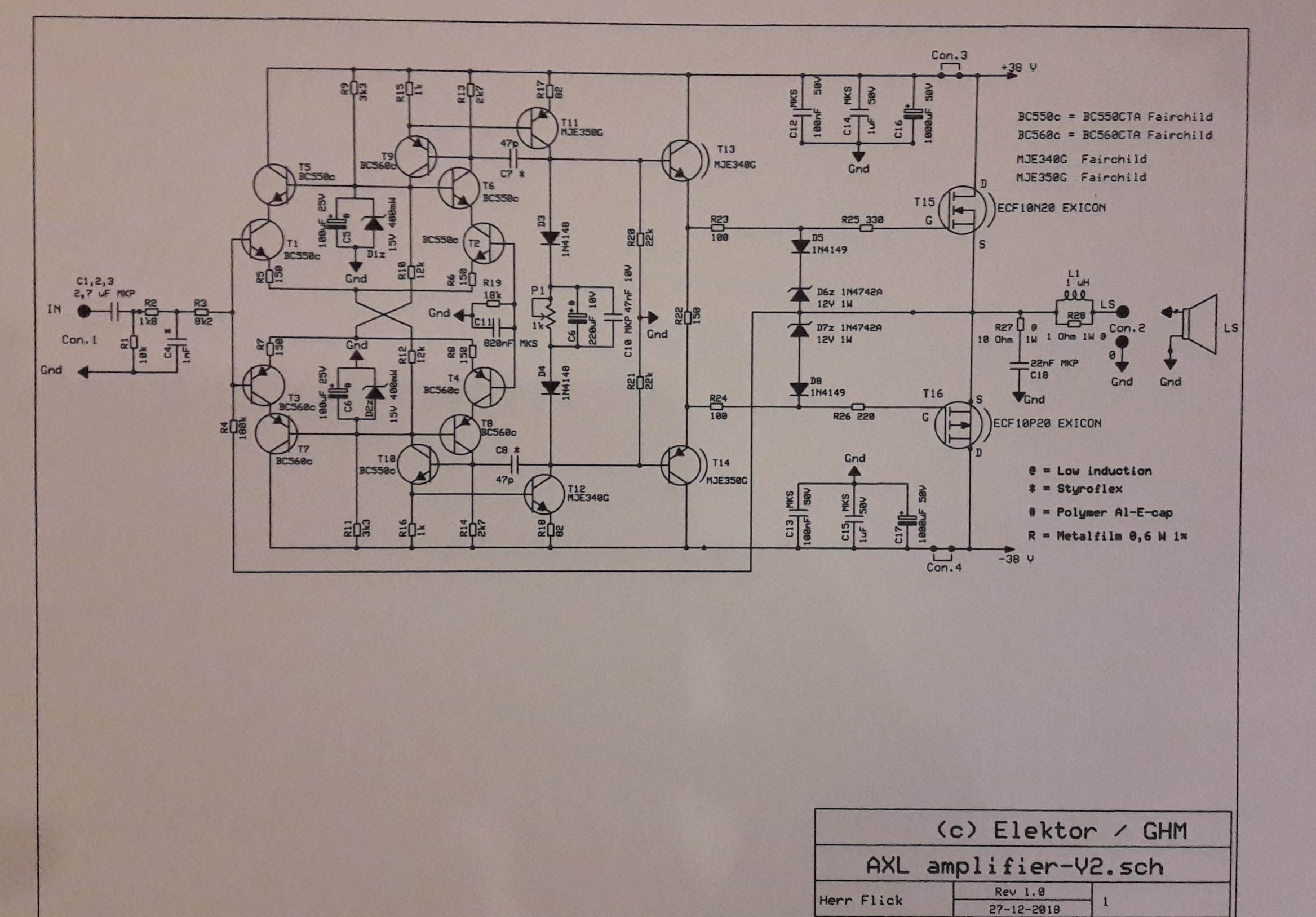

More then 30 years ago (1985) I build the Elektor AXL class A/AB amplifier, time to upgrade this amplifier using new (= better)components.
My main goal was to replace the power mosfets 2SK134/2SJ49 with Exicon ECF10N20/ECF10P20. Also the medium power transistor BF469/BF470 changed to MJE340G/MJE350G.
Extra power supply filter capacitors where used and placed on the PCB.
The two capacitors for the 15V zener diodes where increased to 100uF 25V
and the capacitor parallel to the quiescent current potentiometer (1k) is increased to 220 µF (Single-Ended Conductive Polymer Aluminum Solid Electrolytic Capacitors)plus extra 47nF WIMA MKP.
The two source resistors (0,22 Ohm) are no longer needed.
The input capacitor (C1,C2,C3-820 nF) is replaced by a high end capacitor 2,7 uF Clarity Cap ESA.
The Exicon Application notes told me to decrease the inductance in the output line to 1µH (1mm Cu wire inner diameter 8 mm, 15 windings). Due to different gate input capacitance of the mosfets the gate resistors are also different, 330 Ohm for ECF10N20 and 220 Ohm for ECF10P20.
The power supply for each channel (2x25V AC 2,4A 120 VA) is filtered by 4 x 10.000 µF rectifier (Ebay) so that results in 2 x 38V DC output voltage.
It is still very important to set the quiescent current potentiometer to zero Ohm before switching on the amplifier for the first time.
I tried to use the same component labels but did not 100 percent succeed.
On my old (same as me) but still working oscilloscope (Philips PM3226) I saw a maximum error free waveform of about 60 Volt peak-peak with a 8 Ohm resistor load.
No oscillation what so ever, 60 Volt peak to peak over 8 Ohm i.e. 30 : 1,4 = 22 Watt output power with a quiescent current 0,1 A.
The calculated damping factor is more then 200.
I am using a Rasberry Pi in combination with the HiFiBerry DAC plus and a home made power supply (5V 3A), controlled by Volumio software, NAS. The loudspeakers: Acoustic Energy AE1.

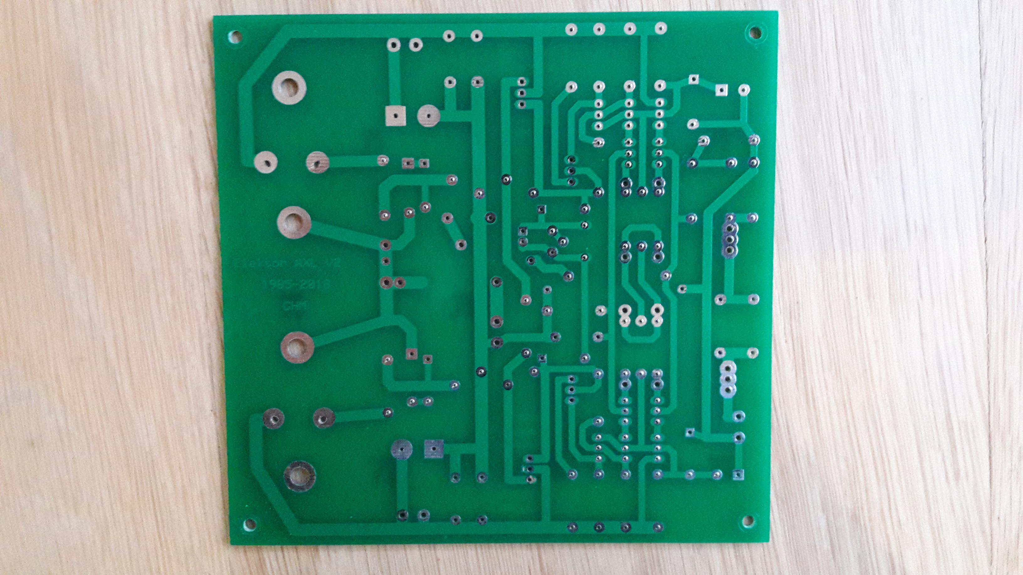

Thanks for your reply -mlloyd1-.
I checked again my schema with the original one from march 1985 but I asure you there is no difference at all. I also check the pcb layout again and came to the same conclusion. If there is a problem then my amplifier could probably not produce such a clear sound at all I think.

Well -phri- that's one of the reason I reconstructed my amplifier. My old PCB was homemade, drew with a pencel and was only a copper surface and the soldering tin was old fashioned with lead. My new designed PCB was professional made and I used tin/silver soldering. To bypass the input capacitor is a tricky thing but as long as you use your amplifier with a well known sound source then you have a advantage because the input capacitor got a great influence on the overal sound quality. Thatswhy I used a high end capacitor instead. Yes, to drive a electrostatic loudspeaker you need a lot of power. But the sound quality is excellent but often a little lack of bass. I would like to to tune my elektor AXL V2 for instance by raising the quescent current to 200mA for less distortion. And I have to determining the gate resistor values as well. One method to determine the right gate resistor value is to overdrive the amplifier with a square wave. The shape of the rise and fall curves will indicate a correct value. A very good application note with lot of information is: http://www.ti.com/lit/an/snaa045a/snaa045a.pdf

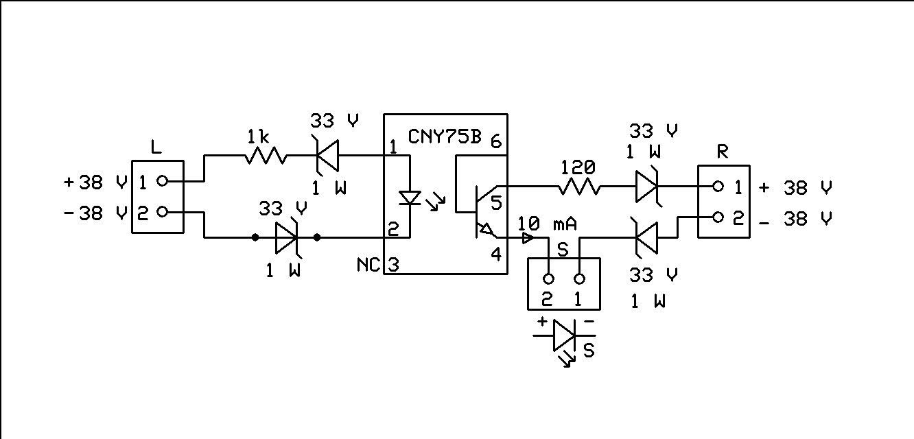

Nice to hear from you -Metanastics- What a pity we live so far from each other. I would like to make a direct compare between your old AXL amplifier
and my upgraded AXL V2 amplifier. I recently made a tiny modification for the ON/OFF switch LED illumination. It was powered by a old fashioned
small powersupply with a 1,8VA transformer and 100mA stablized 12V out. But I realized that it would be more usefull to have a more "intelligence"
one. This signal LED in the ON/OFF switch should go ON when all the four power supply voltages (-38V and + 38V) for the left and right channel are in good
health. If one of them is down the LED signal should be off. So I used a opto-coupler powered by the four amplifier power supply's. It is just a small PCB
which can easily find a place inside the amplifier.
