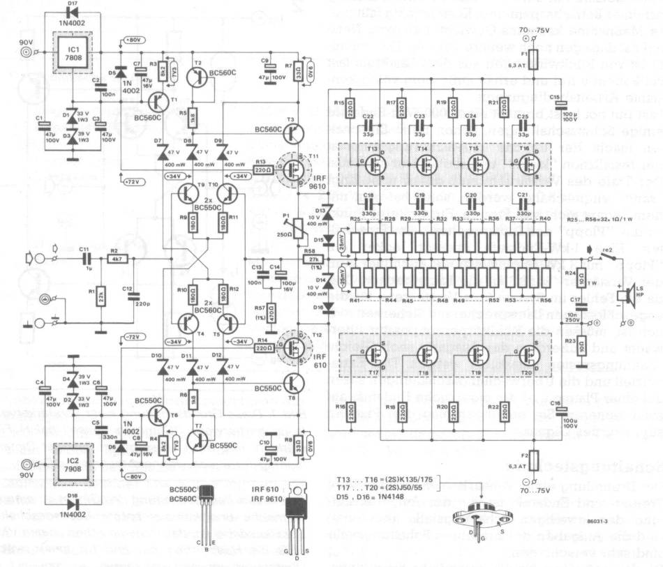

schematic gigant
Thank you for your interest.
Here is the original schematic of the giant (gigant).

I made some new meassurments on my amp:
When i switch off the amp, the +90V on the input of IC1 (7808) jumps from +90V down to +70V. The same happend on the output of IC1. Here the voltage jumps from +80V to +70V.
From +70V i meassure a slow unloading curve from the cap.
Why does it jump so steep from 90V to 70V ?
Is it in context with the diodes D17, D5 (D18, D6) ?
The schematic is over 25 years old so i ask myself: Are the diodes D17, D5 (D18, D6) on todays voltage regulators 7808 (7908) necessary?

The diodes D17, D5 (D18, D6) are just standard protection diodes for the LM7808, you can find them under "typical applications" in all LM78xx datasheets.
That you have a steep jump from 90V to 70V is a bit strange. How big are your capacitors in your power supply? (how many uF)

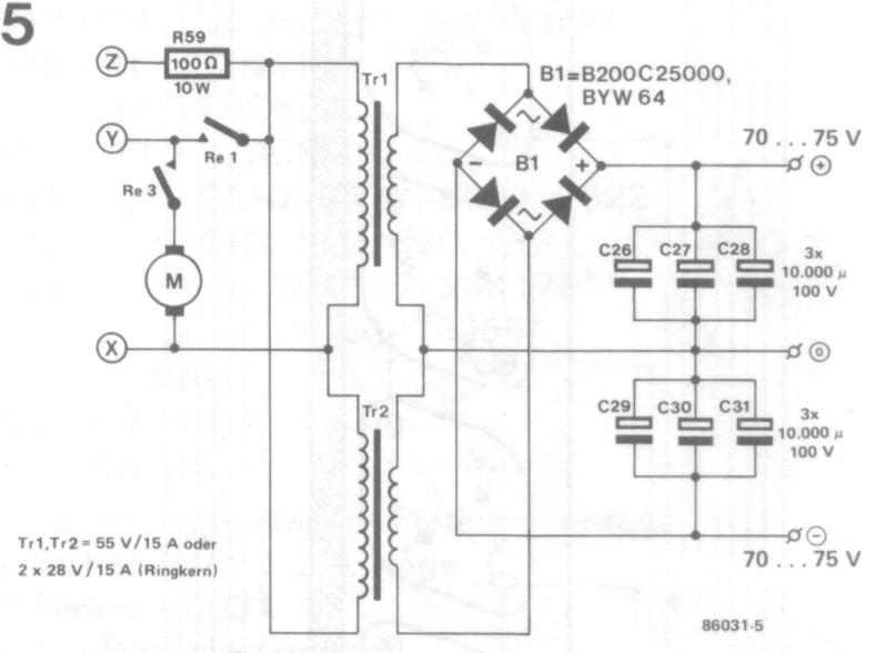

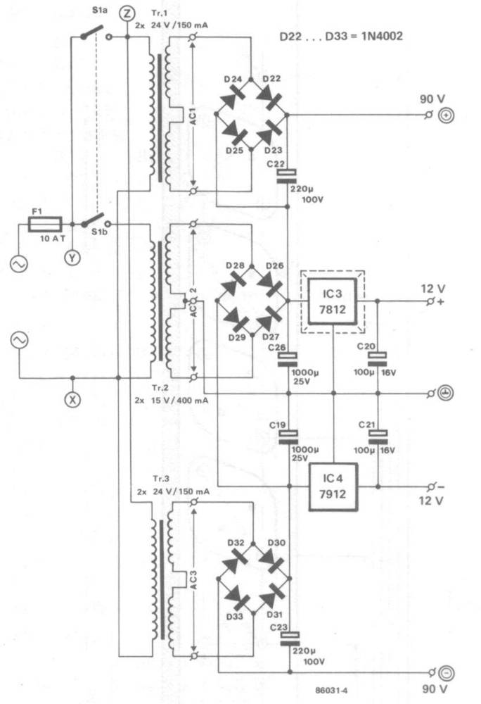

I have postet the schematic of the power supply.
The caps in there aren't very big.
So i have put in additional 100µ/100V on each side, and surprise it makes no different.

Post all schematics you have. I can't see for what the +/-12V is actually used. I would like to see as well how the 70...75V for the power stage is generated.
I would first measure if you can see this "jump" at the potentimeter P1 just to rule out that that it's not caused by the power amp stage.
