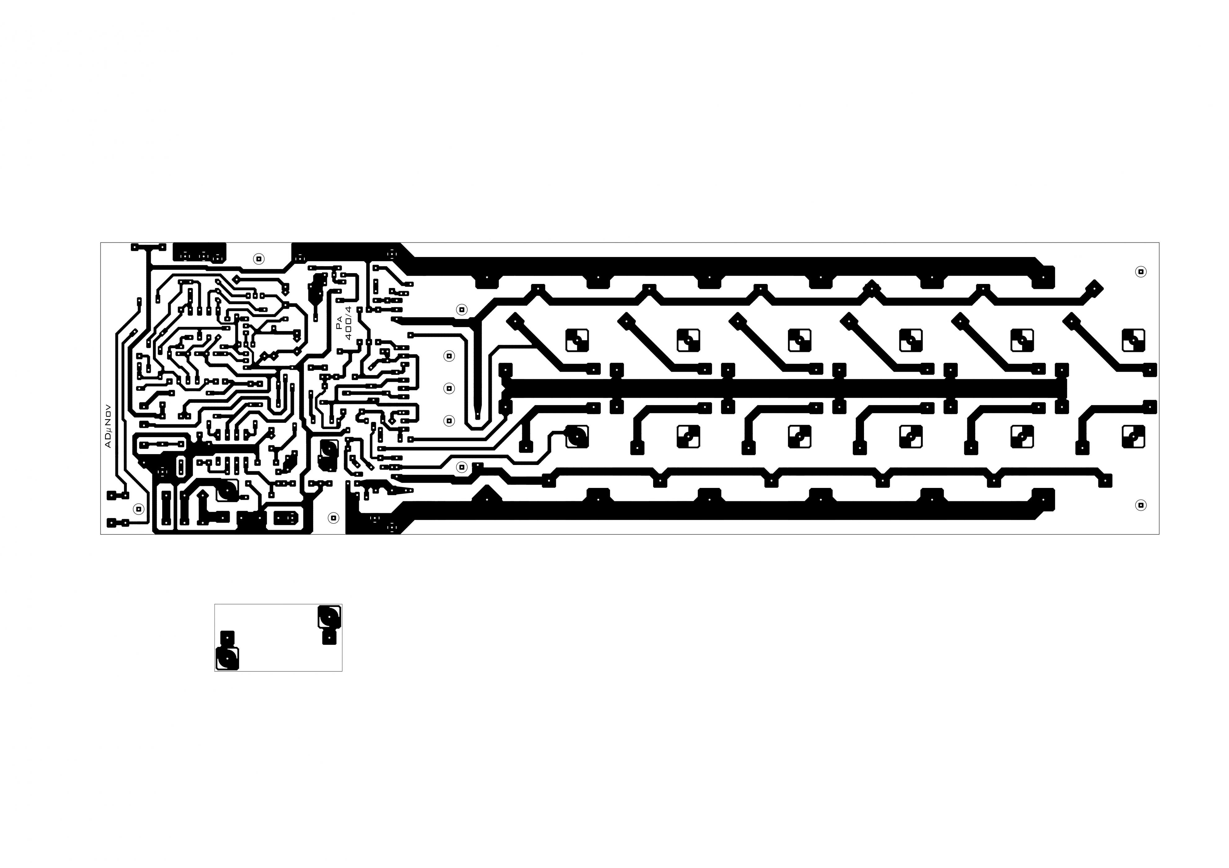

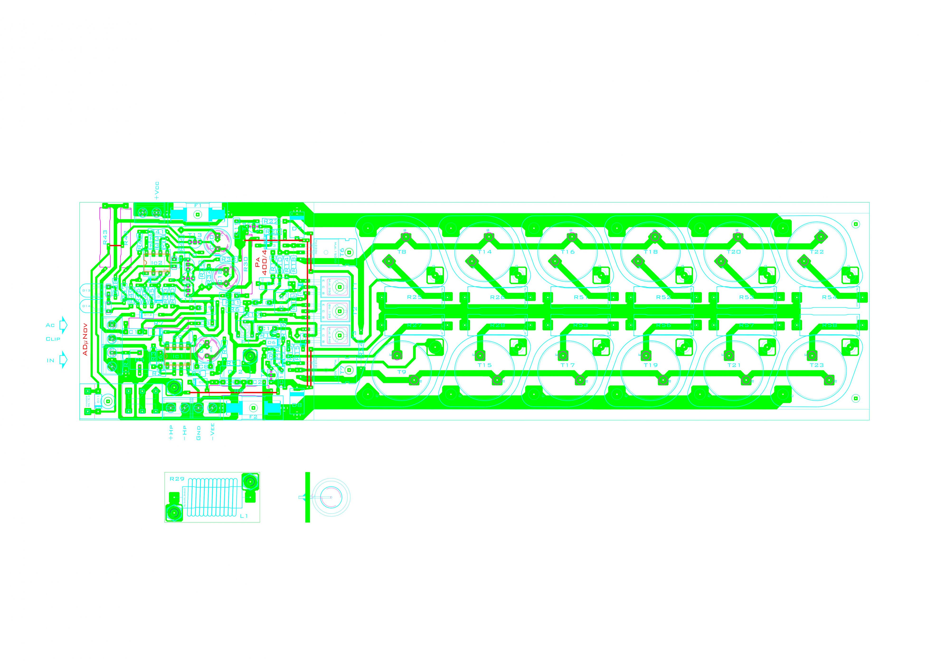

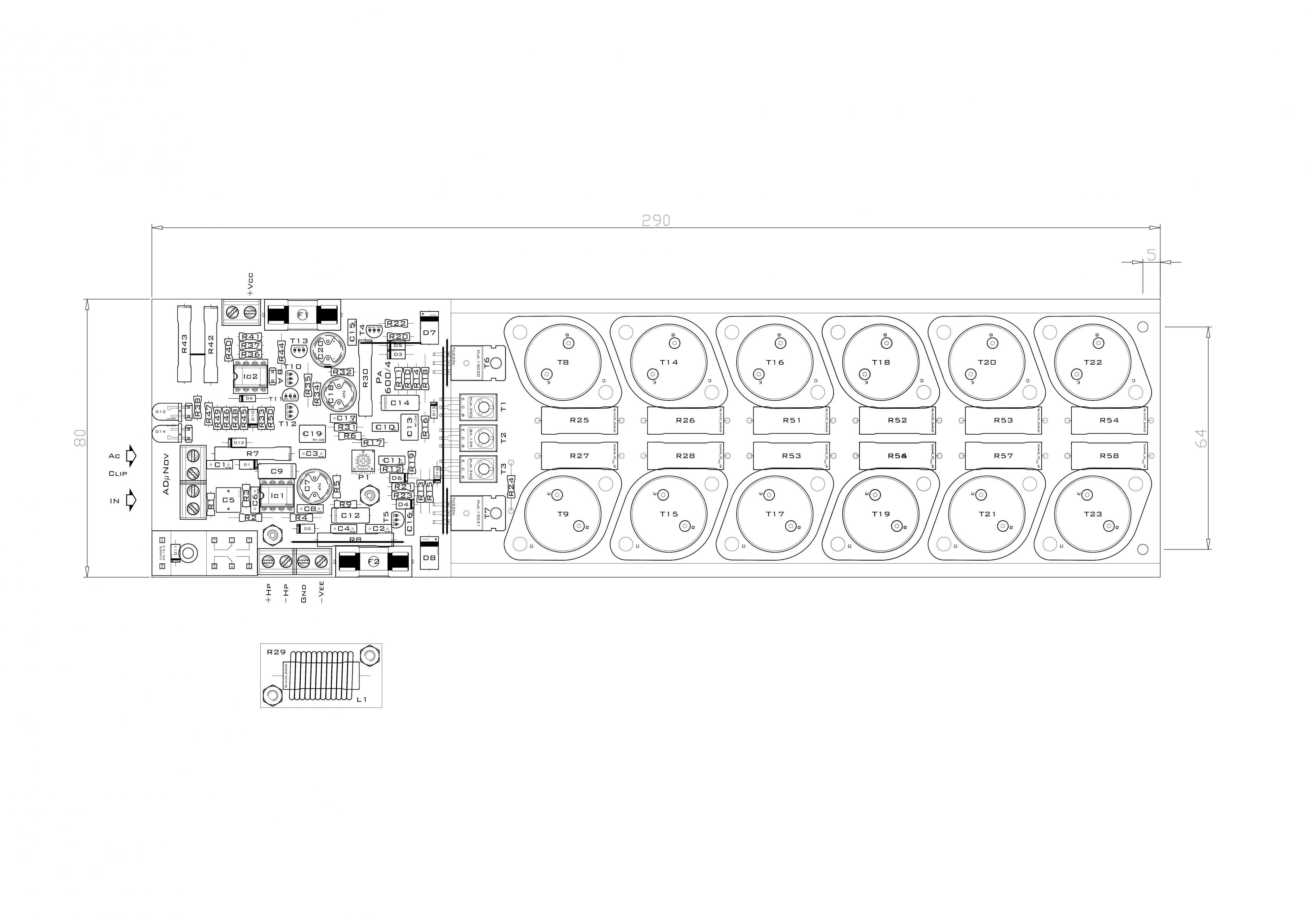

Hello, Kay.
Sorry, I was away. I'm not back home yet. Ok I would give the Pcb of 300,400,600. It is still in verification, because we have created a routing conforming to our case, visible on the attachments.
Best regards.

PA_300/400/600
Herewith Pa. 600
Greetings

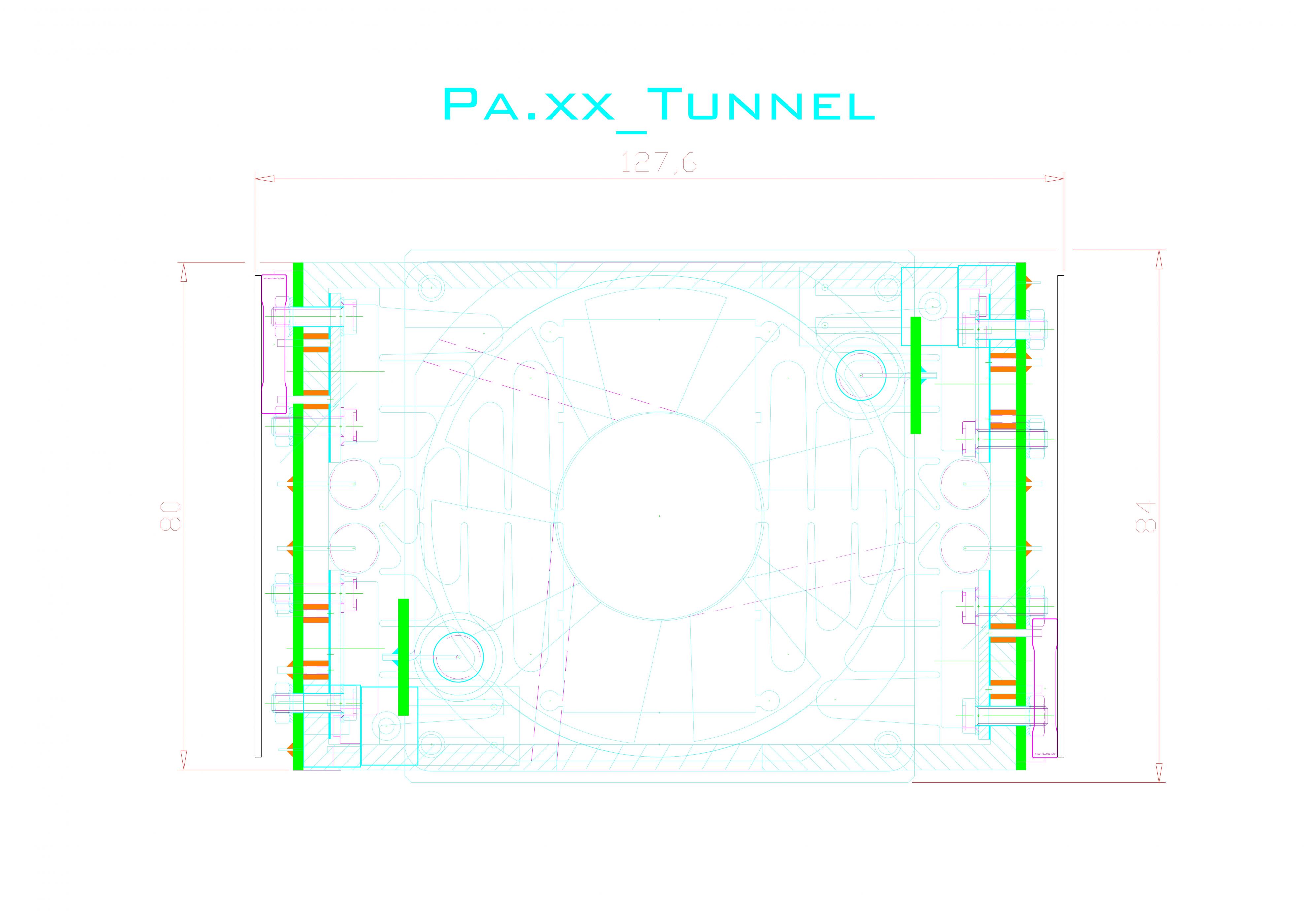

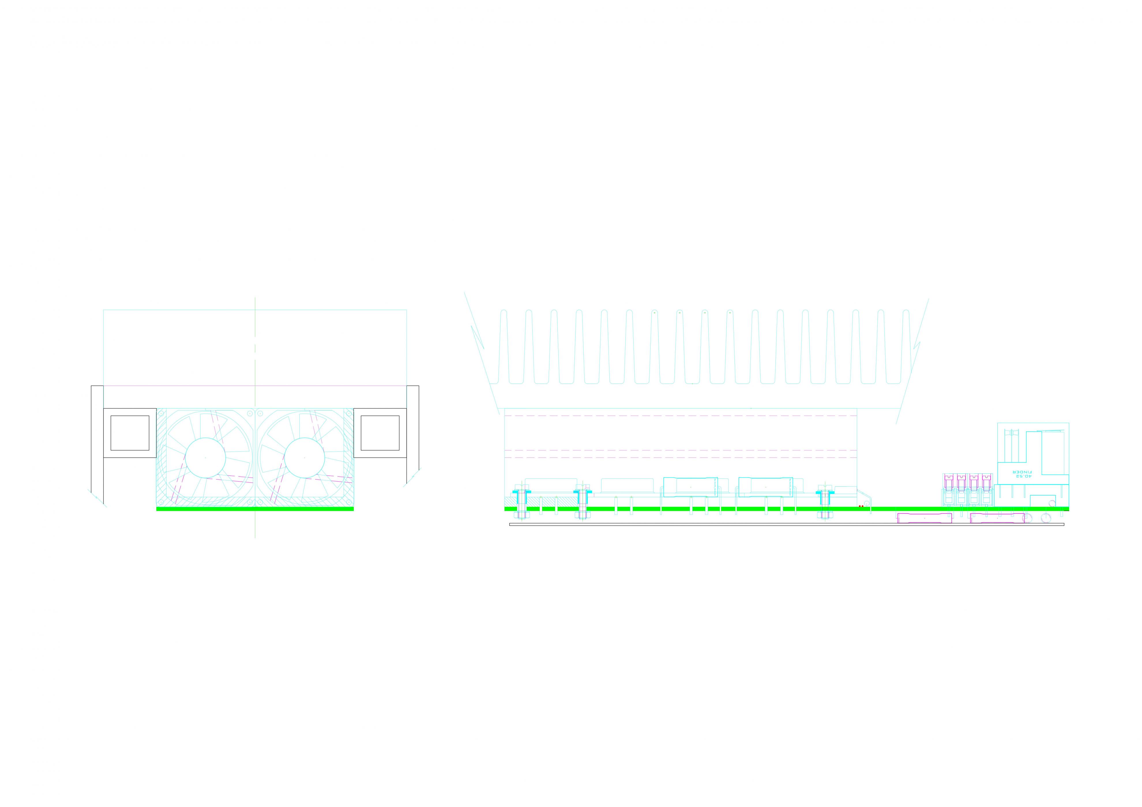

PA_300/400
Hi, Kay.
It should be understood that two L-shaped angles of 40x40_Ep = 5 mm is less expensive than a U of 80x40.
It is easier to machine the angle iron than the U. In addition, it is not too standardized, among manufacturers. But you can do it at a factory.
Then the, L must be connected to the main heatsink. Or do a tunnel assembly. 8 pairs at 100 volts this starts to make a nice heater. Then it is a question of feeling and of handyman ability. We are fine with the approach used on the top view of the amplifier that I have detailed. And if assembly in bridge then, it is obligatory tunnel. I hope to have answered.
Greetings.
Jacky

Joined 2018
Wont reused PC coolers for highpowered cpu be efficient? Just one for each output transistor. Mounted to alow vertical airflow.
Cheers!
Joined 2009
Don´t think transistor per transistor but the big overheated block you are trying to cool.
As in: 1 or 2 (depending on layout) large "tunnels" where you concentrate large airflow and lots of fins together.
A CPU is on its own, or maybe you have two in a PC case, not 8/12/16/whatever transistors all together side by side.
And total heat generated is more than anything a CPU can generate.
Joined 2011
Hi Jacky,
I'm not too sure that I get you right. Do you mean two L shaped brackets per board, which would mean two separate heatsinks, or two per side that are screwed together so that the board could be mounted in parallel with one single sink?
Best regards!
