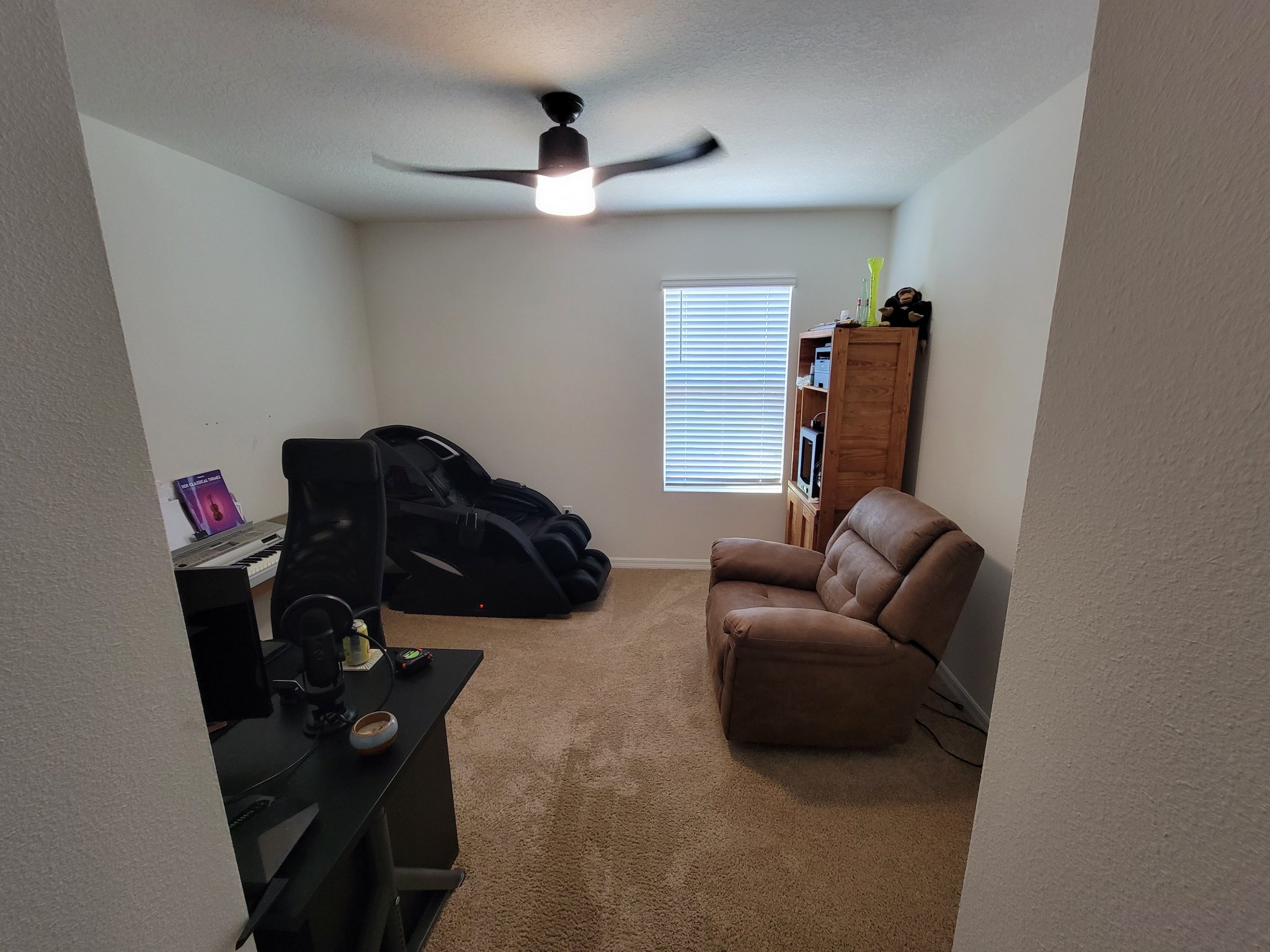

As I have begun my build, I would like to get my room ready for them.
The room in question is pretty maliable and I will be putting 4" pyramid foam on every inch of the wall (yes, every inch, bass traps in corner.) I have two questions.
1. Will the 3.5' square which leads to a door do much to the acoustics? I assume if it is awful I can put a curtain there.
2. Following the golden ratio, the speakers are only 5' apart. Should I sacrifice this a little and maybe go to a 1/5 ratio to allow for more separation?
3. I can also put the speakers on any of the other walls if it makes things better?

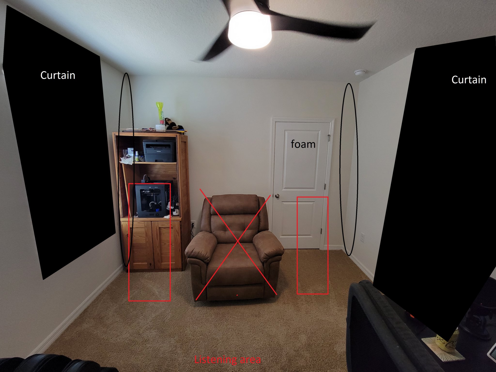

i think you should put the speakers along the hardest wall, with the highest density. also, any openings like the 3,5 feet square should be behind you. using that much acoustics foam as you write will make your room sound to dead, not a good thing when listening to music in my experience, but can work for other activities
Yep! Since posting this, I have revised my plan and will use far less foam. Behind speaker, in front, and first reflection point. Due to exactly that reason.i think you should put the speakers along the hardest wall, with the highest density. also, any openings like the 3,5 feet square should be behind you. using that much acoustics foam as you write will make your room sound to dead, not a good thing when listening to music in my experience, but can work for other activities
That is possible, may require a funky setup. Carpet yes. Windows I have large black out curtains for comingSeconded, speakers along the bottom wall. Best to be a near field setup.
Postpone the foam on the walls for now. Do you have carpet on the floor? You should.
Any windows? Use drapes.
Being close may require raising or tilting the speakers.
Post some photos.
I was planning on putting curtains over the 3x3 square, I think that should get rid of most issues with it.

Photos below
Near field can have the best imaging and detail.

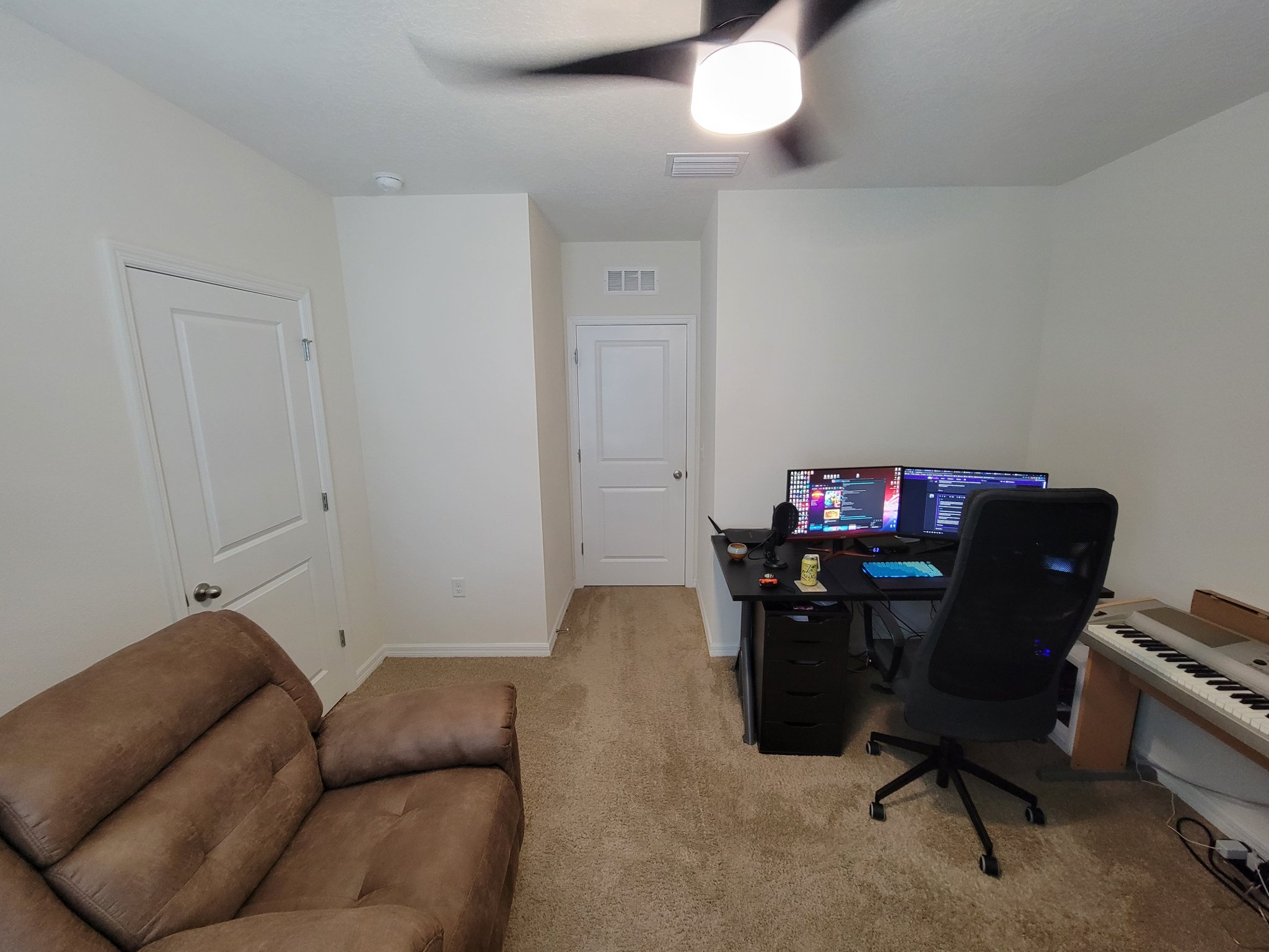

After seeing the photos, I would change my mind and place the speakers as in your post #1.
Place the chair near the rear wall, with a large curtain or wool rug hung behind the chair at ear level.
This is essential, do not omit it.
Set the speakers in an equilateral triangle with the chair, or move the speakers slightly farther apart,
with curtain or wool rug between the speakers. Wall-wall carpeting is needed here. There's only room for one chair.
I doubt you'll need the foam at all, if you place the absorption on the walls as described above.
Curtains over the entrance way will not likely help much if at all.

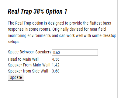

The dimensions I wrote in were golden ratio stuff, is there no issue having them closer to the back wall assuming the room is treated? I'd like to have them farther apart, and farther back, but that breaks from the ratio.Larger, multi driver speaker systems will need some distance for the drivers to integrate.
So push the chair back as far as possible, and keep the speakers as near to the front wall as tolerable.
Tilting the speakers inward and/or upward may help this, depending.
There is also this Which may work better?
Best in this case to find what works for you in that room. Speakers are not point sources,
and their physical dimensions are significant compared to the room dimensions.
Simple formulas will not work well here. Just use it as a starting point, if anything.
