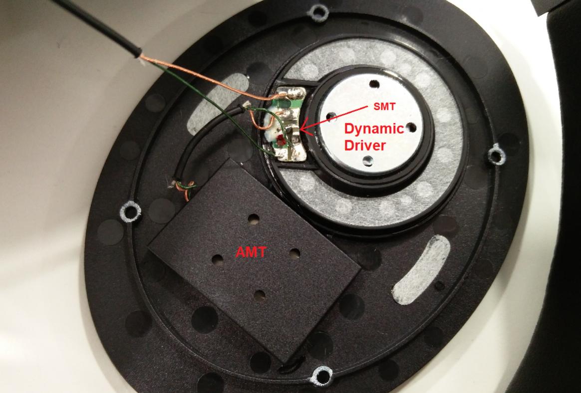

Here’s a sneak look at the insides from a Head-Fi post:
attachment.php
I see a single SMT cap as a high pass filter for the AMT and the dynamic driver runs full range.
This is quite interesting!
I think I have seen a few headphones that have done this, but as far as I can remember, they were not really good.
There are some benefits with multiple drivers, the main advantage of having reduced distortion thought the FR(in case of headphones it mainly in low the end, aka. bass region).
Average dynamic headphones today already have around 5%ish of THD(because the front is sealed and driver is so close to the ear, getting decent bass with fullrange driver is not a big problem) at 20Hz, a number that drastically gets better around at 50Hz etc.
But today most of the high end planar magnetic headphones, have very low THD at sub-bass by default.
I don't see many advantages of this approach and many potential headaches, but it might help with reducing cost of headphones in future which is something everybody can look forward too!

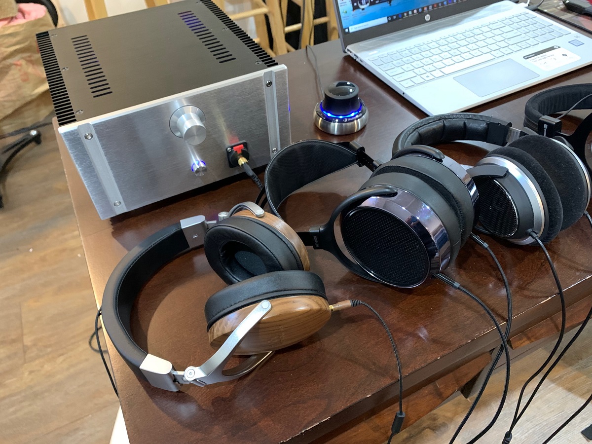

Test Setup with other cans and Silicon Harmony amp:

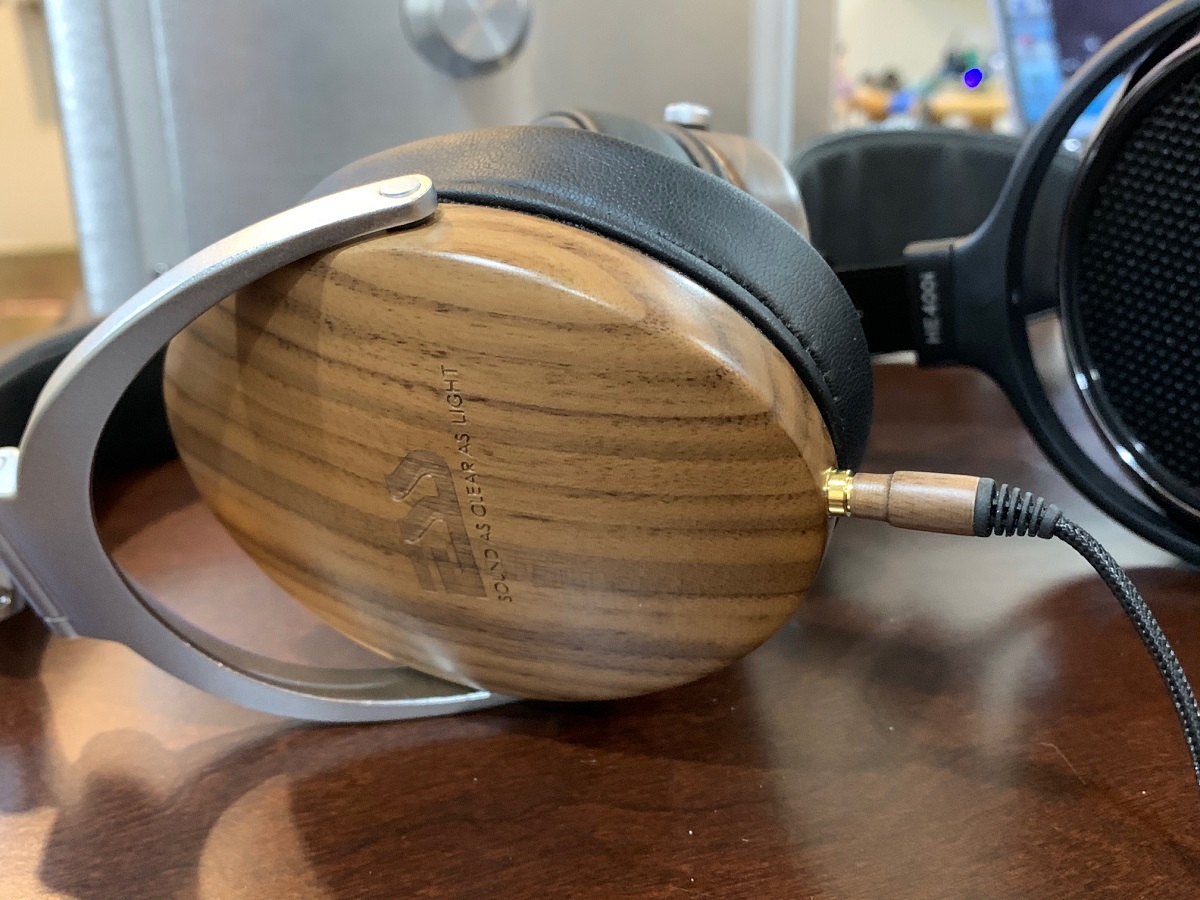

Closeup of solid walnut wooden earcups and detail of walnut 3.5mm plug and gold jack. The cord includes a microphone and 3.5mm TRRS plug (for use with phone or for telecons) and 1/4in TRS adapter. You could use your own 3.5mm male-male cable if you wanted to - no proprietary connectors here. The cord is very short - great for use with a phone or portable amp, but probably in the studio you could use a longer cord. Easy to do with any longer 3.5mm to 3.5mm male/male headphone cable.

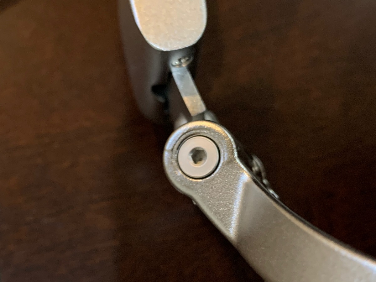

Here is a detail of the metalwork at the main hinge on the yoke, nice hex cap screws instead of usual Phillips screws, and metal has a satin texture. It feels like cast zinc - tougher and heavier than aluminum:

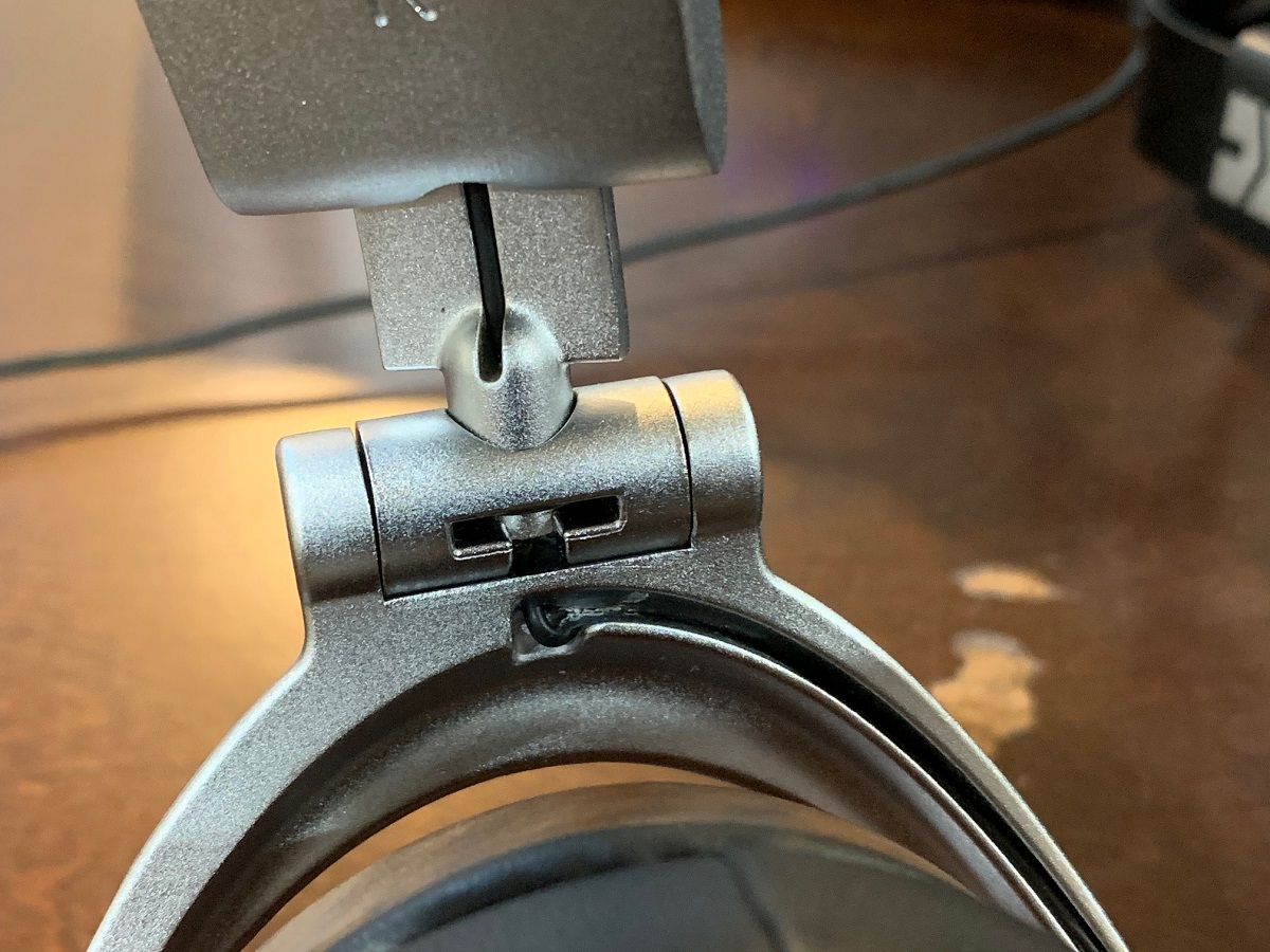

Here is detail of the backside of the yoke showing the channel for the wiring to pass through the headband, the telescopic springs, and the yoke. No external cables are visible except the main one that plugs into the left side from the amp:
