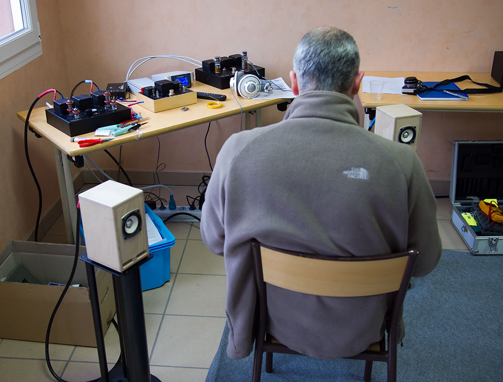

Does anyone that was there and heard these have any comments?

Hi Dave,
I just had to wait and see when somebody asked about the uFonkens.
That's me from the back on the photo and my 2nd build of the uFonkens.
I applied the eNabl process on the FF85k drivers.
I had arranged for a near-field listening setup, where the uFonkens do excel.
The uFonkens were hooked up to the following setup:
- Terratec Noxon audio player.
- connected via SPDIF to a Musical-Fidelity V-DAC with upgraded PSU.
- connected to a single ended E86C-E80L running in pentode mode (2.5W).
- playing lossless FLAC files
The complete setup does not exceed 500Eur in cost and is highly musical.
Just out of curiosity i swapped in a Benchmark DAC (2.5x the cost of my whole setup) brought by an ETF participant and could clearly notice the upgrade in sonics.
First nobody looked at them until they made music...
The feedbacks were all highly positive such as:
- exceptionally 3D
- huge sound stage
- stunning
- they excel in voices and instruments
- this is more than a computer speaker
- where's the subwoofer ?
Even the musicians performing the musical event on friday evening were
astonished by the sound stage and the timbre of voices and instruments.
I think getting such feedbacks from guys equipped with large Altec Horns
and 300b amps is quite an archivement.
