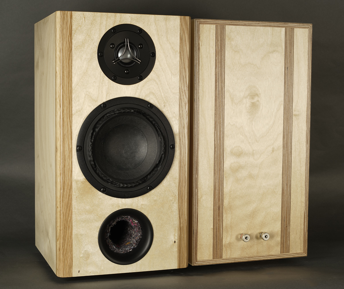

DIYA user @spresto9 has come up with these beauties with the 8" purifi woofer like to details and more pics HERE

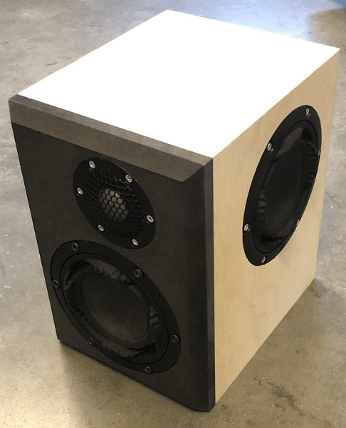

Check out this 4" pocket rocket proof of concept build from the Purifi team - all the info you need to DIY!
Spk8 appnote download (.pdf)
@lrisbo Proof of concept Purifi SPK4 (superseded) - Passive stand-mount

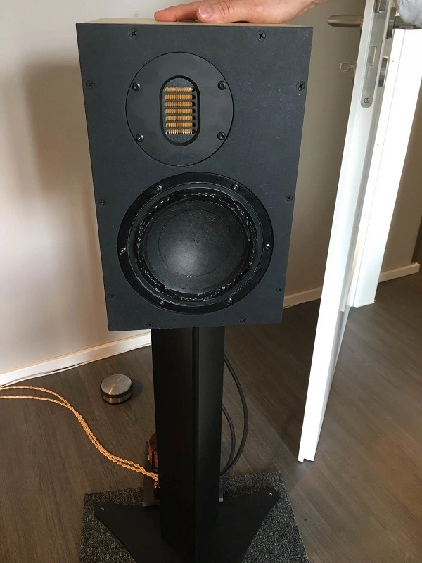

@lrisbo Proof of concept Purifi SPK5 - Passive stand-mount - I believe these were at some point being made and sold commercially but have since been discontinued - there may be some floating around second hand market see here Celuaris SPK5 review ASR

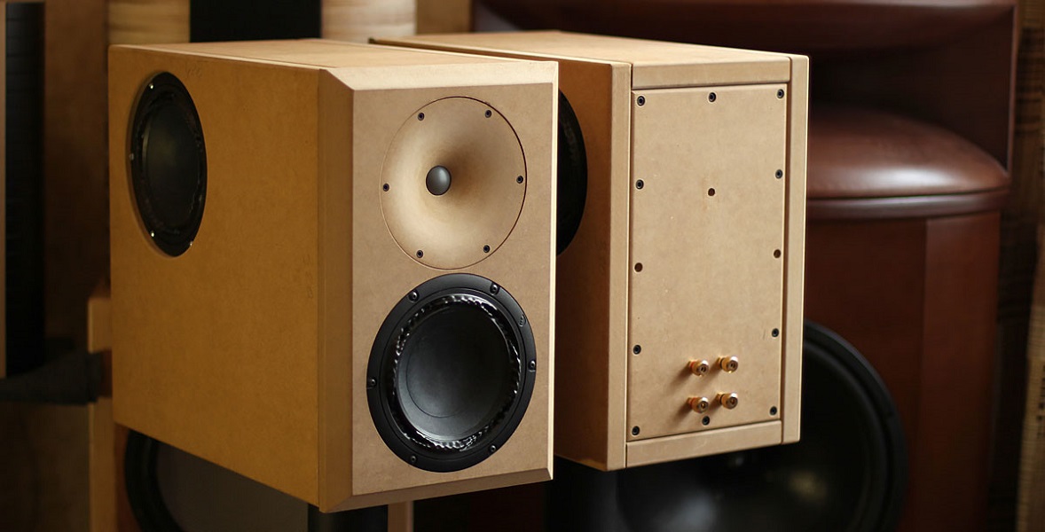

@xrk971 PTT6.5/RS28F Waveguide Harsch XO - Passive stand-mount later evolved into a nice Stand mount and Floor standing Transmission Line

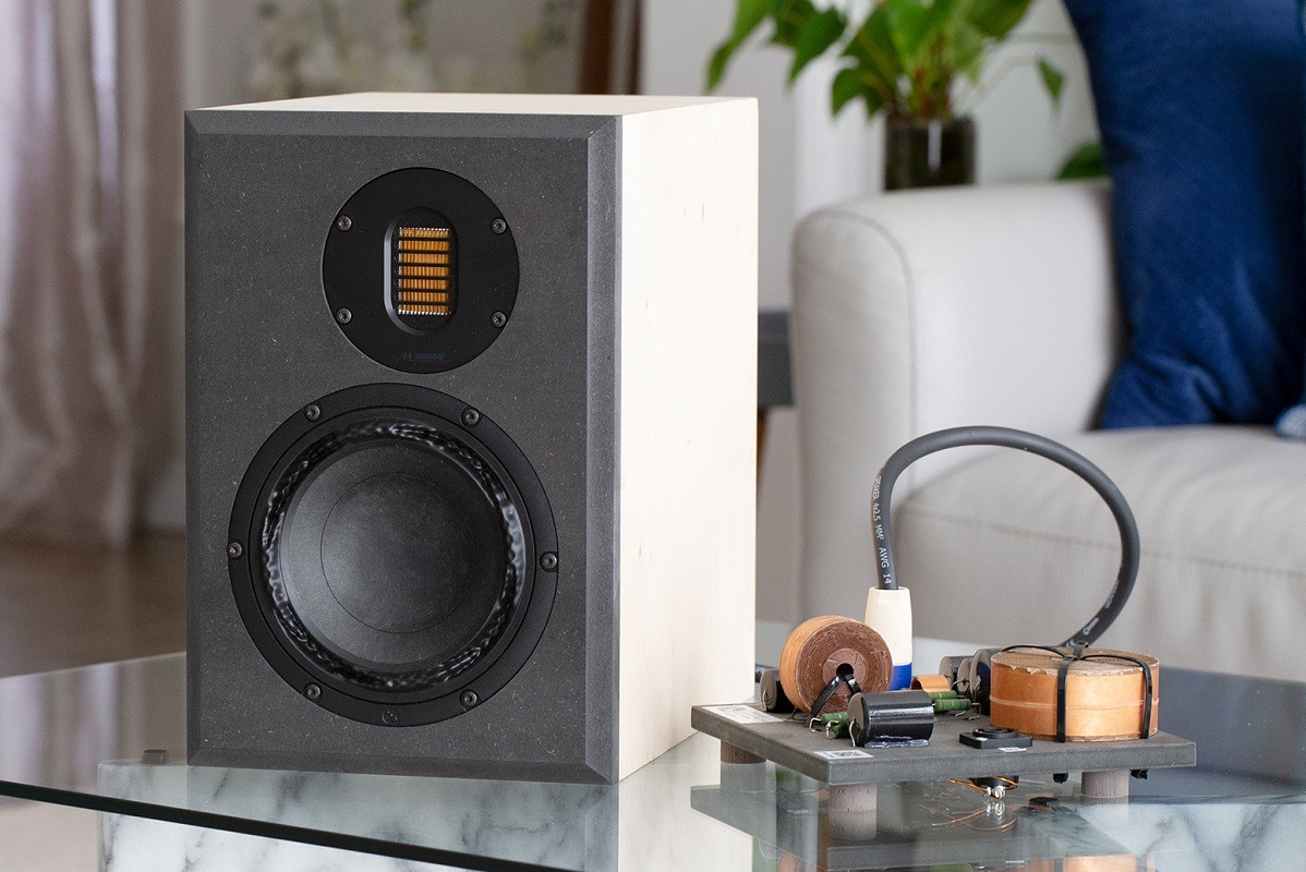

Rick Sykora and team's Directiva - Active stand-mount with excellent (objective) reviews, requires external amplification for each driver and an external DSP crossover.

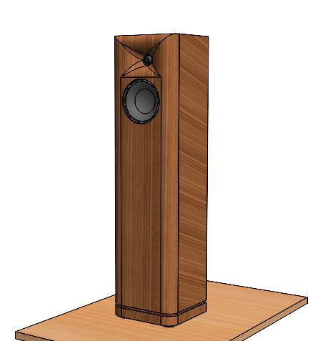

Some mindfood for the 8" - a concept by Purifi.
1670006638175-jpeg.1115978

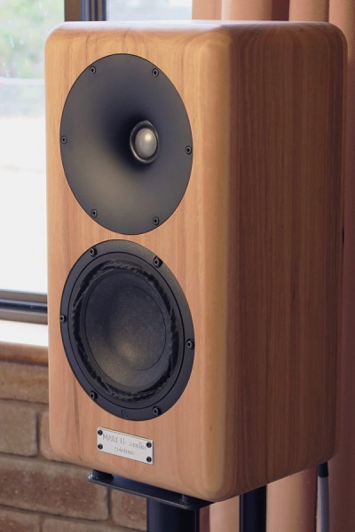

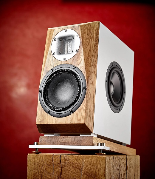

March Audio Sointuva - arguably where "the bar has been set" for the Purifi 6.5 in a bookshelf chassis.

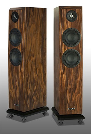

Salk Sound BePure3 ... Holy **** I need to hear these.

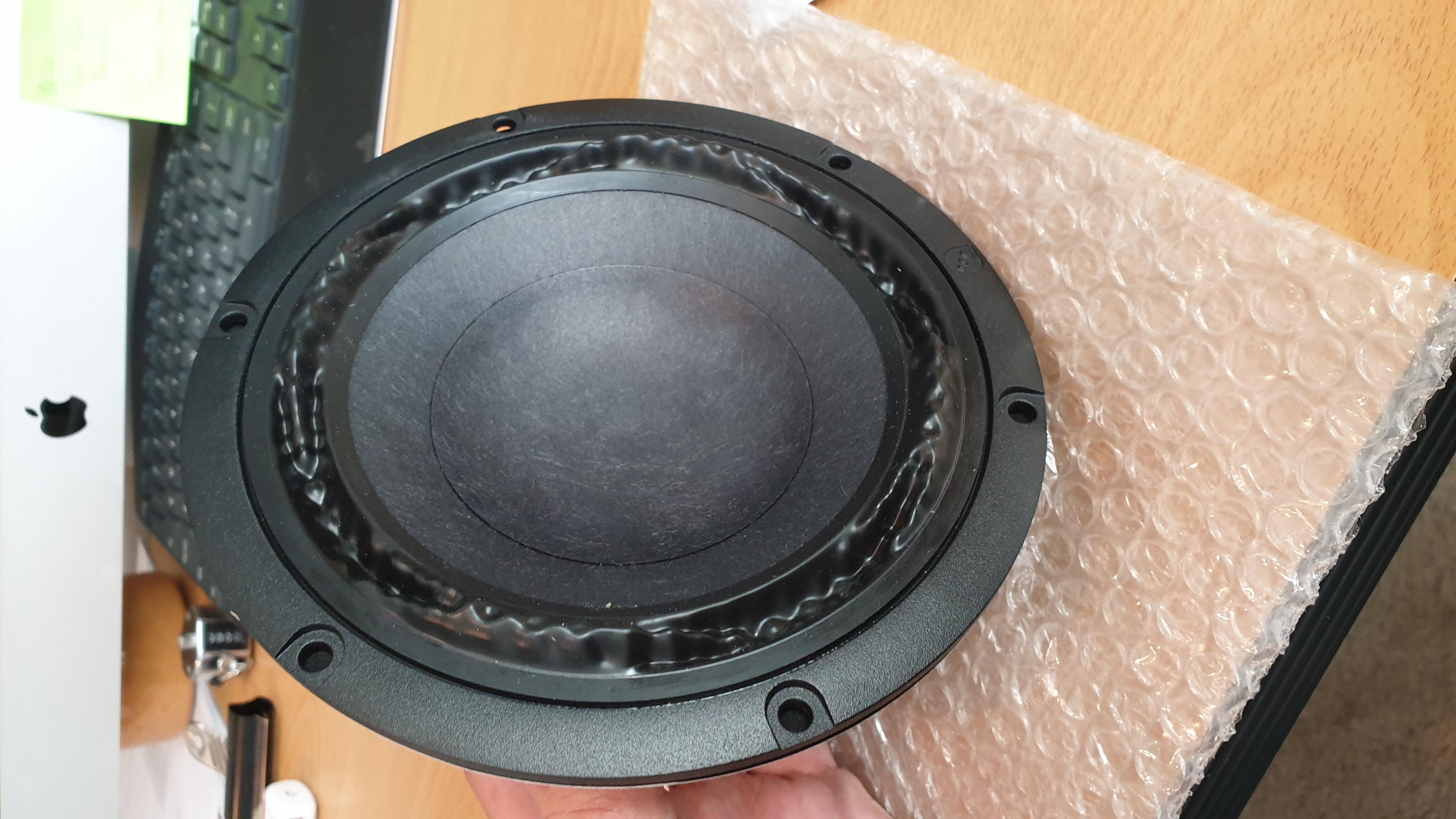

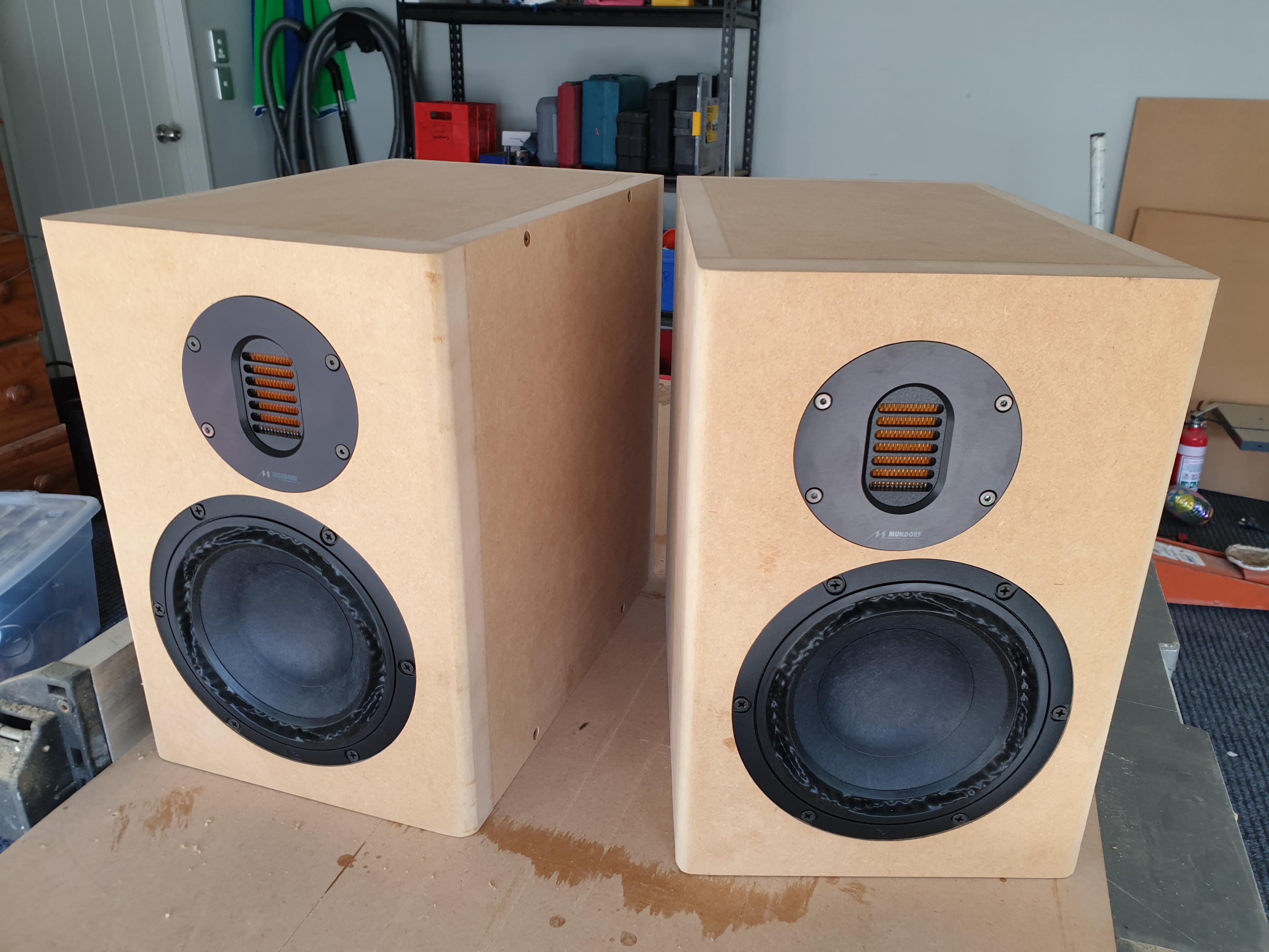

With the group buys well underway the idea was bought up that a design thread be started to discuss build options.
Mine have arrived but I have no build materials and will not be able to get any until we come out of quarantine in (hopefully) three weeks time. I planned to start with a hybrid of purifi's SPK4/5 builds using the same AMT tweeter but maybe using a slot port with the 2.5khz crossover. That and I haven't done any AMT builds so it seemed like a good place to start.
I read of a guy in Aus planning on doing a line of passive and active speakers with the woofer so be interesting if he could chime in here.
So with no materials for the next at least 3 weeks, what better time to discuss build options! Fire away

I'm going to be using them with the CSS SDX12 (sub)woofer and an as yet to be decided tweeter. Tweeter contenders include the Aurum Cantus AST2560, the Bliesma T25A, the ESS Heil and the Transducer Labs N26MGR-A (which I already own).
I may go dipole on the Purifi and AST2560 or Heil if I go that route.
Hey fella. I'm in Kapiti. Whereabouts in NZ are you? I'm annoyed I missed out on a group buy. I would have definitely been keen.
I've not done any ribbon builds, but I don't know if I'd pick the AMT for this woofer.
The AMT has a lot of 3rd order HD:
Mundorf AMT21CM2.1-C | HiFiCompass
And will strain / be audible as the woofer can take it. Compare similar voltage levels and watch the AMT HD climb.
Also beaming of the Purifi at a 3.2KHz XO point of the SPK5 design will give some lumpy off axis behaviour.
The AMTs are very expensive for what they offer. In a 3 way, allowing a higher XO point from a dome mid would be a goer. But I would not combine with the Purifi in a pure 2 way.
Shipping to NZ would be a killer too (unless you already have the AMTs). Instead I'd recommend the following tweeter. You can get these from theloudspeakerkit.com and much cheaper. Check out the distortion profile. Has similar offaxis performance to the AMT too:
SB Acoustics SB26ADC-C000-4 | HiFiCompass
You could cross the above LR4 at 2Khz and address the beaming issue AND get lower distortion than the AMT.
The purifi provides a maximally flat vented alignment in a 15.5L box tuned to 35.1Hz (assuming average losses) with an F3= 38Hz. This is pretty good. If you can go active, this woofer could really shine in a 3 way with a 100Hz XO to a side mounted 12. Candidates that dig deep if you like sealed bass are the 12" SB34NRX75-6 (not the L version) or Dayton 15" RSS390HF. Both give a sealed box Qtc=0.71 in 122 litres with F3 ~ 32-33Hz.
Although an extra 6 Hz F3 over a vented Purifi might not sound like much, you really leverage the Purifi's midrange strengths and offload bass duty.

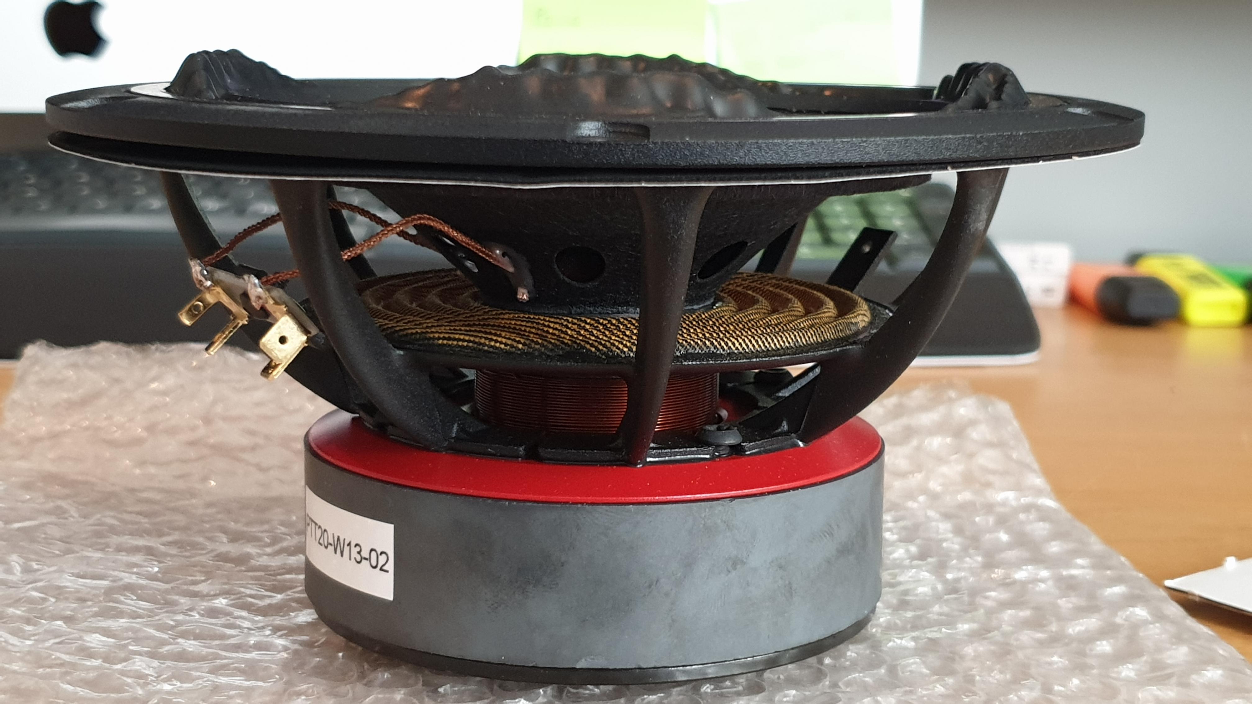

Holy.

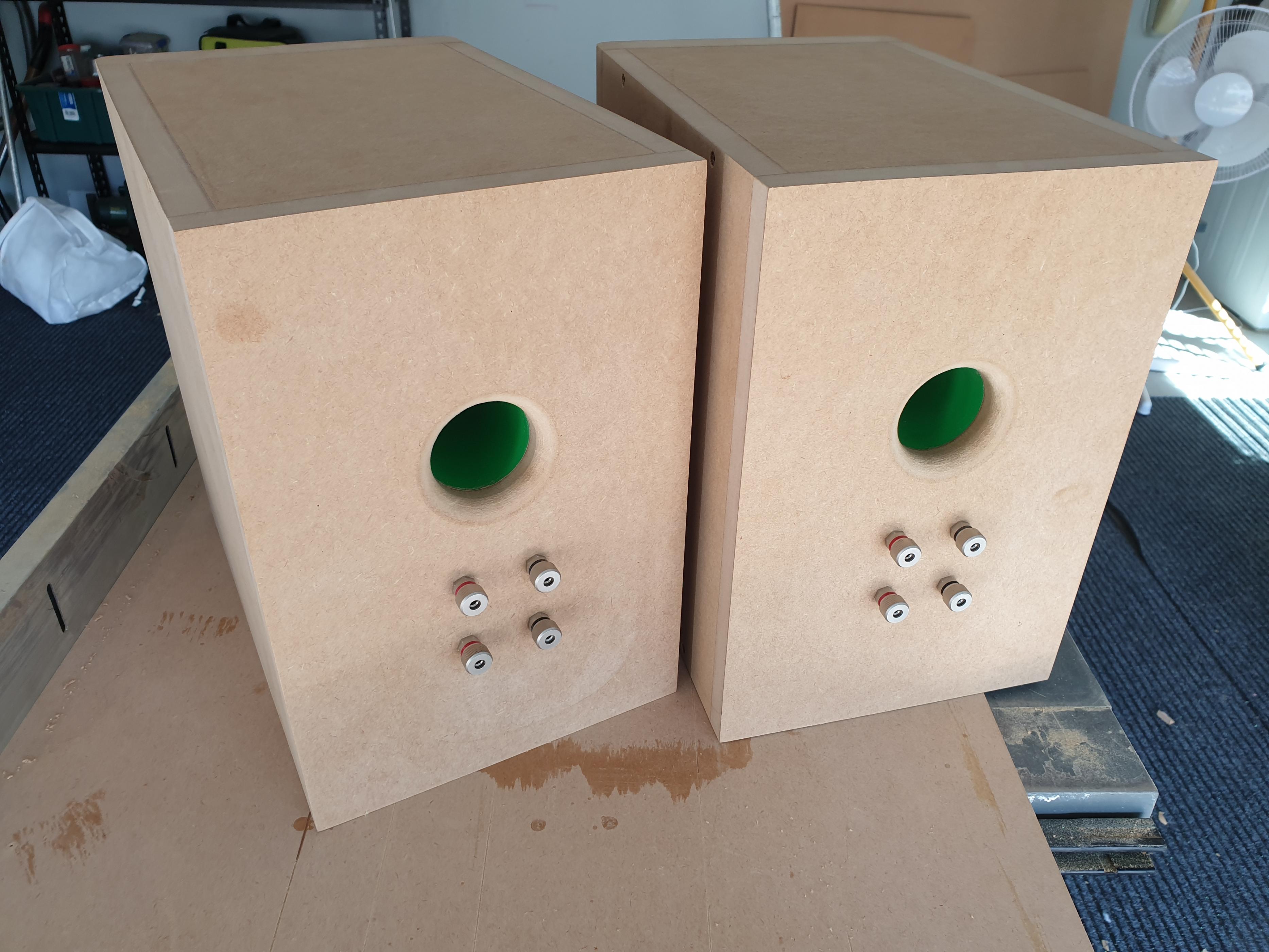

Whipped up some quick test cabinets as attached. The bass these things put out is quite simply jaw dropping. Best two way (bookshelf) I have heard. No question. The song backseat freestyle by Kendrick Lamar will bring most bookshelf speakers to their knees. Not here. I know people don’t like the word game changer around here but this is a game changer IMO. It’s early days, and I am using digital crossovers so a lot of tweaking to do, but so far it is really really good. I can’t stop shaking my head in disbelief of how loud, clean and clear these woofers are.
(Yes those ports are green, you use what you can gets in a lockdown and this time it’s communications cable duct from the top of my work Ute)

Attachments no workie...
