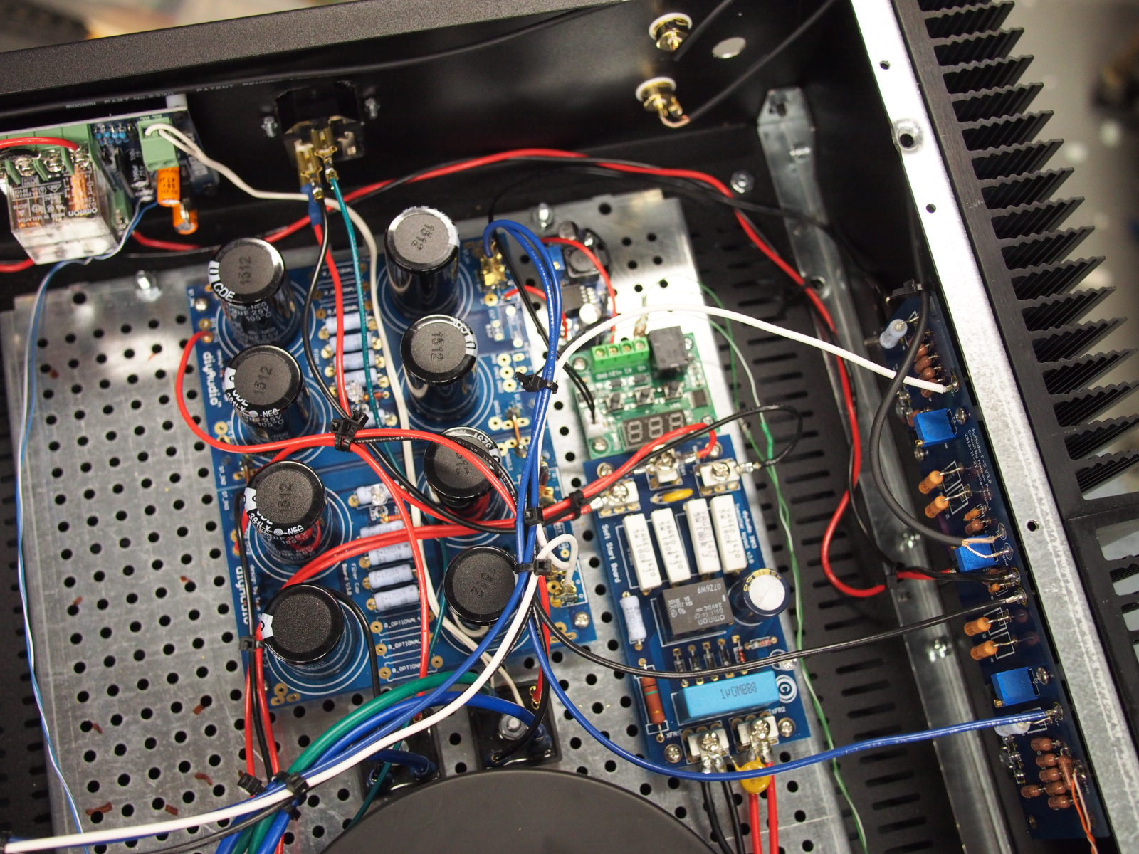

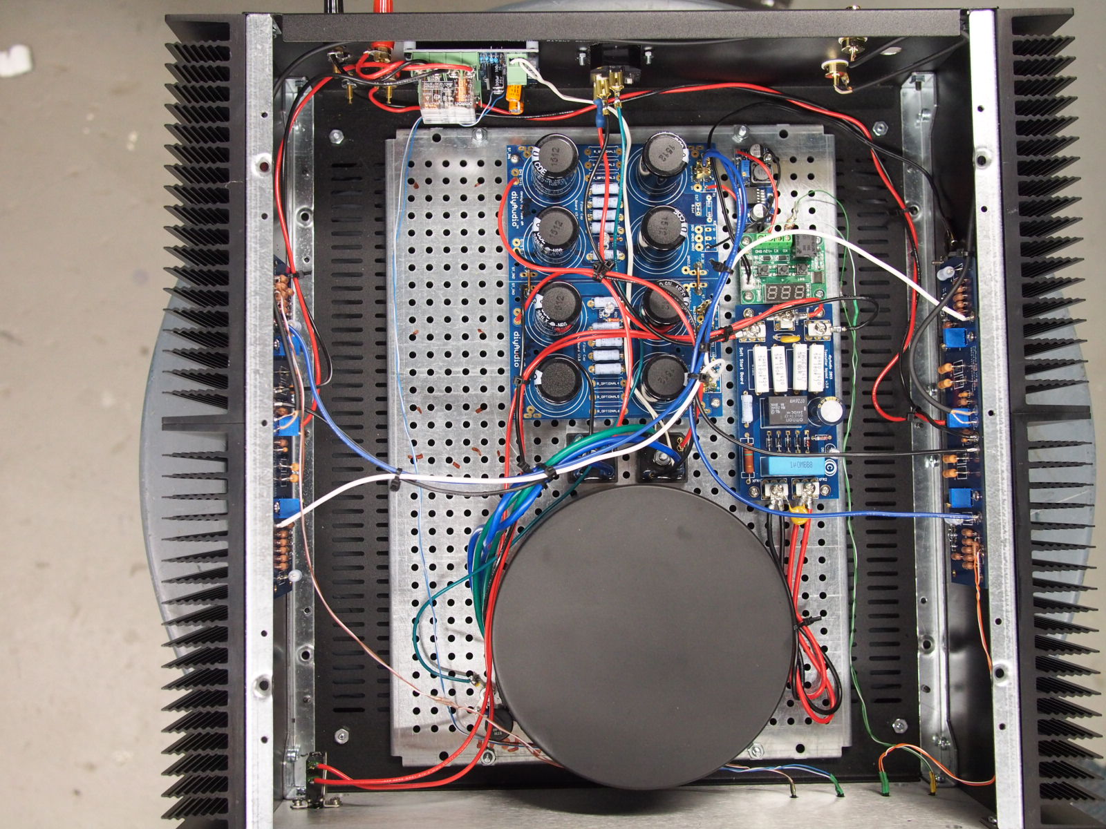

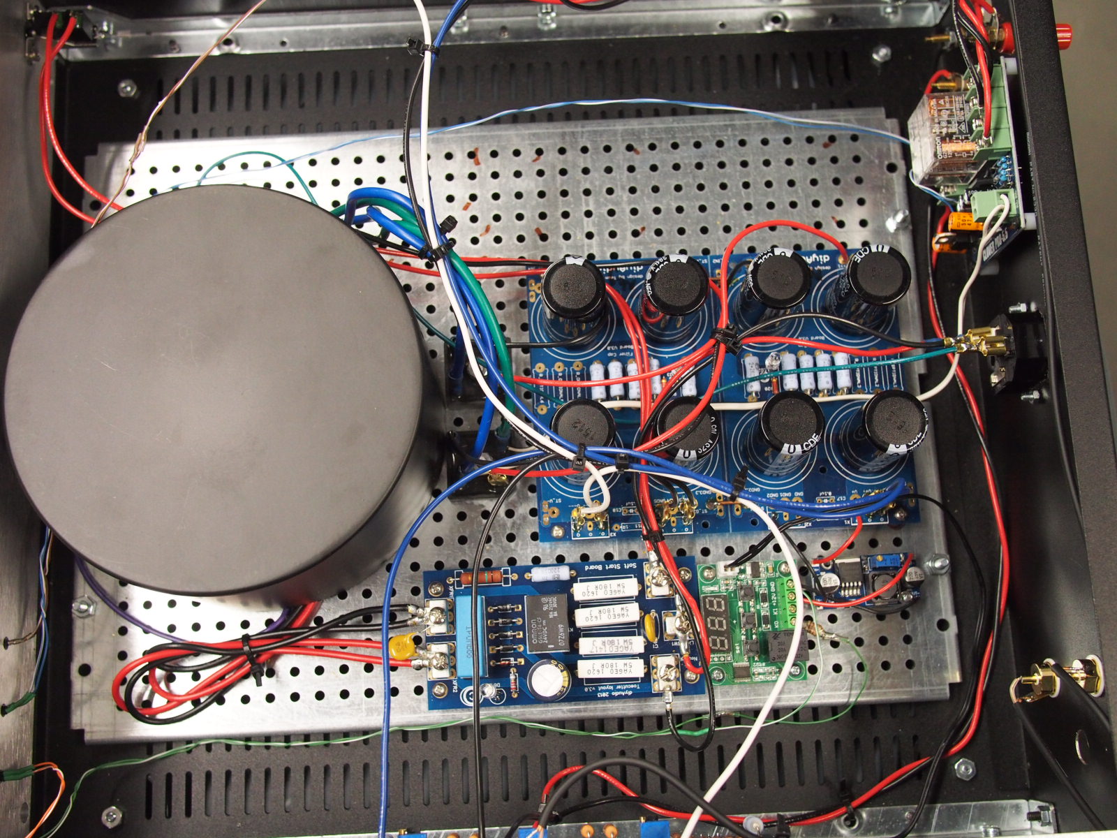

Slight humm from my new F-5
Greetings, I have just finished building my F-5. The Build Guide from 6L6 was very helpful. I have it biased correctly and it sounds very nice.
I have a couple questions. I am getting a slight hum even with the volume all the way down or with the preamp disconnected. I tried to follow best practices for internal wiring: cross psu wires and input/output at 90 degrees; keep input and output wires separated, etc. I think I followed the revised grounding scheme from the thread. But obviously I've missed something. It would be great to have a couple suggestions of what to look for.
Also I wondered if there are any particular guidelines for a preamp? I am building a B1 but in the interim I am using a McIntosh C36. I wonder if this is contributing to the problem?
Attached are a couple photos. I appreciate any assistance you can provide.

Just finished my F5 and experience a minor hum on the speakers when listening closely.
I guess it’s power supply ripple residue on the outputs. My power supply looks pretty identical to yours. 400VA transformer, CRC with 4 times 15000uF and 0.47R per rail.
Anyone else have this?
