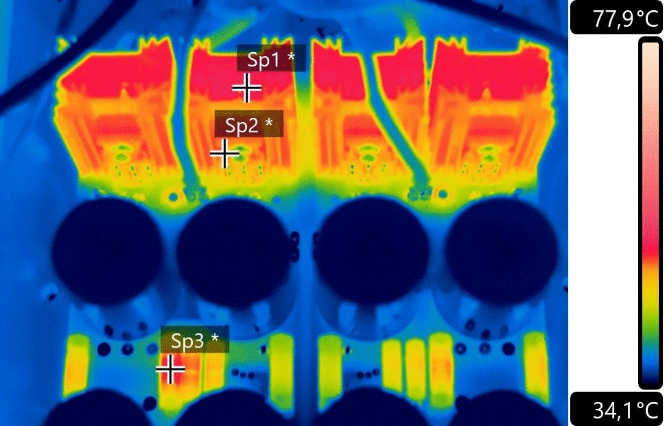

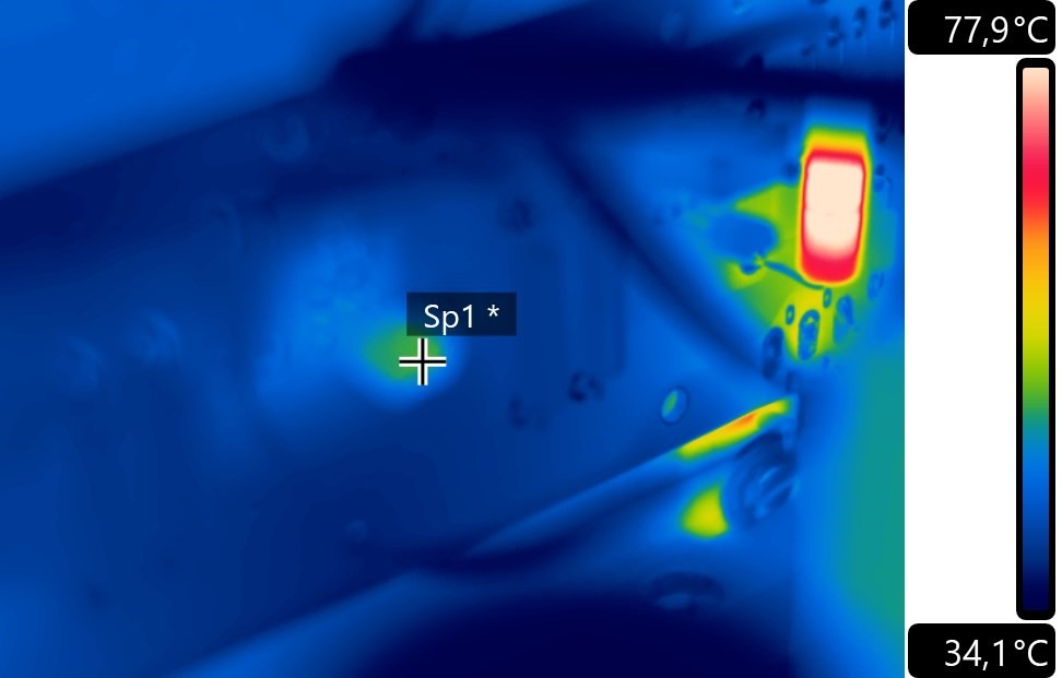

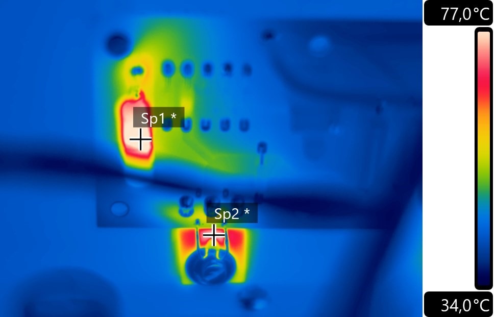

Finally i got my F5 quiet and running like it should - YEYY....
Had the oportunity to take few shots of the amplifier with thermography camera - thought you might be interested to see....
Amplifier PCB is from diyaudio store and psu as well....
  • power supply diodes are FEP30 with heatsinks - diodes are running at 52 Celsius
  • resistors in output pair (0.47R) are 5W running at 83 degrees Celsius
  • Big heatsink is at 43 degrees
  • input pair (jfet) are at 53 degrees
  • output pair are at 78 degrees (IS THIS SAFE ENOUGH - long term?)
this all was taken after an hour of working - bias current is 1,25A per channel.
First picture is power supply board.
Second picture is one side of the amplifier board with 0R47 and one of the output mosfets
Third picture is input pair in the middle.....

78 to 43 is a pretty big delta - how long was the amplifier running for when you took the picture?
I see no more than 15C with ordinary measures, and better than 10C when using thinned mica, good computer grease and a copper heatspreader.
78C Tcase = ~108C die temp, this is not unsafe, but better to aim lower.
3mm is a pretty thick pad regardless of material, that's where the thermal bottleneck is. Temps should come down by at least 10C if you use better insulators. Heatsink temperature will go up, which is good. Better the sinks get hot than the devices.
i agree on that - i was specifically trying to see what to use best not to get into this problem and from what i understand is that ceramic pads are the best to use... from what i saw, 3mm or thinner was not to much of a difference... should be fine either way....
that is why i used these....
what bothers me is that i can hold my finger on those transistors for as long as you want me to hold it...
under the nut the temperature is not that big - it is closer to 58 degrees - only where the chip is inside, you can see that temperature... so maybe the gousing is thin there and it shows the temperature of the chip actually on the case of the mosfet... which would be reasonable to say i think.... the temperature of the metal part of the transistor is lower for sure i think..
seems to me that i am right here (upon checking those pictures again)....
what i read on the side of the transistor case where the screw is is a case temperature which is 58
what i read at the bottom of the case of the transistor where the legs are is actually the temperature of the chip inside transfered through the plastic of the case... that sounds about right also because i can hold my finger as long as you want on the screw side of the transistor.... can't get towards that part where the chip is inside because of the ntc that is ower there....
so, i think that the chip would not be on 78 degrees but lets say on 90 degrees or so inside...
which should be o.k. imho.....
correct me if i am wrong....
3mm insulators must never be used for a class a design like this. At least not if run fully biased. My reference is Zen Mod. Though Sangram is probably saying just the same, but more politely than my Viking directness.
Kheratherm is perfect and just as unmessy as pads.
But, changing now will mean desoldering the mosfets and is perhaps not worth it if the amp runs fine.
@ 78 degrees, if correct, the die will perhaps run too hot in the long term, if I remember correctly. Forgot the math for that, and don’t have time to check. Anyways, amps using thick silicone pads have broken down and been debugged in this forum before. Just a fair warning. You need to get more of the heat out of the mosfets and into the sink. Those pads hinder that.
That said, I am NOT an expert. This is just my opinion, based on what other have said before and some math I did myself a good while back. Note also that the Kheratherms are a bit fragile. You need to ensure the mosfets are fastened evenely to the sink and also torqued before any soldering is done. Otherwise you risk breaking them and making contact between fet and sink.
Reactions: sparkle
i am not using thick silicone pads but ceramic pads...
on internet the claim that ceramic pads can handle 20-28W/mK and Keratherm 2.5-3.5W/mK.... what i understand, ceramic looks way better....
also, as said - seems to me that the case of the transistor is lower in temperature and that what i see here is actually the part where chip is transmitting through the plastic - explained it above better (not to repeat 🙂)
