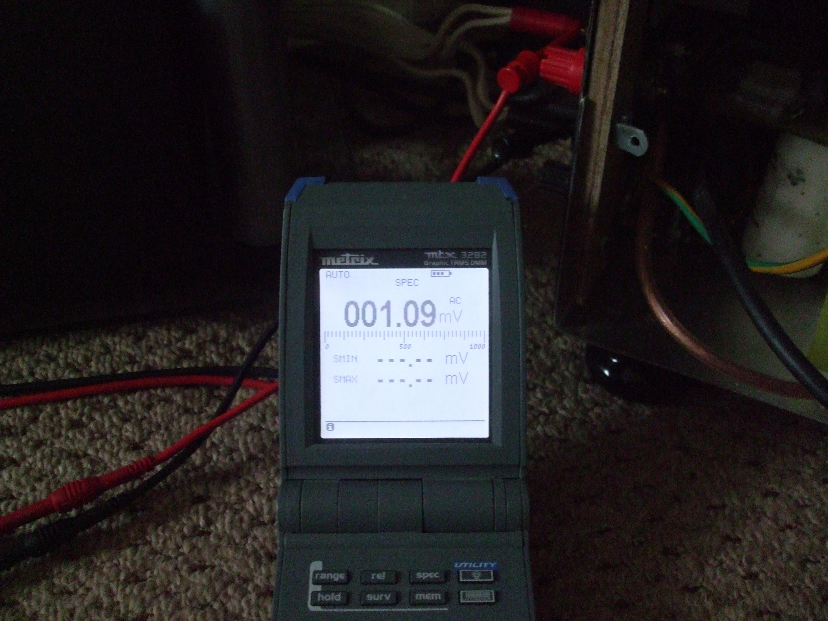

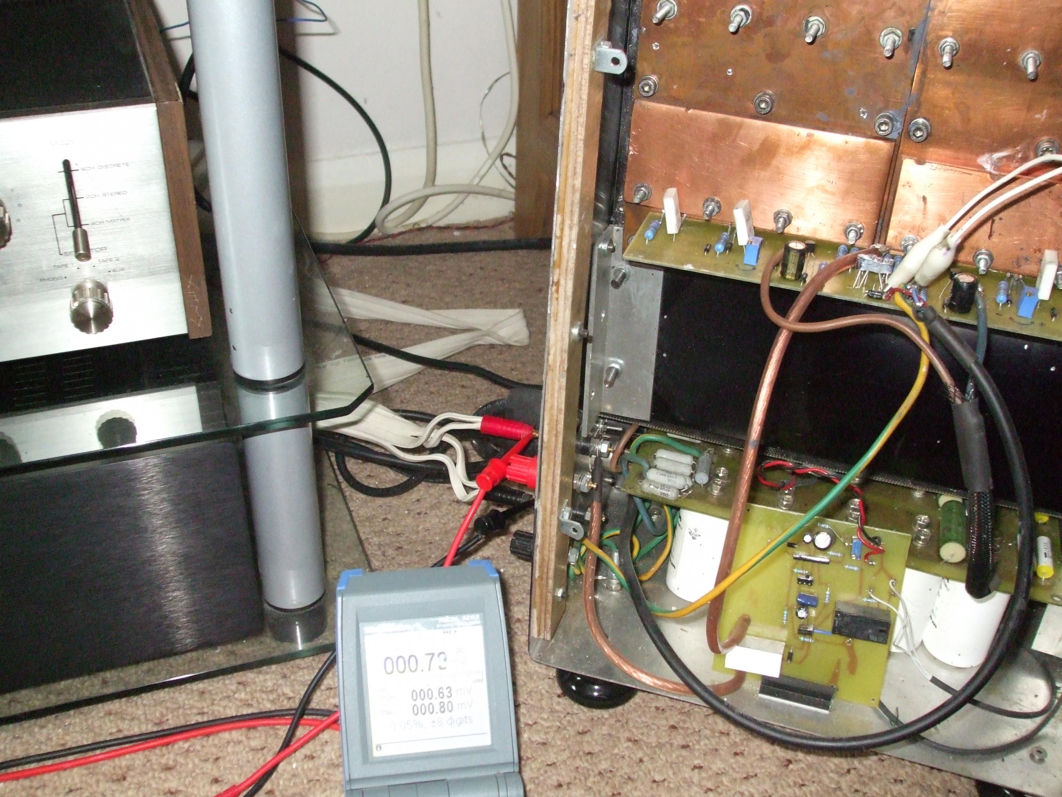

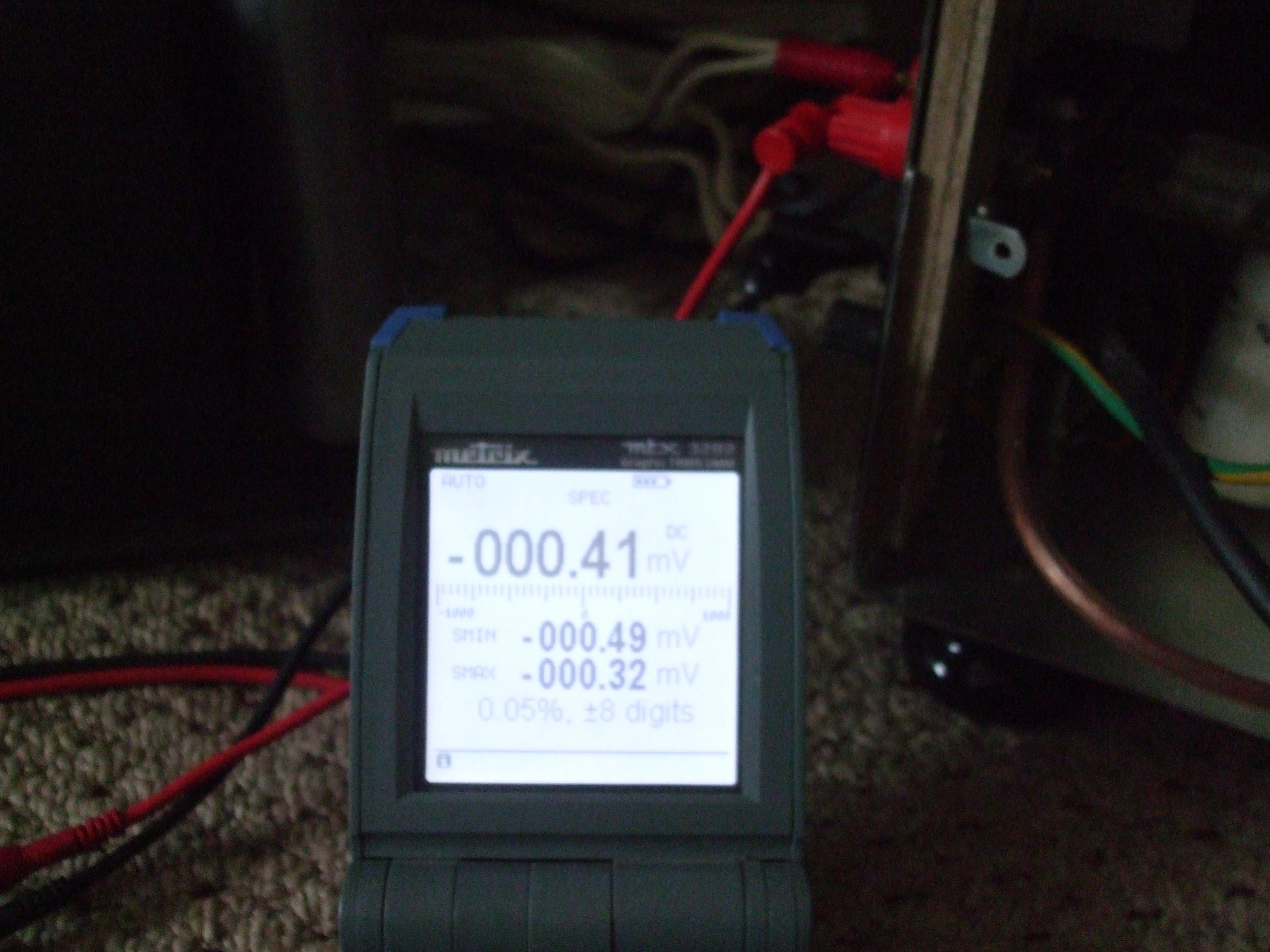

Now for the Mechanical side of things ...
First one AC V
2 and 3 DC offset I have seen beter than that once is warm
No cheating (I newer do) meter give min and max V and if you look range is same for pictures taken same time apart.
This is what you get with 150mU on CRCLC

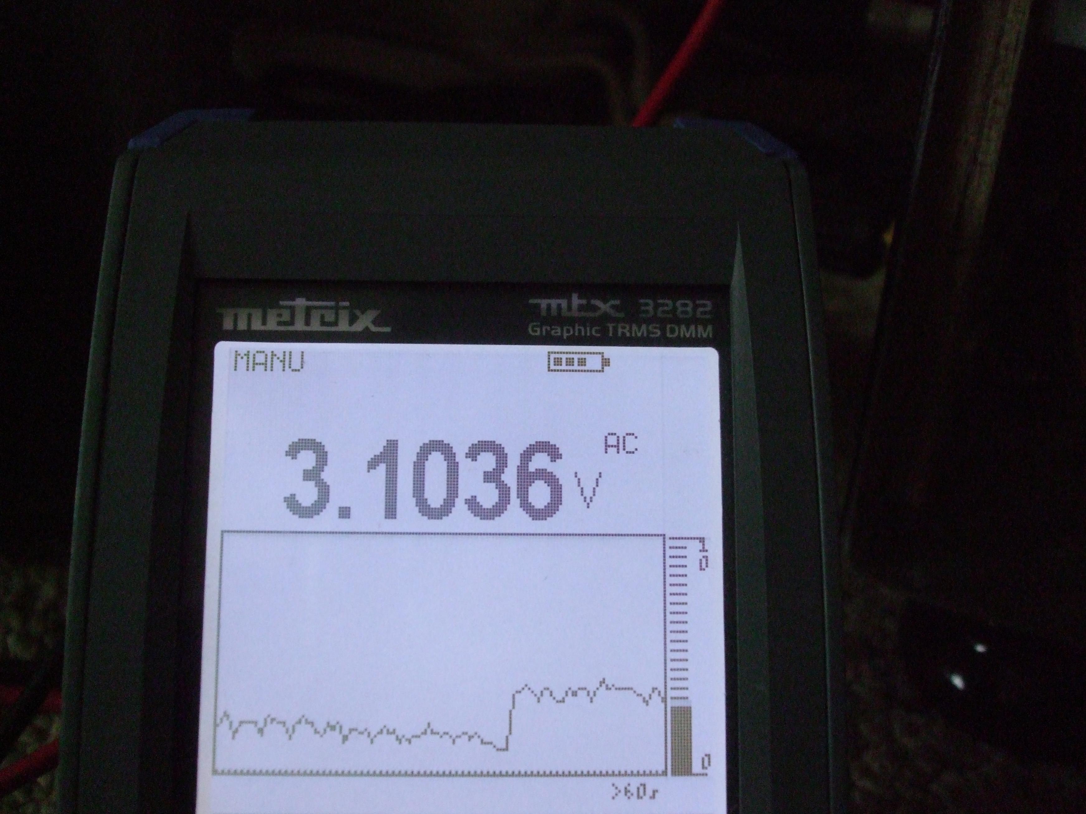

About dinamic range
1 whole minute of the New Cold Play CD at enoug volume to fill bass on tummy.
Range = pup (crapp with explosive duble p at end would not do)

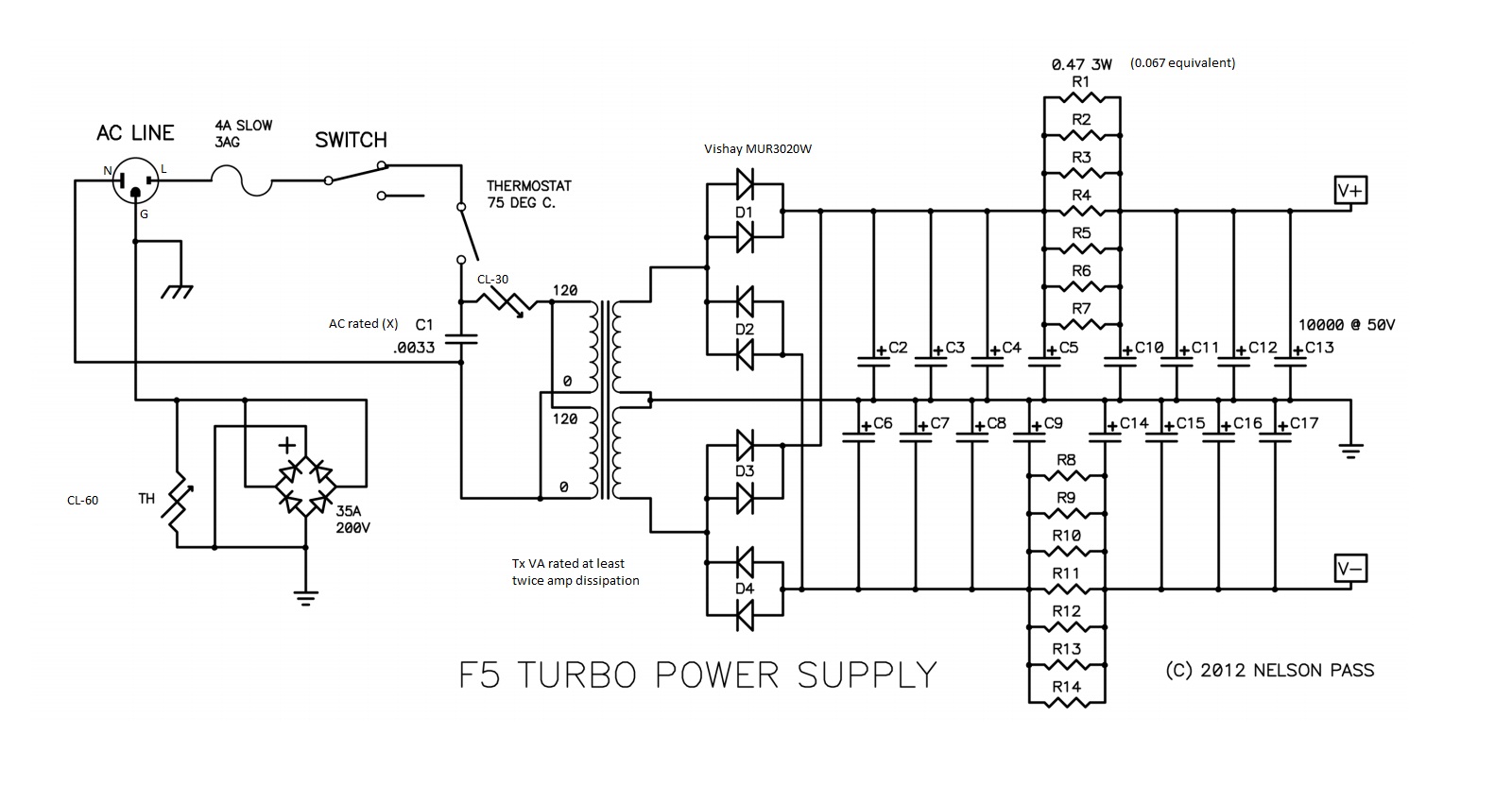

power supply
Concerning the F5Turbo power supply:
(1) I was wondering if there is some advantage in the center-tap style wiring of the secondaries vs the original F5 power supply that uses bridge diodes (other than needing four fewer diodes and one less thermistor on the primaries)?
(2) The paper says "The power transformer needs to be VA rated at least twice the actual dissipation of the amplifier." Can someone please give me an example of this calculation using V1 or V2?
(3) Would using a bleed resistor like in the original have a deleterious effect?
