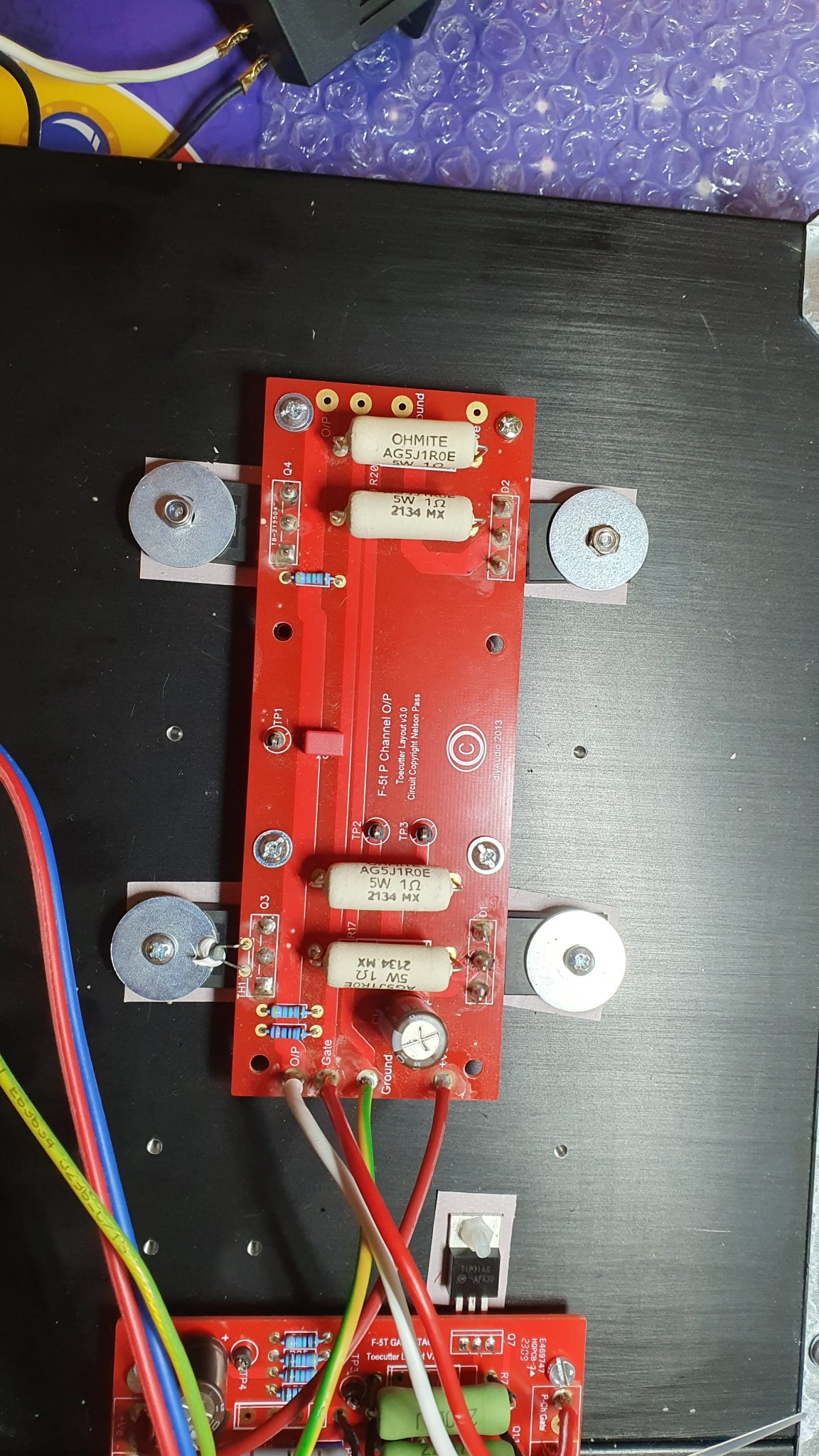

hello, i have a problem with biasing F5Turbo stereo amp
i have 32,5V DC rails, U5 chassis.
i reached point that chassis temp is 56C , p-channel bias 268mV , n-channel bias 330mV and dc offset is oscillating from -10mV to 10mV.
my qestiostions are:
1. is it normal and i can proceed to reach 350mV on n-channel ?
2. if not where start to find possible reason ?
thanks for help

What version are you building?
1. Given that you temps are already at 56C, you'll have to monitor and decide. The 20mV swing in DC offset at the output is acceptable. The F5 offset (if I am recalling correctly) was very stable. However, it does move a bit with temperature. In addition, do you have your inputs shorted?
2. I would not worry.
Pictures would help.
Edited - Hi Dirk! Posting around the same time. :)
Edited again - Until the bias on the N and P is roughly the same, I would definitely not worry about offset.

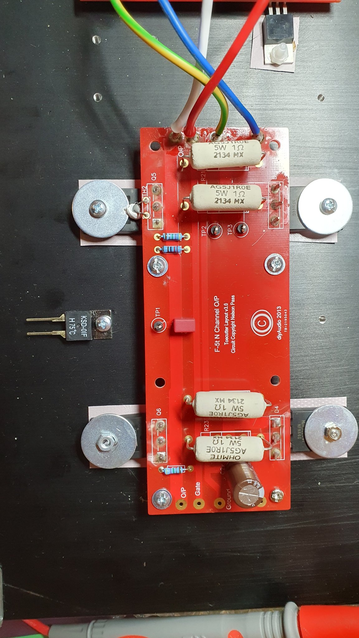

folow your suggestions i shorted input , place termistors closer to transistors and start biasing form 0
now i have 350mV on P-side and 280 mV on N-side. chassis temp 45C , DC offset form -2mV to 2mV
my only worry is 70 mV difference between P and N side.

If it really bothers you, remove the diodes and see if there’s a change.
There is almost always a difference between the P- and N- channel sides, due to the standard difference in the averages of Vgs between the two channel types. You seem to have a large difference, but as the DC offset is nicely controlled, I suggest not worrying about it and enjoying the amplifier.

Thank your for your advice. Now I am trying to bias second channel of amplifier. I checked all mosfet. They are in 3,390V- 3.410V Vgs range. I checked also diodes and V+/- = 33,6V. Problem start about 30mV of bias on N and P channels. Dc offset starts to constantly dropping. I correct it with increasing P1 but bias does not grow symmetrically. I stop reaching 300 mV on P side but bias does not want to pass 80 mV on N side. I checked P1 - 534ohm and P2 507 ohm. Where to find possible reason?
Best regards Dominik

Bias is a function of P1 and P2, each pot biases one side of the amplifier. Increase P1 some, increase P2 some, etc… both sides need to be raised in a somewhat even fashion.
DC offset is also a function of both pots… as minimum offset is going to be found when the N and P sides are in relative balance, taking into account the various transistor measurments.
Question - you say N side never increases past 80mV? Is this using all the turns on the pot?
Can you set bias at 80mV on both sides and achieve 0DC offset? Please attempt.

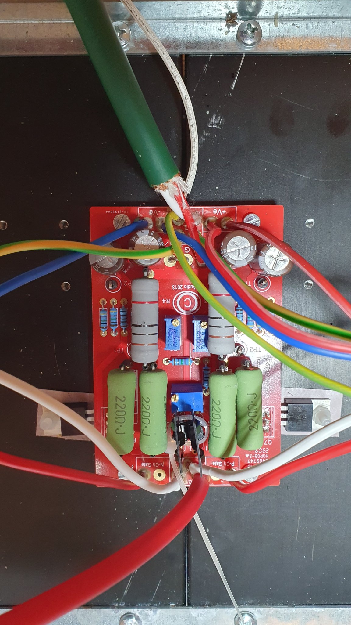

i removed diodes, but it really does not help much. after increasing P1 and P2 and increasing bias na P and N side symetrically and keeping offset around 0 i am reaching point ( it starting around 40 mV ) where offset starts to drop permanently, i tried to correct it by increasing P1 and then P2 but P side bias starts to grow up to 200 mV and N side bias drops to around 70 mV. i can not find balance because increasing P2 i push offset even more to minus
