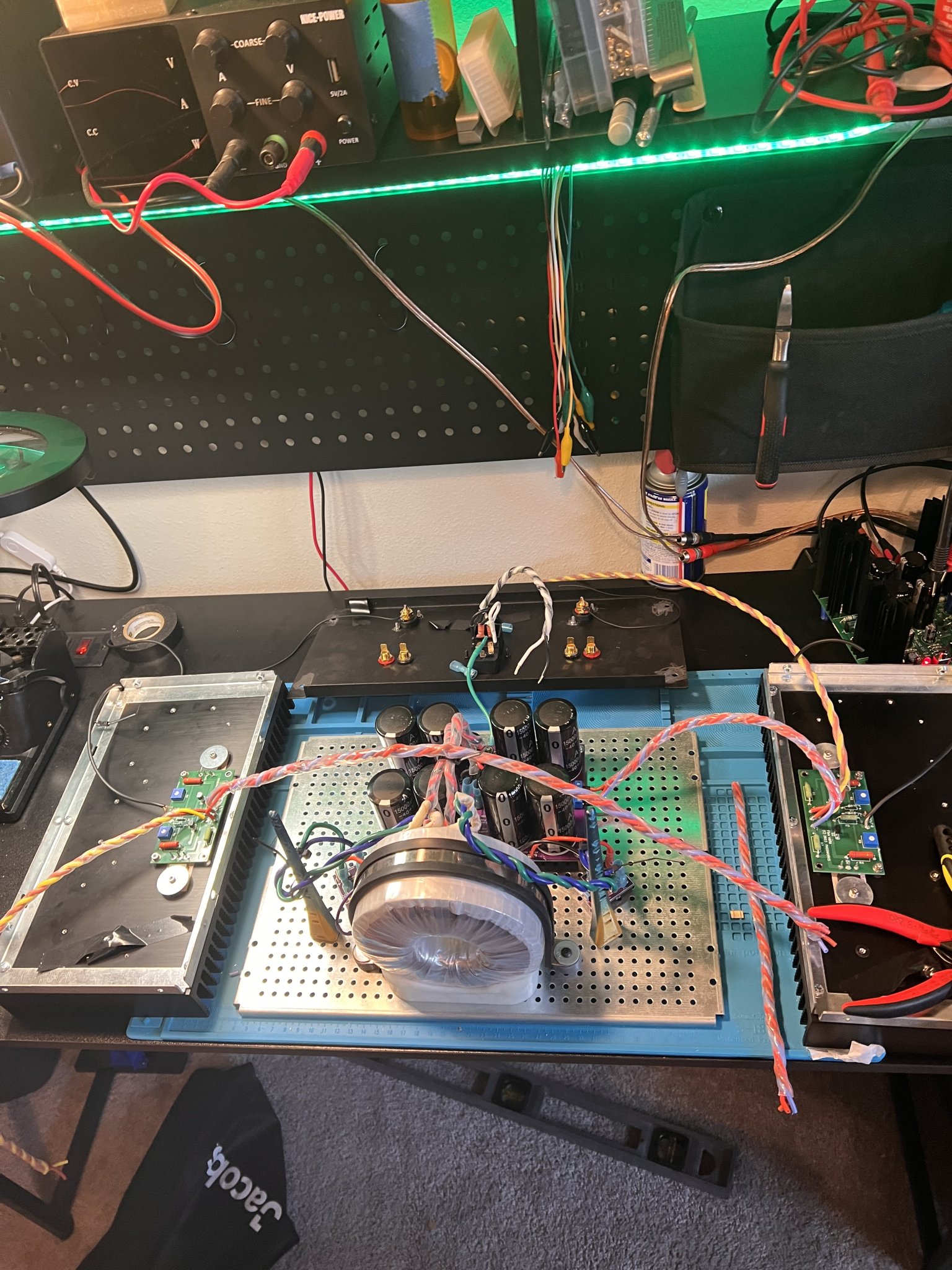

I will probably move the Toroid to the back and the PSU to the front for the heck of it anyway and see what happens once I finish with the Honey Badger I’m starting this weekend.Looks neat.
Consider swapping the toroid and PS PCB... that will vastly reduce the mains AC wiring loom, and will shorten the DC cabling length as well.
The stand-offs are very cute... but the mains wiring loom, if left long, should definitely be placed as close to the metal bottom plate as possible.... the reduction in noise could be as high as 10dB... easily visible if you look for it/measure it.
If you get the 400 mm deep version (all the new Deluxe 2U, 3U, 4U or 5U are 400mm deep) it is the same floor space as the big 5U case. I used 3U 400mm deep chassis for F5m, dual mono two transformers, two power supply boards, plenty of room and dead silent. Height was plenty, don't know about 2U, check transformer height.

You can use a 2u for dual mono with a pair of 200va, but there won’t be enough clearance for the shields. Also will need to keep the bias at 1.1amps or else it will get too hot.
The 3U with 400mm deep, has more heatsink than the old 4U 300 version. Mine gets toasty, but can keep hands on it, no problem. Like original F5, it is DEAD SILENT.Thanks! And the 3u 400mm chassis is perfect for this amp if you want to bias it to 1.4a. At 72F room temp, the heat sinks are at 49-50C.

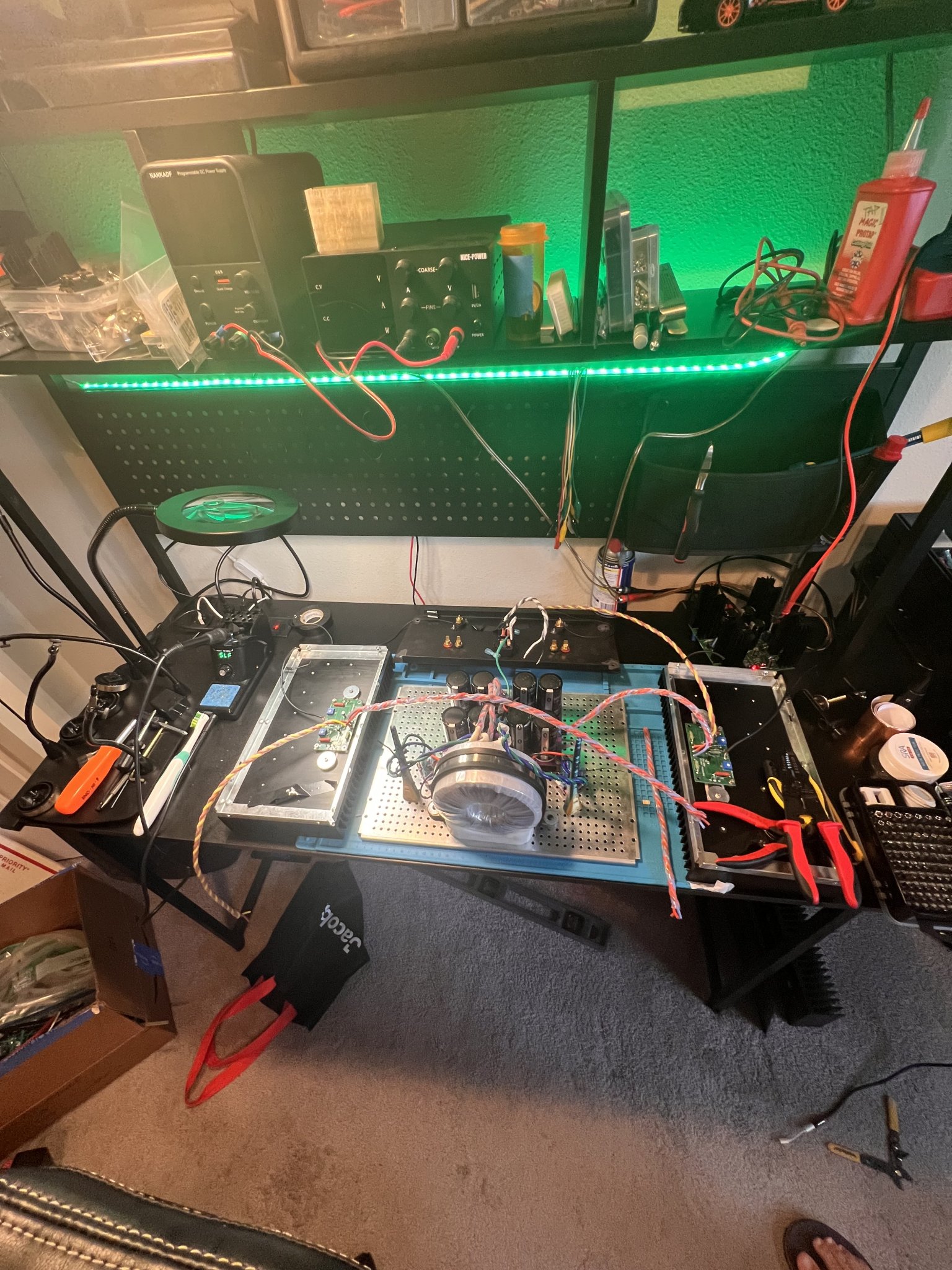

Still haven’t learned my lesson on proper size of cable, tend to be over generous with lenght. Making sure I have enough, which I knew I did. Anyways, this one should be singing very soon, fingers crossed.
Just sharing… not porn per se but some modest foreplay!
