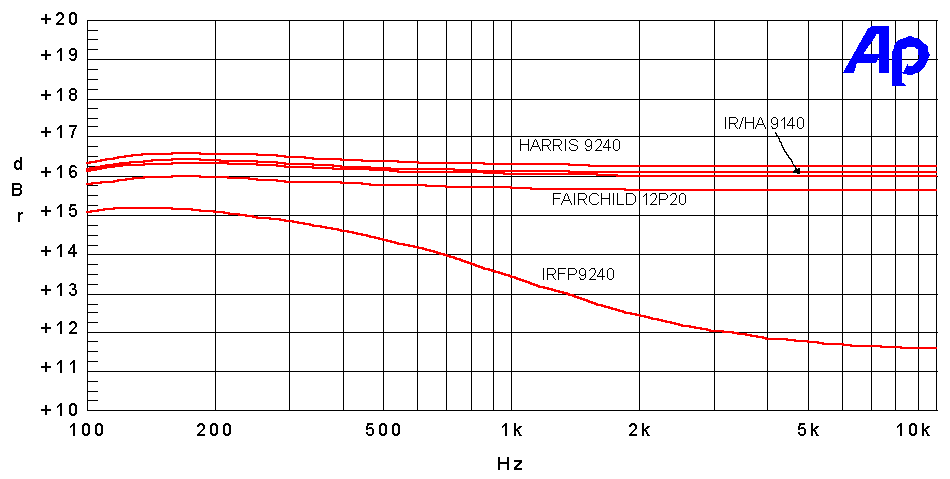

I have had communication with people who are still not reassured as to the Harris vs Vishay P channel
Mosfets for this project, so I present the attached graphic to further quell attacks of Audio Nervosa...
You see here a gain test of five P channel power Mosfets, biased at 0.5 amps and 10 volts driving
8 ohms Common Source. At the top we see the Harris 9240, then below that are the Harris and
IR versions of 9140. Slightly below that is the Fairchild 12P20 and at the bottom, shelving down
about 3 dB going into the midrange, the IRFP9240.
Interesting, the devices with flat response all have very similar distortion numbers, but the IRFP9240
actually had about 1/2 the harmonic distortion when driven to the same output level.
In any case, you can use the supplied 9140's and sleep well....

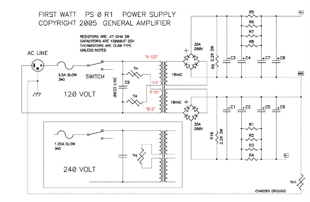

I recently bought the F5M essentials kit and it came with the PS V1R1 board. I see the full kit comes with 35V rated power supply caps. The 2005 First Watt PS 0 R1 power supply CRC filtered design calls for capacitors rated at 25V downstream of a bridge on each 18V secondary. I've used that design for my F6 and M2X builds with 25V caps and never had any problems. I just measured my M2X supply which uses the 300W AnTek transformer and I get just under 24V on each rail ahead of the RC when the PS is disconnected from the amp boards.
Any reason why I could not use some of the 15000uF 25V TDK/Epcos caps I already have with the new V1R1 PS design? It does not seem that the lack of the 2.2K bleeder would make much difference in the unloaded voltage. Coincidentally, they are the same part number capacitor used in the ACAmini (which I do realize uses a regulated 24V supply).
I also have a bunch of 10 ohm 6A thermistors. Any reason not to use those in all 5 positions?

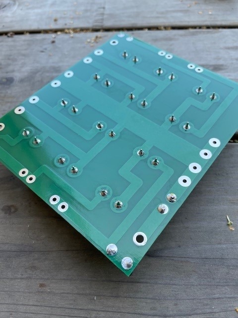

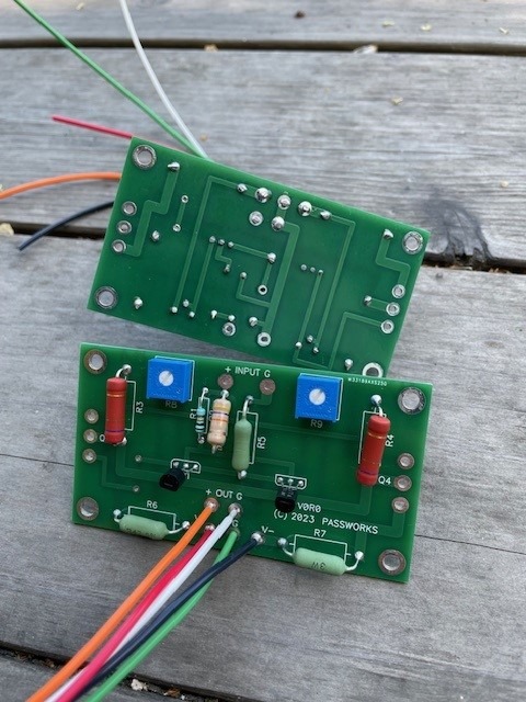

Flux, cleaned, for your inspection. And thanks NP re 9140s.
https://www.diyaudio.com/community/threads/f5m-kit.408290/post-7687559
This is my second drill/tap rodeo, getting slightly better results, but warn you I did strip the Q4 mount on one side, increased the fastener to M3.5 fortunately I had the drill / tap / and hardware.

Maybe this question has been answered but with the V1R1 PS board, would it be better to leave out the jumpers and use at least double the minimum capacitance of 4700uF in each cap position? That looks like it would provide more isolation between the channel boards.
For stereo operation (one PS board for two channels), leave out the jumper. You can increase capacitance.
The jumpers are for monoblock or dual mono, where one PS board is used for one channel.
