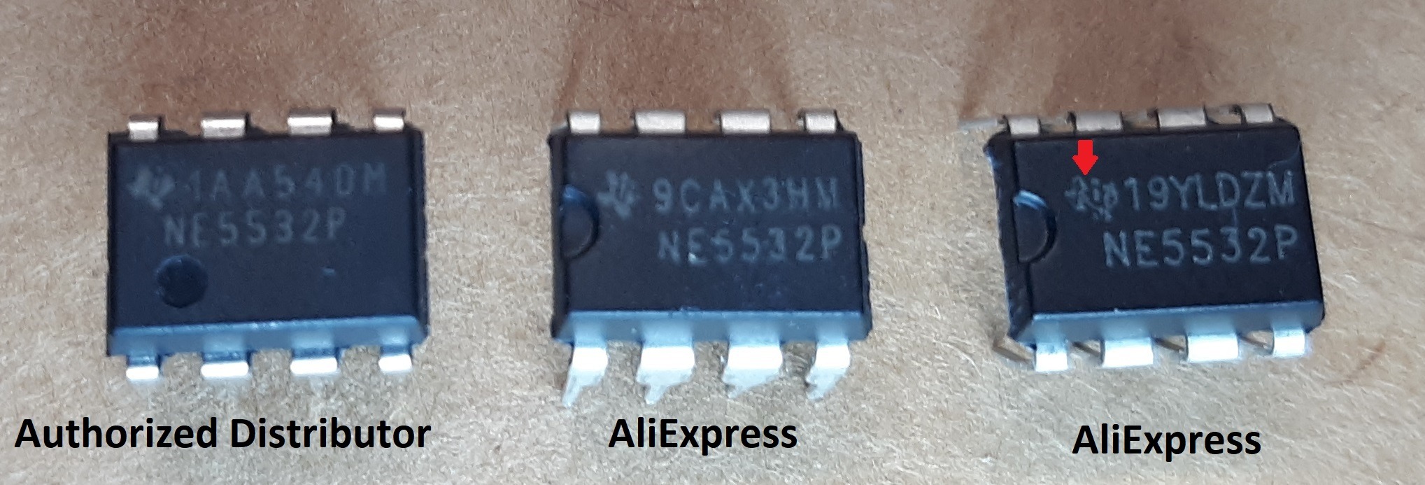

I recently bought in China with the help of a picture from the Internet No. 1, I will receive it the other day.

I just received 5 TI NE5532P from a local small but supposedly reliable source, but I thought the markings were a little suspicious and then found this thread. The TI logo looked a but strange and the 'ne5532p' characters were not quite in line - although it is difficult to find reliable photos of these nowadays in order to check whether this is normal.

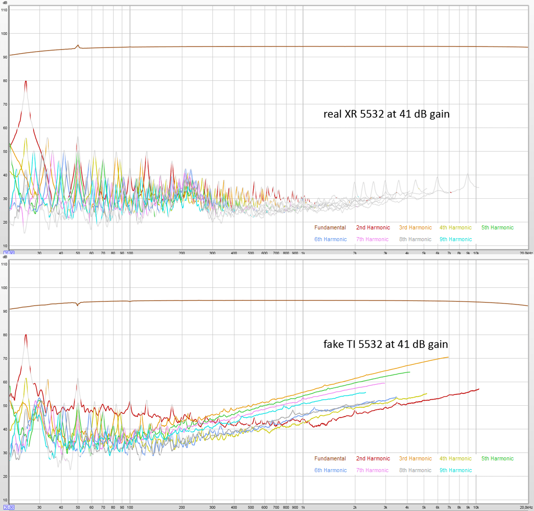

this is a very rough breadboard test for gain/bandwidth and distortion, compared to a real XR 5532P:
disregard the noise and mains hum in the XR 5532 distorsion measurement!

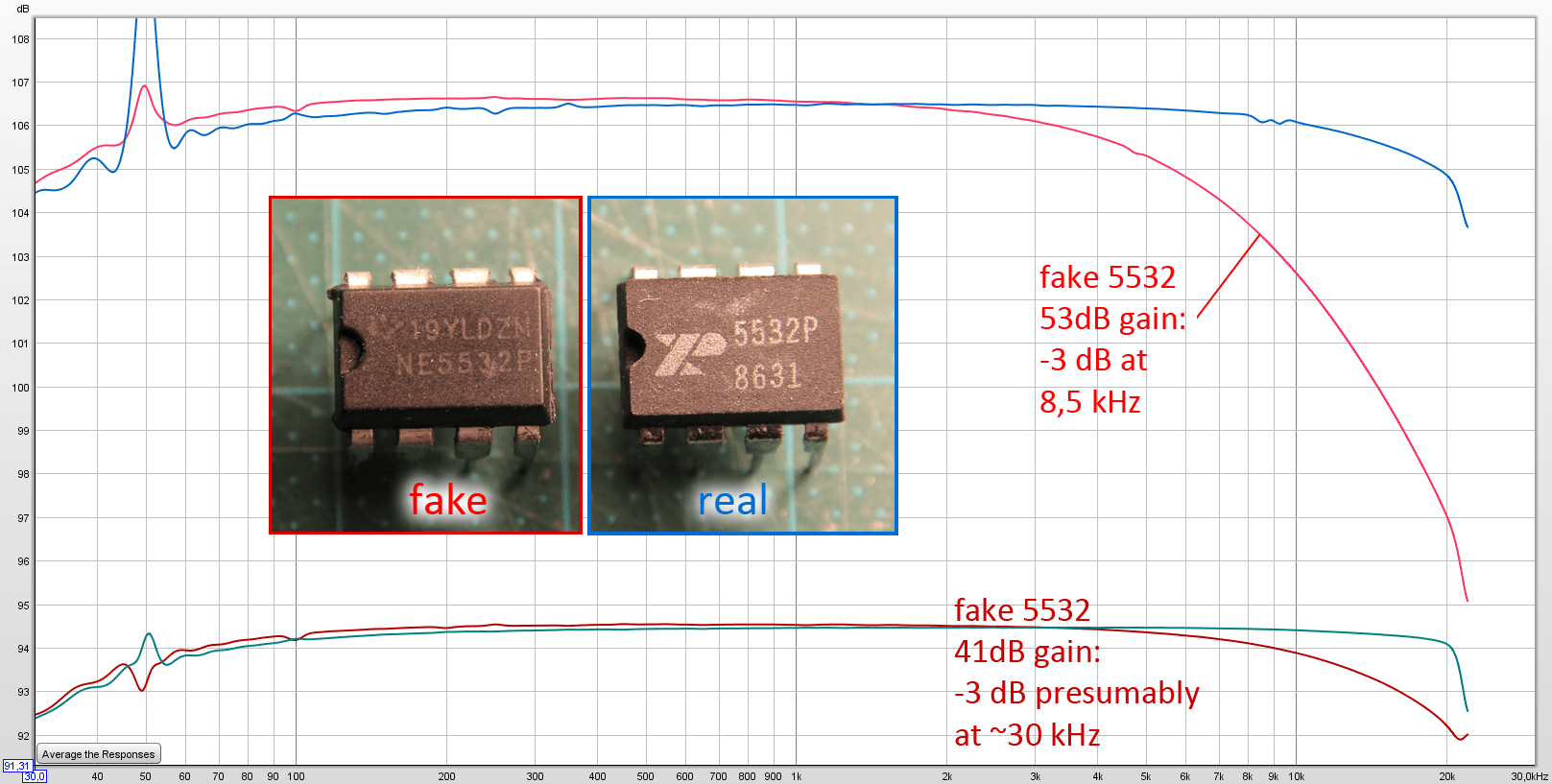

gain-bandwidth product seems to be around 3-4 MHz, maybe these are some kind of rejected scrap, relabeled?
distortion is quite bad...
anyone any idea what those opamps could be?

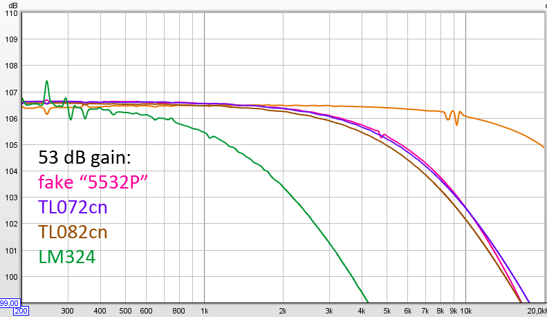

follow up to #32:

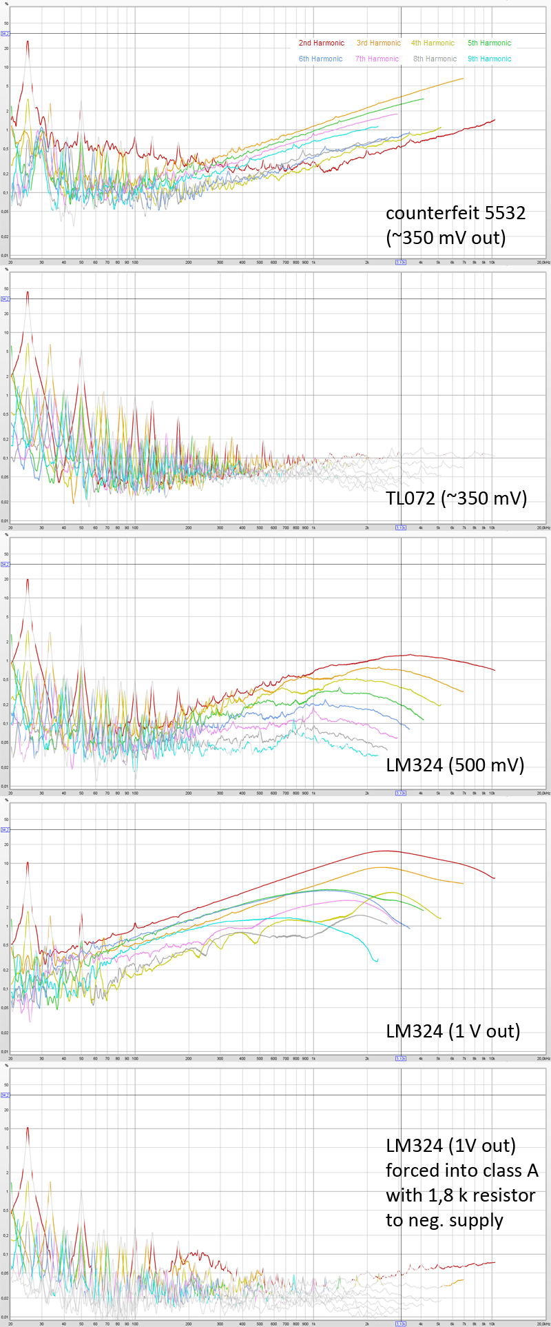

just out of curiosity I also tested TL072cn and TL082cn to confirm the gain-bandwidth product, compared to the counterfeit 5532.
and, just for fun a LM324:
edit: the orange response is the real XR5532!
the counterfeit is still not a TL072/82, the distorsion is much worse - and once more some LM324 measurements out of curiosity:
so I'll just use them for eventual experiments or cruel torturing, if needed!
edit2: again, disregard the noise and mains hum, it was a very sloppy breadboard circuit with huge gain. power supply was a single 9 V battery with a virtual ground via voltage follower, using the second op-amp.
