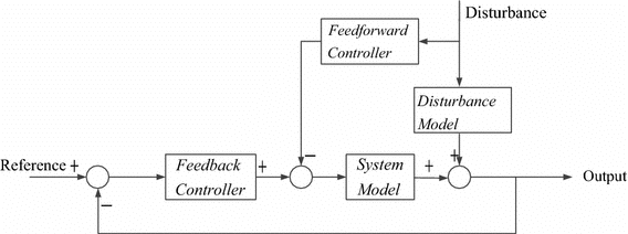

I guess the part that I don't get is: it seems like a lot of things you can do in feedforward you can implement in feedback much easier. Is there any benefit to using a feedforward technique as opposed to a feedback one?
Functionally (at least in the case of audio), for the most part, they do a lot of the same things. Is it just a different way of doing things? Is there greater efficiency? Greater clarity?

The trick is to make the feedforward and feedback work together while having a stable system. That's not an easy task.
Tom
That really depends.
Feedforward control usually doesn't affect stability.
What works very well, is the combination of bringing the feedforward control values roughly close to what is desired, and let the feedback loop control the last little bit.
That way it brings a lot less stress on the feedback loop, and thus actually increasing stability.
Some heating/cooling systems work this way. (I have experimented and designed those a VERY long time ago)
The downside of feedforward loops, is that they work on expected values and assumptions.
Or in other words, they don't work well when a system will change in a (very) unpredictable way.
Or even another way of saying that, they don't have a clue about the output value.

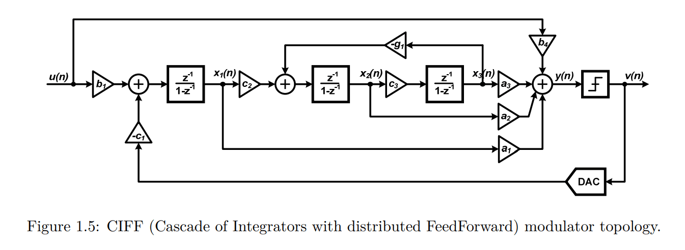

There are maybe a couple of different common topologies people may be thinking of when it comes to feedforward.
One is 'feedforward control,' the other is 'cascade of integrators.'
One applied example of the latter in the sampled time domain:
Please see attached for some more details.
EDIT: Some supplementary material:
https://web.engr.oregonstate.edu/~webbky/ESE499_files/Section 5 Block Diagrams.pdf
https://www.benardmakaa.com/wp-content/uploads/2018/05/Block-Diagram-Transformation-Theorems.pdf
EDIT 2: Someone worked out the equations for some higher order modulators (noise shapers):
https://sourceforge.net/p/playpcmwin/wiki/PCMtoSDM/
No, one just describes the type of loop or control, the other is just a mathematical element.
There are only two fundamental loops, either feedforward or feedback (seen from the total output)
An integrator can still be part of a feedforward loop.
There are also so called nested loops.
So a feedback loop within a feedforward loop etc etc etc

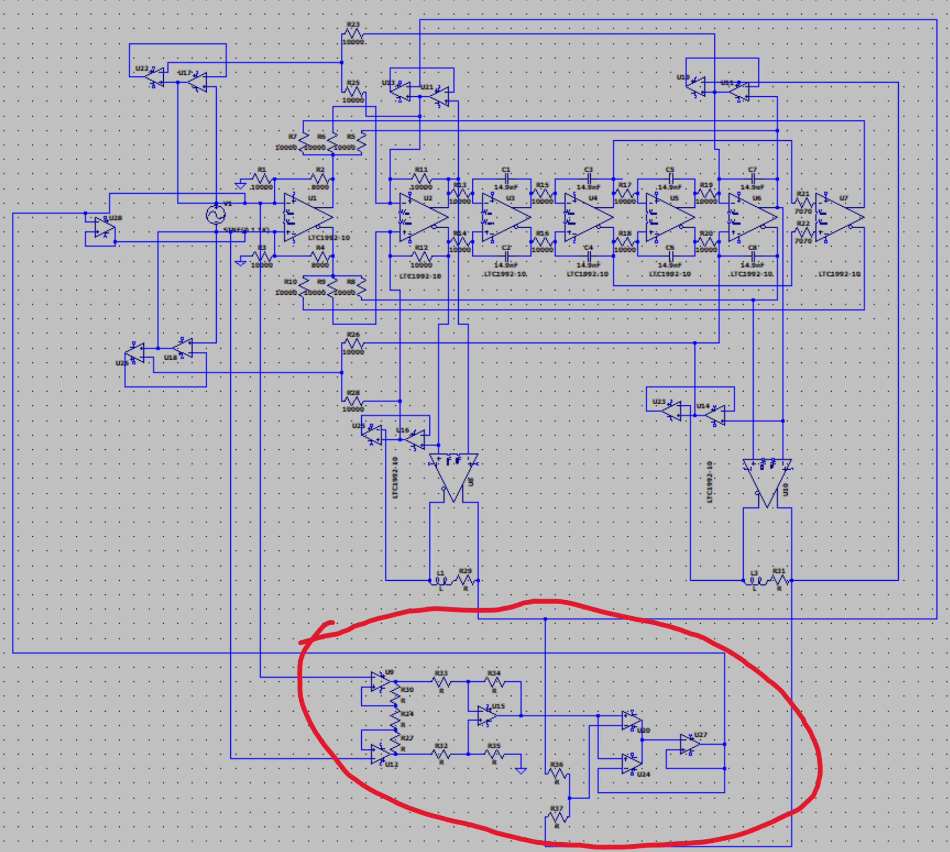

Ok so I want to see if I get this, because I feel this could do wonders for my design.

This is my current preamp design (work in progress a lot of parts are place holders). I used the design @b_force said was a good example and tried to integrate it with my own. Would this be an implementation of feedforward (the circled part)?

Can you explain U28/16 & their complements? It looks like you're driving the source device outputs into ground. Unless the feedback loops there cause the impedances to be different. Also, won't the error correction you're implementing at the bottom counteract the filter?
Sure! I made small duplets to compare the speakers to the filter, and then the filter to the source voltage. Looking at it now you may be right and I'll have to fiddle around with it, but that's the idea.
Thats why I was saying I was dumb and put it in the wrong spot. I wanted that to go to the output as an error signal for the output section. Hence why I was asking if that would be the correct implementation of feedforward... which it's not... because I'm a dummy lol
