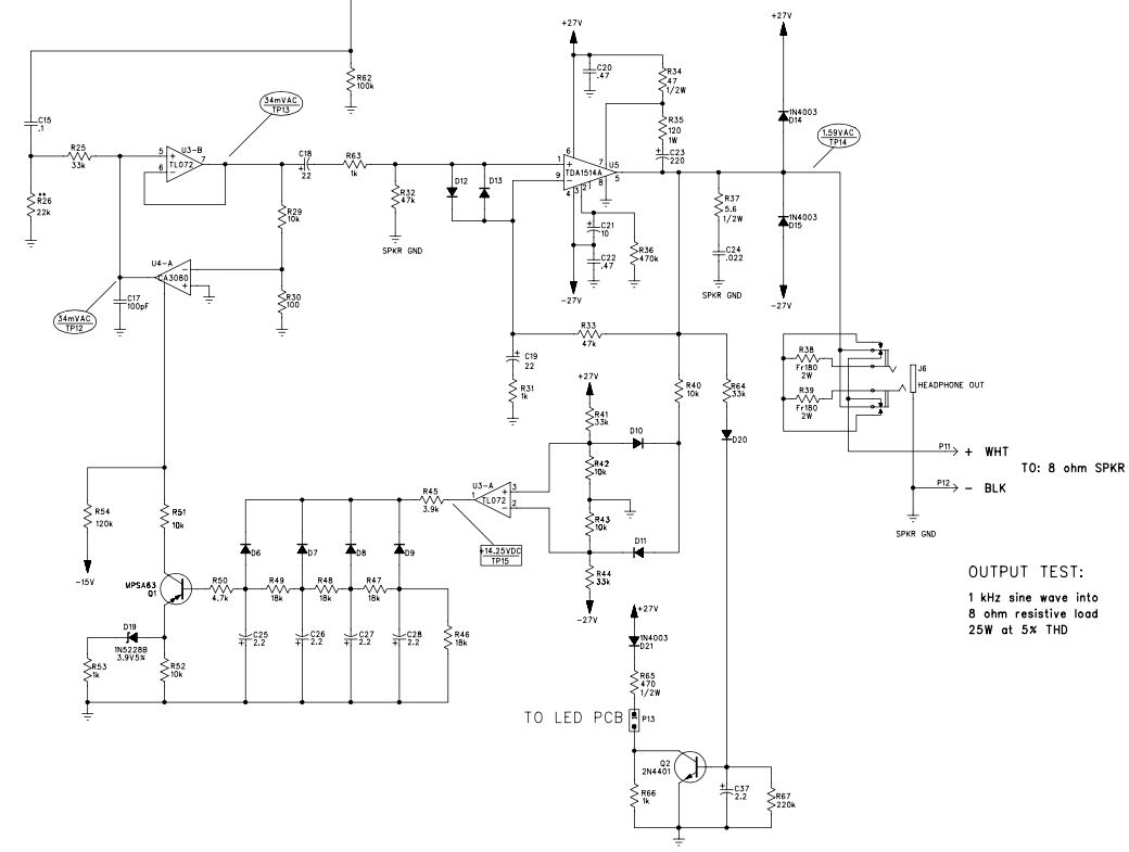

I got a pdf of the schematic and parts list from Fender today for the solid state Rumble 25. I'm not sure if this forum allows attachments, but I'll be glad to send it to anyone who needs it. Also learned the correct email for support from Fender is consumerrelations@fender.com

I to have this problem and it seems there are multiple versions of this amp with different pcb's and schematics. I also do not have a C38 in this amp. I attached a piece of the limiting circuit. If someone who has fixed this problem could point out the offending capacitor on this picture it would be much appreciated.

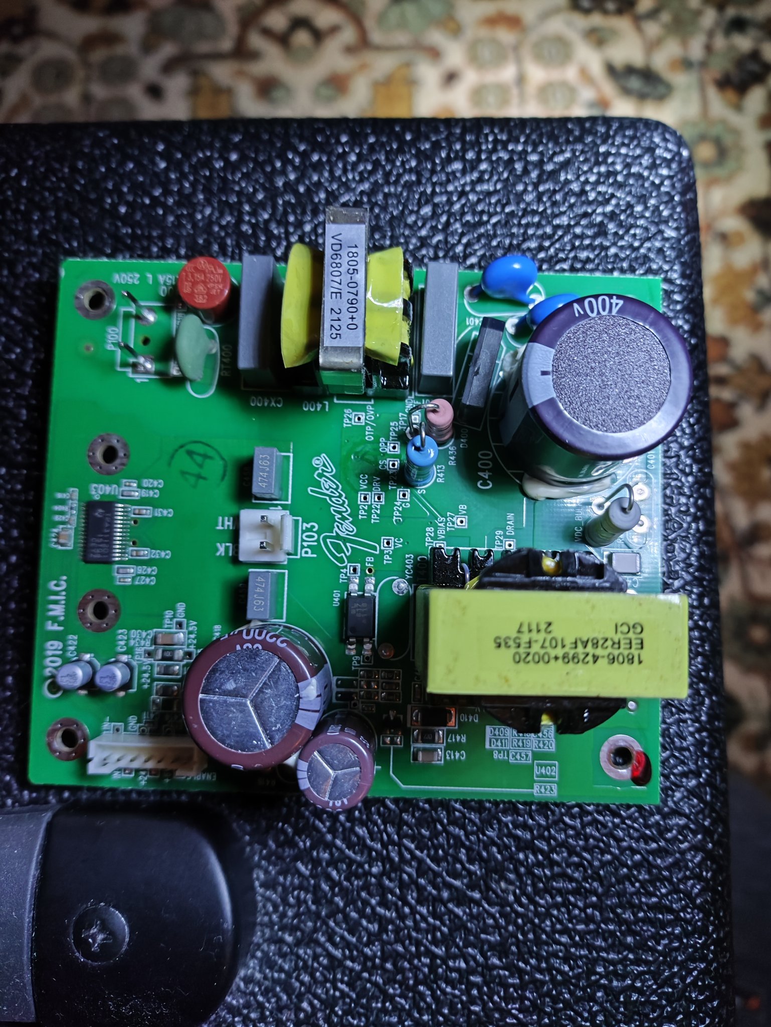

Exact same problem here, only with Fender Rumble 25LT. Sounds distorted on lower frequency registers both speaker and headphone out. I don't have the schematics (already emailed Fender, I hope they will send me something...) but I opened the amp and had a look at the power amp pcb. I can't understand many things (I'm not an electronics expert, just a diy'er) but as far as I can see the electrolytics look ok. Can someone guide me to locate the faulty component?
Thank you in advance

As mentioned above, Fender (like many others) often recycles commercially successful names, in very different products.
Yours is a late model one, visibly a "digital" Class D amplifier and certainly fed from a "digital" switching power supply, both VERY different from what you find in older units, so "their" troubleshooting does not apply much.
My first impression would be your amp is simply clipping above a certain volume.
Various red flags point to that: low frequencies (poorly heard), small speaker on a small cabinet (poor bass reproduction), need for a high-ish playing level, etc.
Don't think something is broken, "it is what it is"
