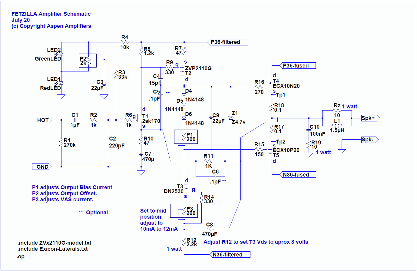

I have also appended here a complete distortion analysis of the FetZilla. Two highly competent EE friends of mine here in Melbourne took distortion measurements of the FetZilla on Monday 27th Feb 2012. They are taken at 1KHz, into an 8R resistive load, at outputs respectively of 1W (+10dB), 13.3W (+20dB), and 26.5W (+23dB):
Fundamental 10.00dB Fundamental 20dB Fundamental 23dB
H2 -93dB 5.012E-10 H2 -78dB 1.585E-08 H2 -78dB 1.58489E-08
H3 unmeasureable H3 -93dB 5.012E-10 H3 -88dB 1.58489E-09
H4 unmeasureable H4 -105dB 3.162E-11 H4 -93dB 5.01187E-10
H5 unmeasureable H5 -102dB 6.31E-11 H5 -103dB 5.01187E-11
H6 -96dB 2.512E-10 H6 -106dB 2.512E-11 H6 -110dB 1E-11
H7 unmeasureable H7 -110dB 1E-11 H7 -101dB 7.94328E-11
H8, H9 and H10 are all unmeasureable
THD by voltage 0.00274% (1W, +10dB); 0.01284% (13.3W, +20dB), and 0.0134% (26.5W, +23dB)
Measurements below about -80 dB can be assumed to be insignificant except in ultraclean designs
These figures are surprisingly good, but with output bias set to 370ma the first 5.5 watts of output are in Class A, so perhaps not so surprising after all.
I would add that the THD does not correlate well with the sound qualilty; rather, it is the profile of the distortion artefacts that affect the perceived sound quality for the human ear.
Not bad for a jfet, two mosfets, and two lateral output fets - only five active devices in total!
My thanks to Graeme and Paul for generously giving their time to measure the FetZilla!

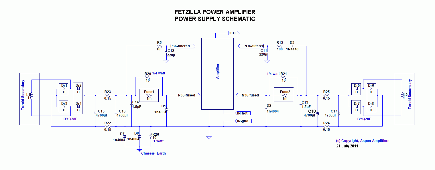

Hi Hugh,
I think the latest Schematic for the PSU can be seen in post 383 of the "Swordfishy/ASPEN FETZILLA power amp" thread Here, where R5 = 10 Ohms rather than the 100 Ohms in this thread. I'm not sure if there are other differences between the versions there and here.
Ron

Ron,
You are quite right; in the later version, post #383, I moved to a lower value because I found that the bass was more prominent this way.
No other changes to the sound however, but no one I know passes up more bass!!
You are no doubt reserving your build for the warm summer months!!
Good luck with the project, and thanks for your post,
Hugh

Andrew,
If you increase R5 to match the 100R on the other rail, you reduce the half wave rectified 'ripple' and thereby improve the quality of the DC, clean it up, if you will.
Correspondingly, if you leave R5 at 10R and boost the associated capacitor by a factor of ten to preserve the time constant, again, you clean up the rail, no question.
BUT, in both cases, for reasons uncertain, you lessen the bass delivery. Hence the decision we took.

I read confusion in these answers/replies.
First, reducing the R improves the bass.
Next, increasing the C does not change the sound
Then the following all say reduces the bass, if the time constant is maintained at it's original value.
I found that increasing the C to bring the time constant back up to match the other side and to match the original seemed to me to give a slight improvement in the bass response/sound.
Thanks Rom,
I agree; you are quite right. Accordingly I have amended the gif, and deleted the pdf which takes more time to amend.
I hope this is the very last mistake of this project! My apologies for inconvenience, though I note the polarities on the pcb are correct. All in all, the FetZilla is now well documented.
Hugh

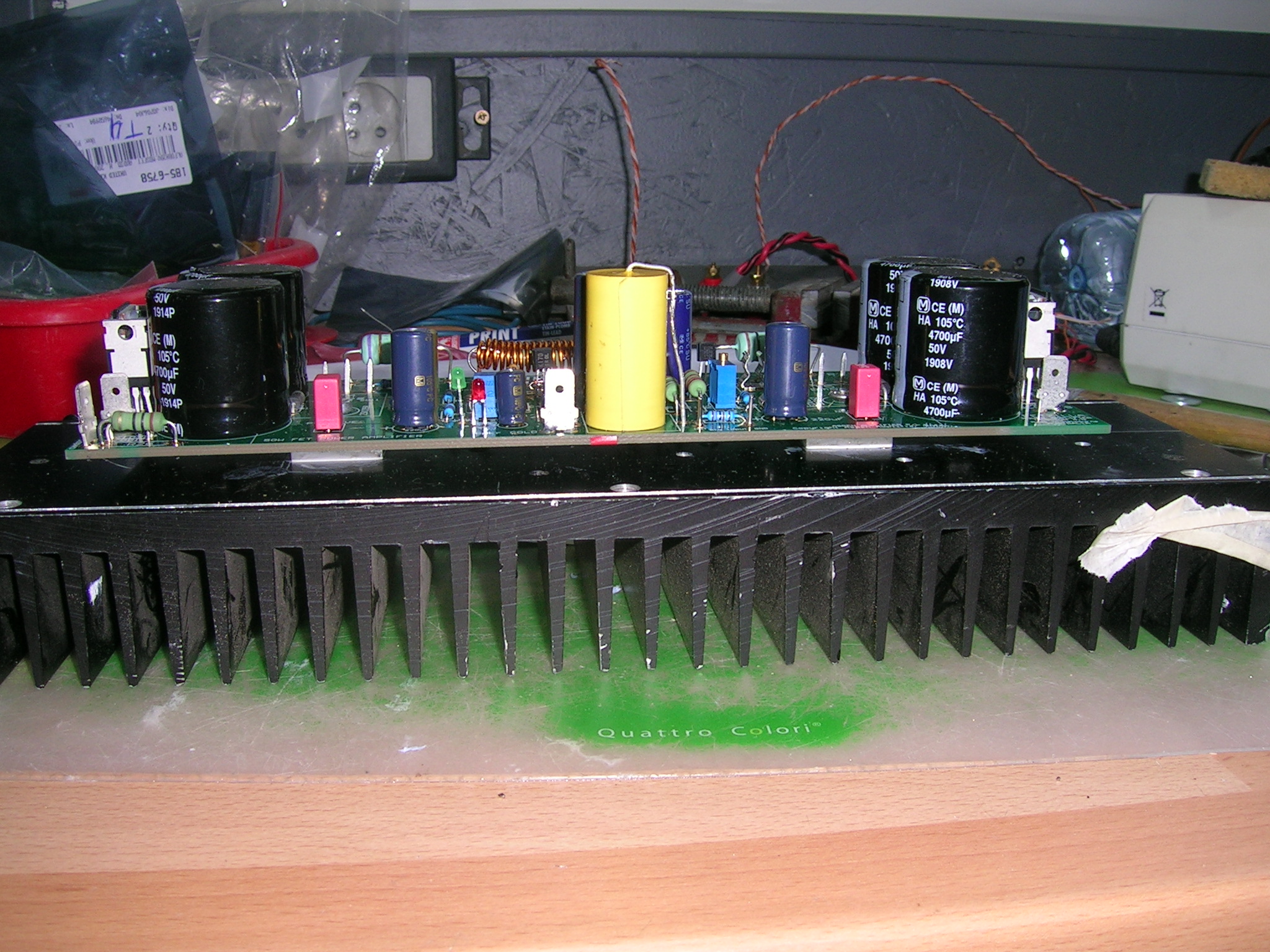

Regarding the rectifier diodes,does they need a heatsink?
hey meanman , when i was building my first fetzilla , i was running it open on a bench and could barely detect any warmth , let alone enough heat to require heat sinks . ymmv
build it and see for yourself . they can always be added if you find it necessary .
good to see some more folks building these . a lot more boards were sold than people building them .
you won't be disappointed :)
