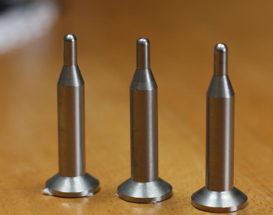

My heavy frame came out quite accidentaly, but I'm not sure that going to such extremes is neccessary, although I was quite biased by the way Madrigal did it in ML31.5 (the lead frame is also about 5kg): http://www.marklevinson.com/image_library/31_5OH_lo.jpg
The springs I'm using are approx 2" long and 1" dia, pretty stiff, under load they compress by apprx 0.1" and resonance frequency is approx. 10Hz. Adding some dumping material inside (but not too much) seems to be beneficial and helps reduce the ringing. I bought last 4 pcs localy, but I'm pretty sure similar type can be found at McMastercarr
The Flatfish weighs approx 2.2kg and the aluminum platform is 6.7 x 9.6 x 0.6" Looking at the pics one may not figure out what those weired spiked legs are for, but they actually act as horizontal spring like suspention with resonant freq of 3-4Hz.
