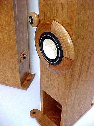

If you can afford it, go with a good quality void free plywood. You will probably have to go to a lumber yard, not a chain "home improvement" store. Otherwise, use MDF with a nice veneer. People complain about MDF (with good reason) however, MDF doesn't warp or cup like solid wood does, and if the veneer is done right who'd know? Fostex puts their ST on top, Terry Cain put his close to the main driver. I'm not sure about the effects of placement at these frequencies. I suspect it's not as critical as it would be in the upper mid-range.
Wow:bigeyes: I can't dream of anything like that.
Thanks for the suggestion. I'll check the area around for lumber yard.
Regarding the ST, some put it even at the back of the box. I don't think that'll be an option for me. I've seen it placed (similar to your picture) closer to the inner edge of the speaker. Id did some experimenting with my existing speakers by adding some fome weatherstrips next to the HF driver and found that the imiging improved alot compare to no-fome-strips version. Also I heard some speackers with a simmilar placement (offset to the inner side) that really had a good imiging, but as you said at those ST high frequencies may be less important.
Thanks again!

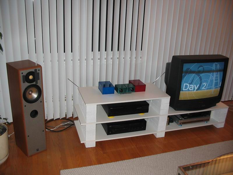

Timn8ter said:
Hmmm...your picture makes me wonder about offset tweeters rather than in-line. :confused:
I'm sorry, but I'm not sure what you mean. On the picture you see the speackers that I use right now and I don't plan on touching them. The rubber strips yu see really changed the soundstage. Actually the latest position on those is : single strip around the left right and bottom part of the tweeter (so not exactly as shown). The biggest efect I got from the inner strips (single one only).
I'll put together a drawing if you want.
/Greg
