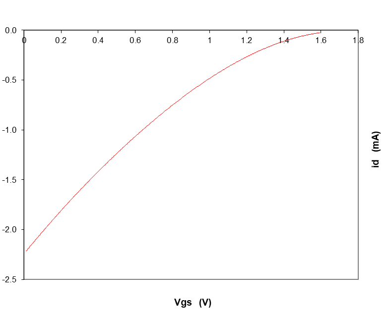

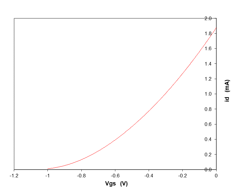

As promised curve tracing of the SMD complementary JFETs.
So we ARE in business.
Patrick

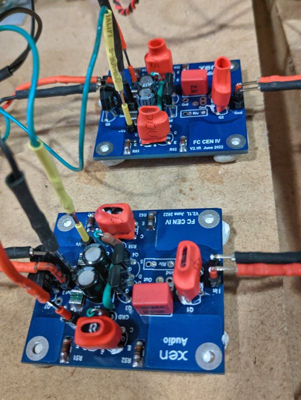

I felt a bit guilty as I was pretty slow at getting the beta build done - other things got in the way for a while. Over the last few evenings I built up a pair of these, verified basic functionality, and have them running now in the main system. They are sounding very good indeed - I don't think you would be sorry to have a pair of these at the end of your Miro DAC (or others) and it is certainly well worth the relatively low cost involved - a pair or valves could easily cost you more. The build is reasonably easy once you are comfortable with surface mount work (no really small stuff!). As usual, good soldering technique, patience and an organised workflow help a lot.
They are running now as I type this, using about 25mA per rail (15V rails) and while I have them running from a single supply, they really deserve their separate supplies. The sound is dynamic, very good transients/impacts, clean, very smooth, good deep and wide soundstage. I would say bass weight and impact deserves special mention - there is no lean sound here. I would consider this up there at the top of the pile in terms of the IV stages I've had.
There is still some testing on the cards which I hope to complete soon.

Yep, probably..... I might have interpreted that incorrectly. Just to be clear (Patrick had laid this out above):
SMD version - its all SMD, still needing matched SMD components - I haven't built one of these, but I have a pair here that Patrick made.
TH version - the passives are still SMD, but transistors, fets, jfets are all TH (and matching is easier then). This is the pair in the photo above.

I was always wishing a 2sk209 complementary...this one in parallel (if matched) can already acceptably replace k170, if there is only similar j74 alternative, you could really do a lot with a crammed space in SMD form...
And now I guess you have solved that issue in the SMD version somehow...you posted nice image of complementary SMD jfet tracing above. Can we know which 3 legged critters these are or is it a secret? :)
