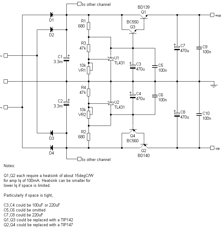

Also if you want the same psu as I am planning to build for this amp here’s the schematic
the new link to the class an amp site and the speaker version plus the other headphone amp and psus is here The Class-A Amplifier Site
