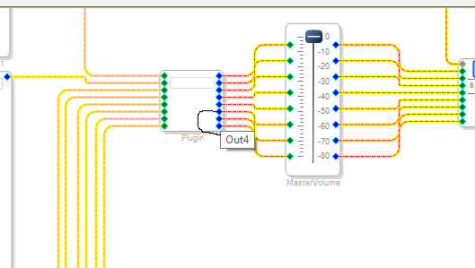

Found it!
In the plugin block the outputs are not in correct order.

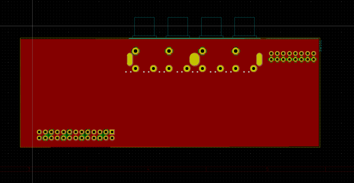

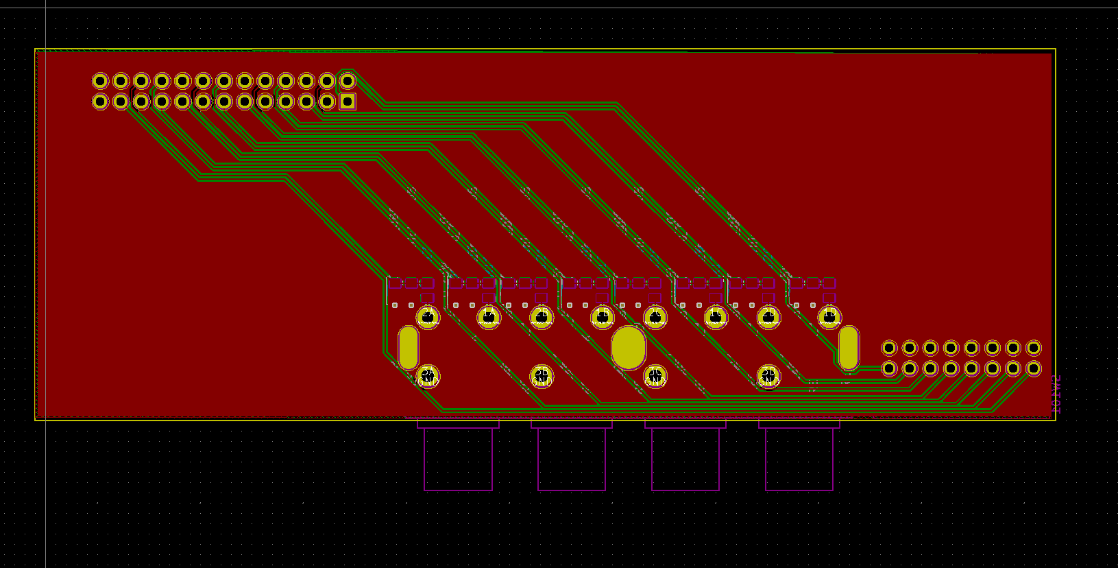

i tried to make a small 8 channel rca board
it's essentially the addon board b with only the rca section
i'm planning to use it on the input and output sections application is a car audio dsp
it was a my first time using kicad let me know if this idea works before i make it :D
ive attached the .kicad and .pro file in a .7z if anyone wants to check it out!

@NoOnes2 I did not look at your file but basically you have to copy the RCA input section from AddOn-B including the 220K termination. Replace the DIP switches by a wire. For ouput let the cold output floating. Don't connect it to ground because it will make the the output section clipping then.
Raphael
