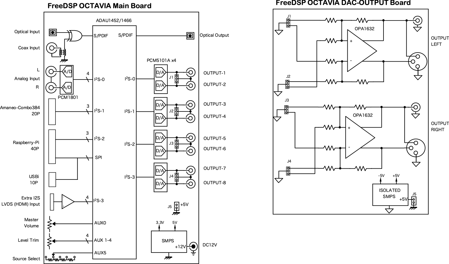

I started planning a new FreeDSP project named "FreeDSP OCTAVIA".
An ADAU1452/1466-based Octal(8ch) output board that has various input interfaces.
The attached current idea block diagram feels too much for ordinary use cases...
So I'd like to reduce interfaces after hearing your opinions, suggestions, and ideas.

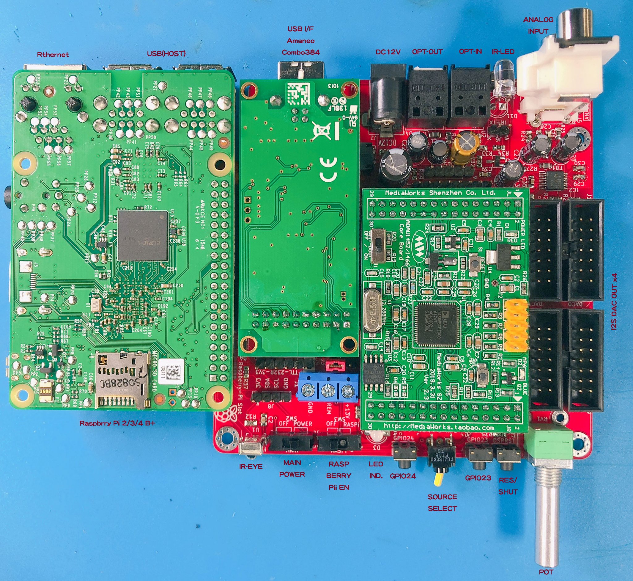

One more application for USB-DAC, which has 4 differential DAC processing. An additional board will be required for this application.

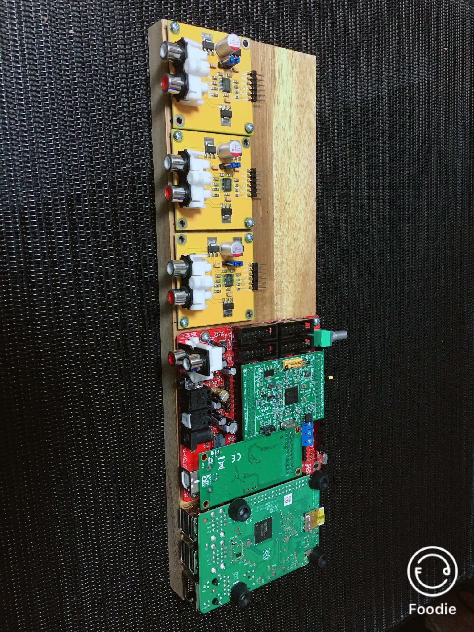

I also attached a similarly designed board picture I made a few years ago. The New board will be a little bit expanded design from this...

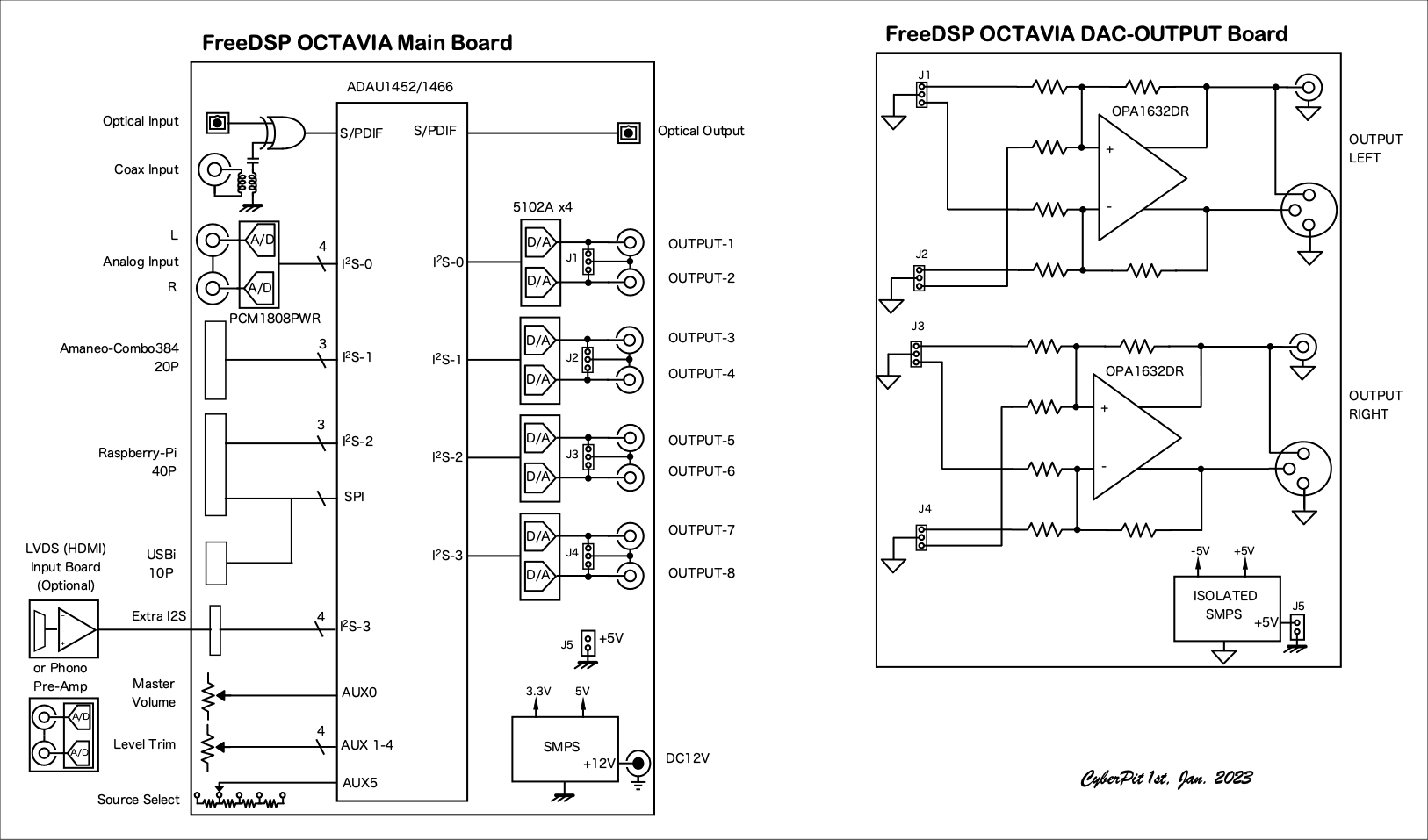

A Happy new year to everyone!

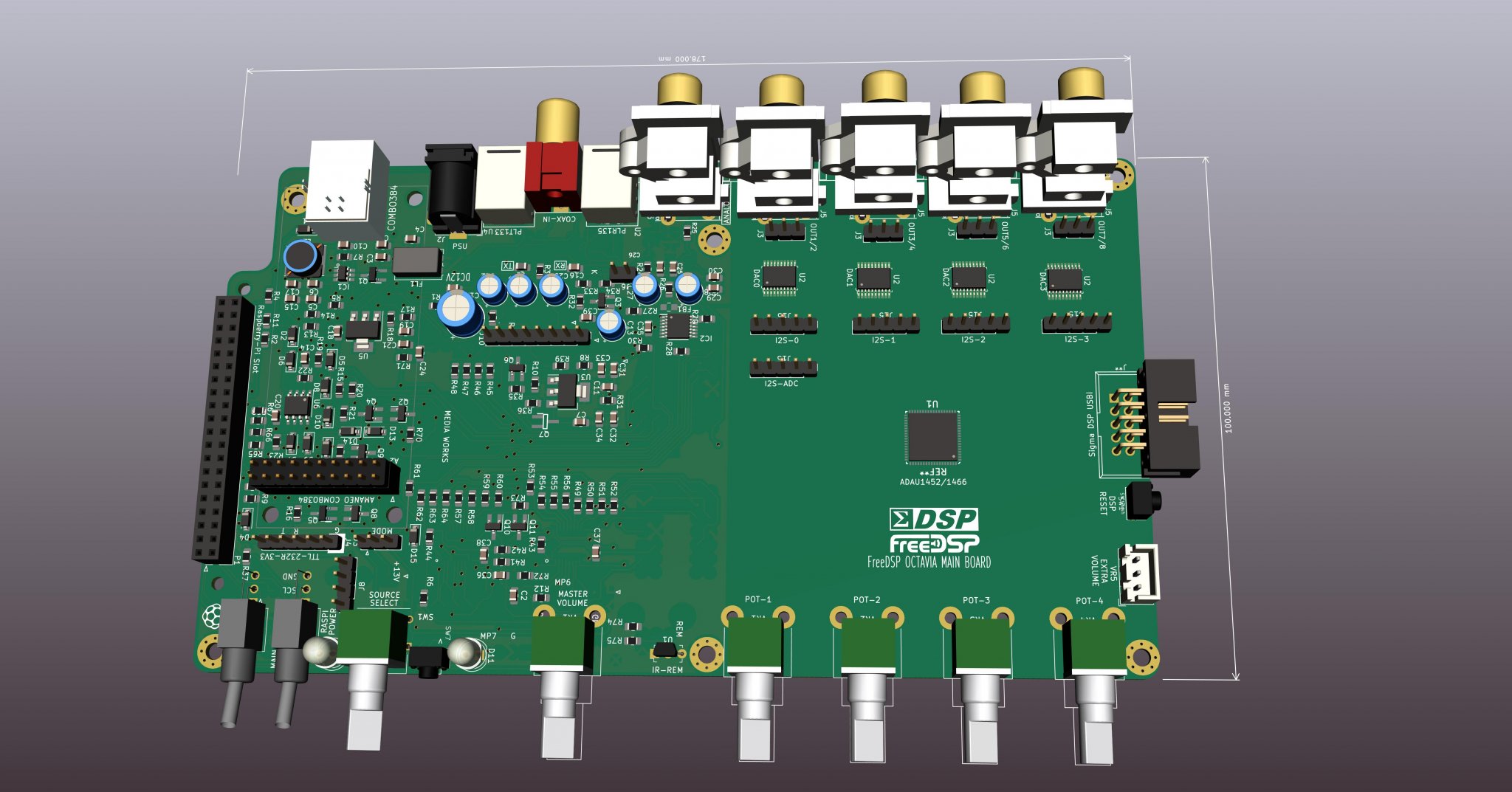

Now I'm thinking about the board layout before designing the circuit.
Small short parts are not applicable. I just wanted to know the size/dimensions of the board...
100mm x 178mm minimum (100x 226mm space required with Raspberry-Pi)

Dear Pit...that's a great new.!!!
That what i was looking for since a long time ago.
You know we had variuos message exchange while you was developing the Catamaran DSP.
The use of the ADAU 1452 would be a must for people who wants to test FIR Filters as well.
Please..Do not forget balanced outputs..!!!

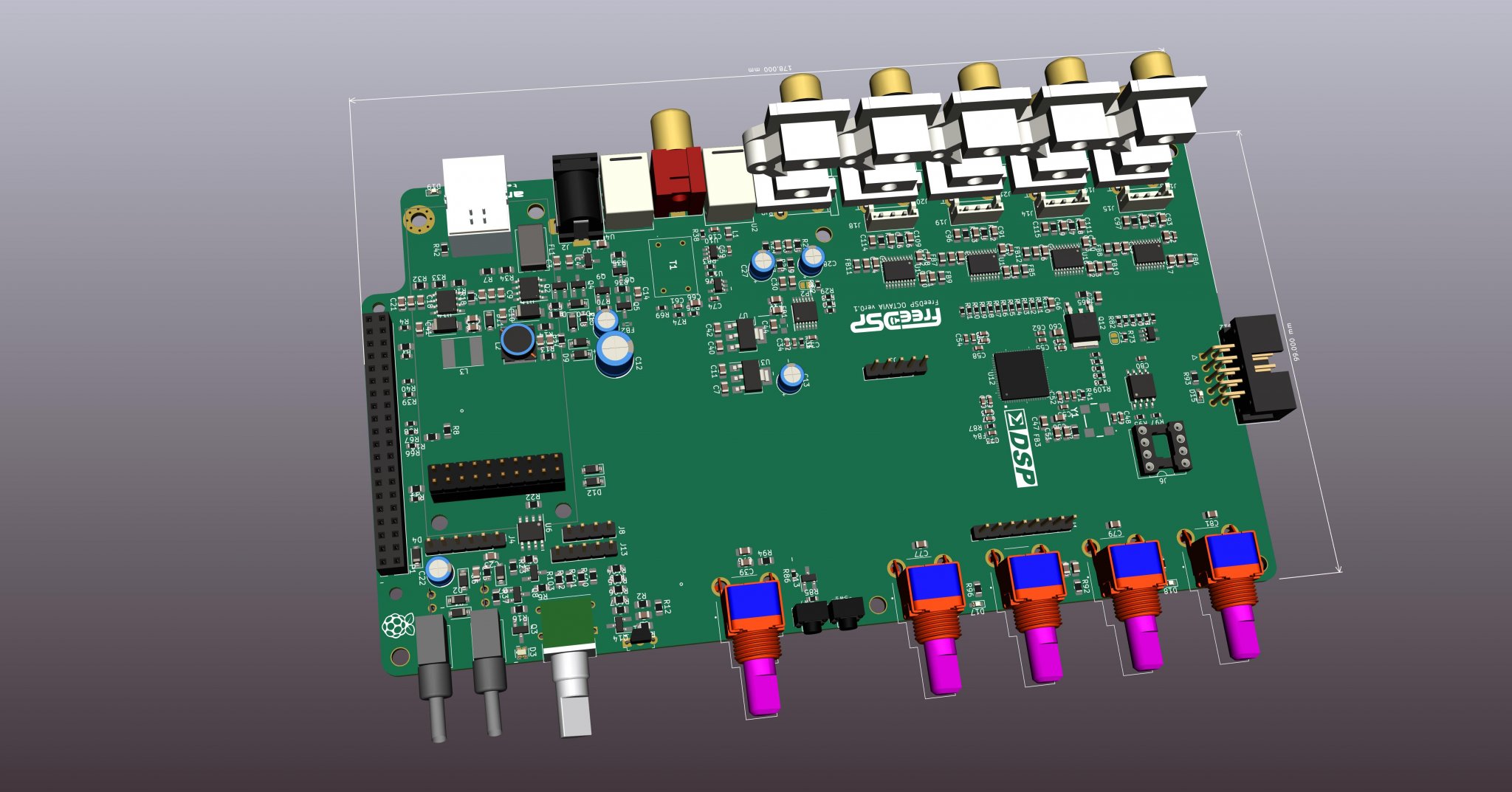

Hi DIY freaks!
Here's version Zero, the draft idea of FreeDSP OCTAVIA. (Just for estimating PCB size)
I'm considering adding 4 times FreeDSP 10P I2S headers, differential Line-driver or balanced line driver.
But the cost will increase drastically if add the 8 times line-driver circuit, muting circuit, and Bi-polar power supply.
An additional constraint is the PCB does not have so many vacant spaces...
So, I'm feeling adding the line driver is not a good idea. Maybe we need some compromise or options.
Feel free to comment(s).

Dear Pit.
Some considerations from my side.
1) Raspberry connector..why?
Who's using a Raspberry with Moode can use the built in Camilla DSP..in my opinion i will remove it.
I would stay with AES IN/OUT..Analog and USB for people using the Raspberry..in this case they could use the OCTAVIA as a Multichannel dAc..
2) Amanero interface..why?
Let people to use their prefered usb interface...Having the AES IN and Out would make the OCTAVIA super flexible..and less complicated i suppose.
3) DAC
Why not the AKm4458..?
To have 8 balanced outputs from one board?
What do you think guys?
Hi Maurizio,
This project is not designed for High-End Audio enthusiasts, just for poor DIY freaks.
Why Raspberry-Pi Slot?
The following concepts are very important for me and may be some DIY freaks.
1. Want to build a One-body WiFi-ready networked media player with enough quality DAC(s).
2. Want to use the wireless Airplay.
3. 1U(44mm) sized stylish Low profile Rasp-pi Audio system capability
4. USBi/IP support
Why have an Amanero Slot?
Just 20P socket is enough to have USB-Audio interface.
I guess various audio interfaces are welcome.
Neither the LVDS-HDMI nor AES/EBU interface is not fit for Poorman's DIY items.
Those are not suitable for this project.
About AKM chips.
1. AKM chips are still scarce on earth. Cause of the accident of fire damage in 2020.
2. Differential output DAC requires external differential buffer circuits (8 times!, Huge PCB Spaces required)
3. Twice to three times more expensive
4. 8 times Serial control requires and software development required
5. JLPCB's PCBA is not available. (Anyone can hand soldering 8 times 64-pin QFP chips safely?)
We need to some compromises to realize reasonable but enough quality products anyway...

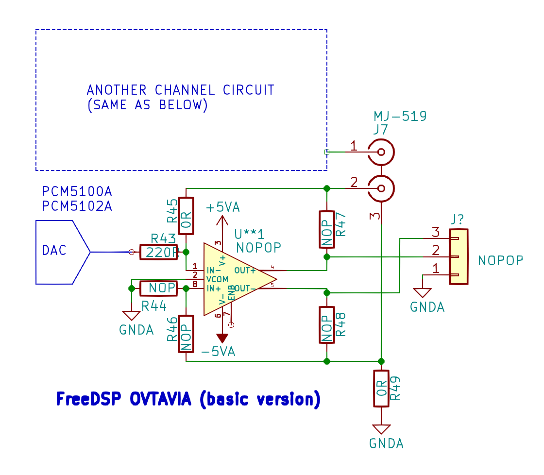

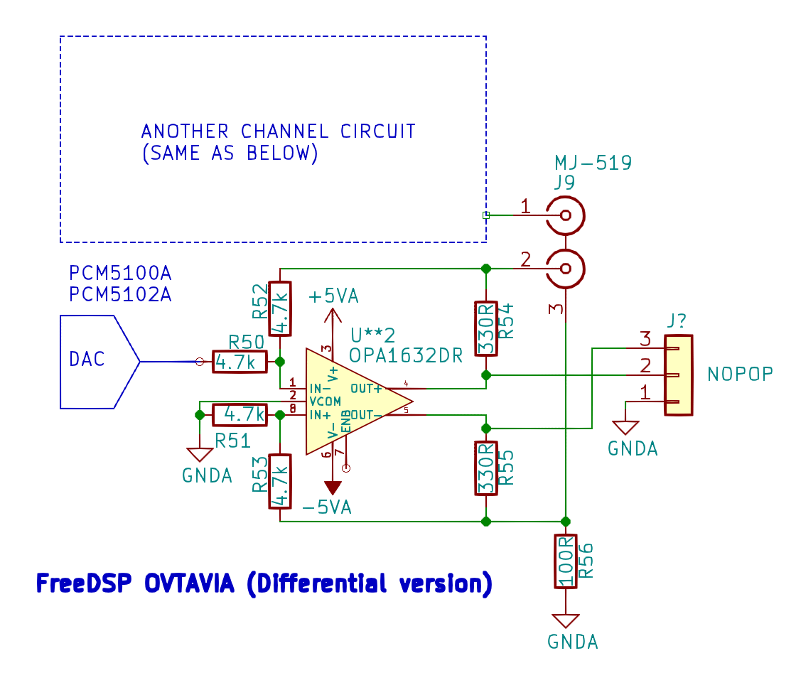

Configuring SigmaDSP over TCP/IP seems a very attractive feature for me. (But it has not been tested yet)
Well, this project also focuses on my circuit design abilities.

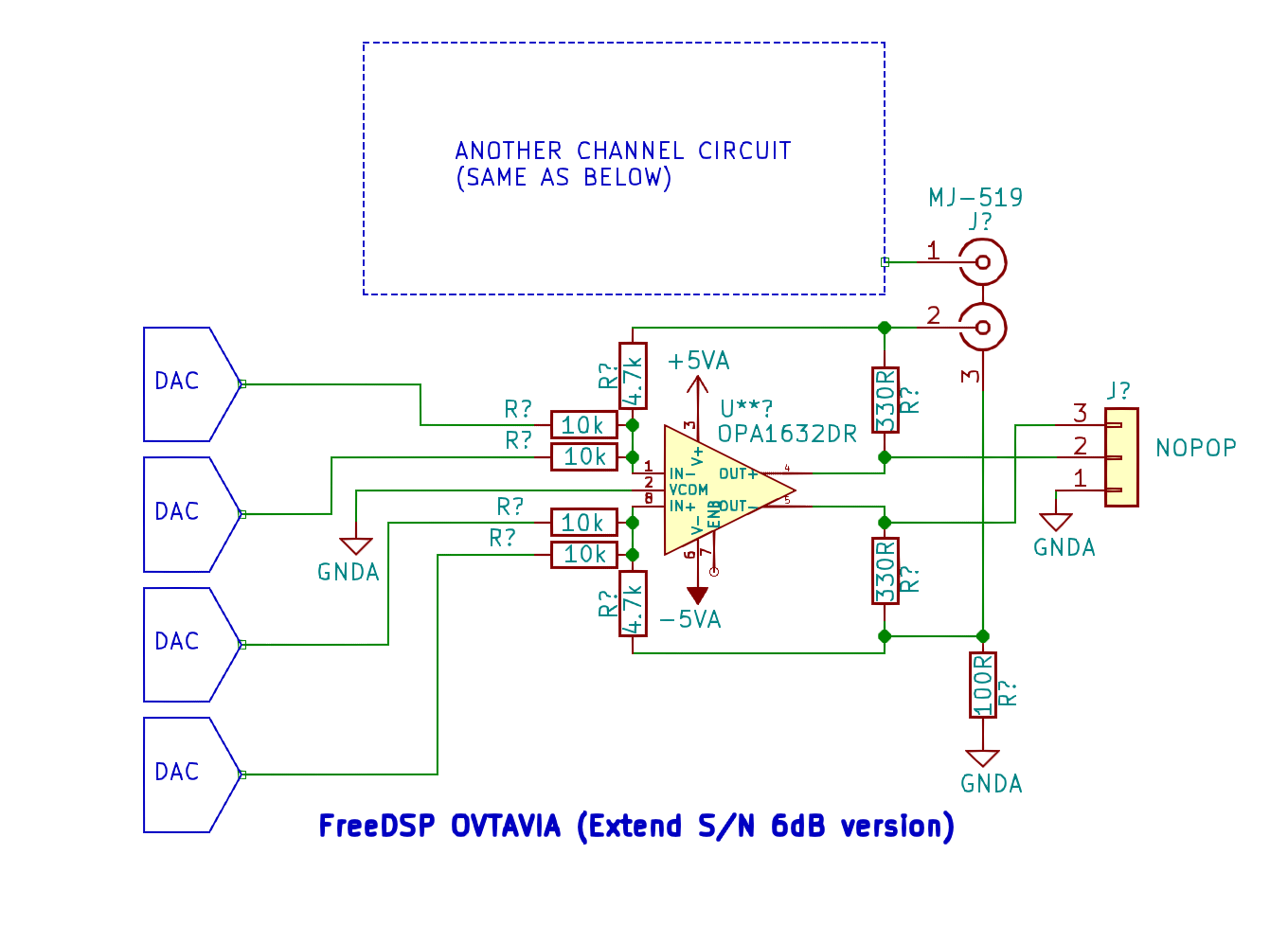

Now I thinking about adding a balanced output capability. I do not want to use DRV134/135 from the point of view of its audio performance. So I will use OPA1632 chip for this project to satisfy all our needs. Using only one PCB design that fits all needs is a very difficult thing, but maybe I think I can do it for the following applications...
1. Simple PCM5102A output (Basic version)
2. Differential RCA output (Differential version)
3. Balanced output header (Balanced version)
4. High-performance DAC (Summing version)
if I try on this, having FreeDSP I2S header will be difficult, does anyone need it?
CyberPit

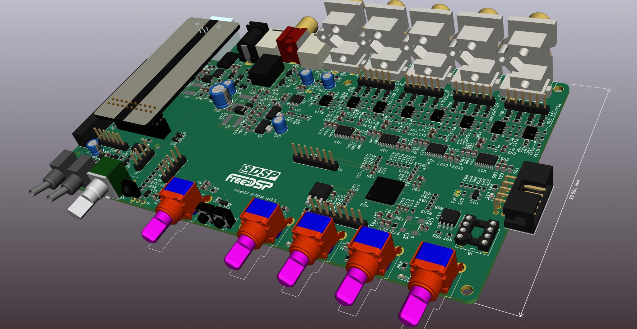

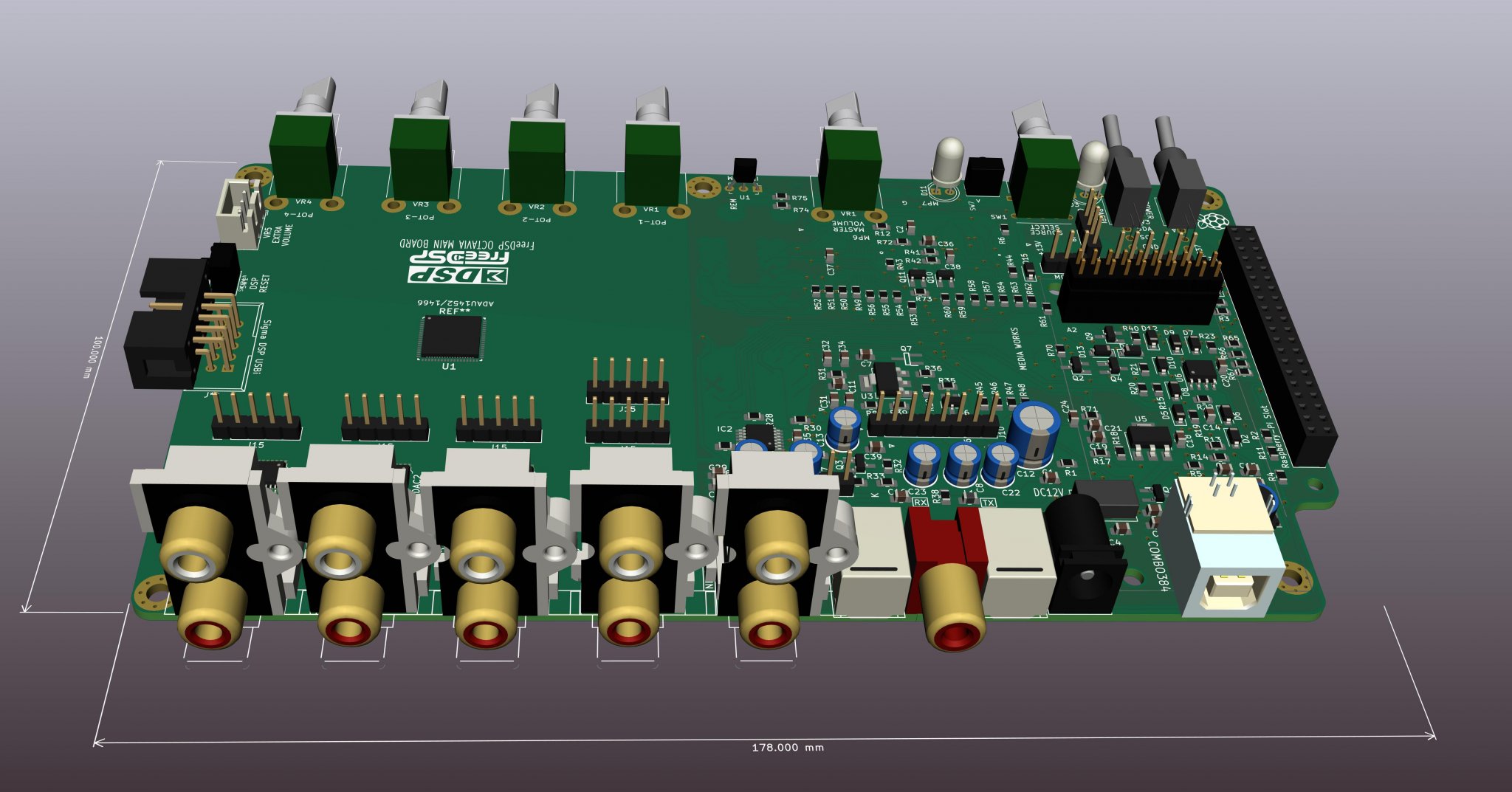

The current design is scalable from 2 in 8 single-end output, 2 in 8 differential output, 2 in 8 Balanced output. An optional I2S/TDM Input header is provided to expand 2 or more input channels. The minimum configuration does not require Raspberry-pi nor Amanero USB-input daughter card. Just ADAU1452/1466 can handle analog I/O and S/PDIF Input and output.
To kaameelis-San, the RCA pin Jack is still provided. And it can output common -GND or differential signals.
To Maurizio-San, eight Balanced output is provided! (Sorry, you need XLRs with cable. It's not on-board)
Attached snapshot is the current board design (almost 90% routed)
It was very hard to implement various configurations with one design, but I was almost there...
CyberPIt
