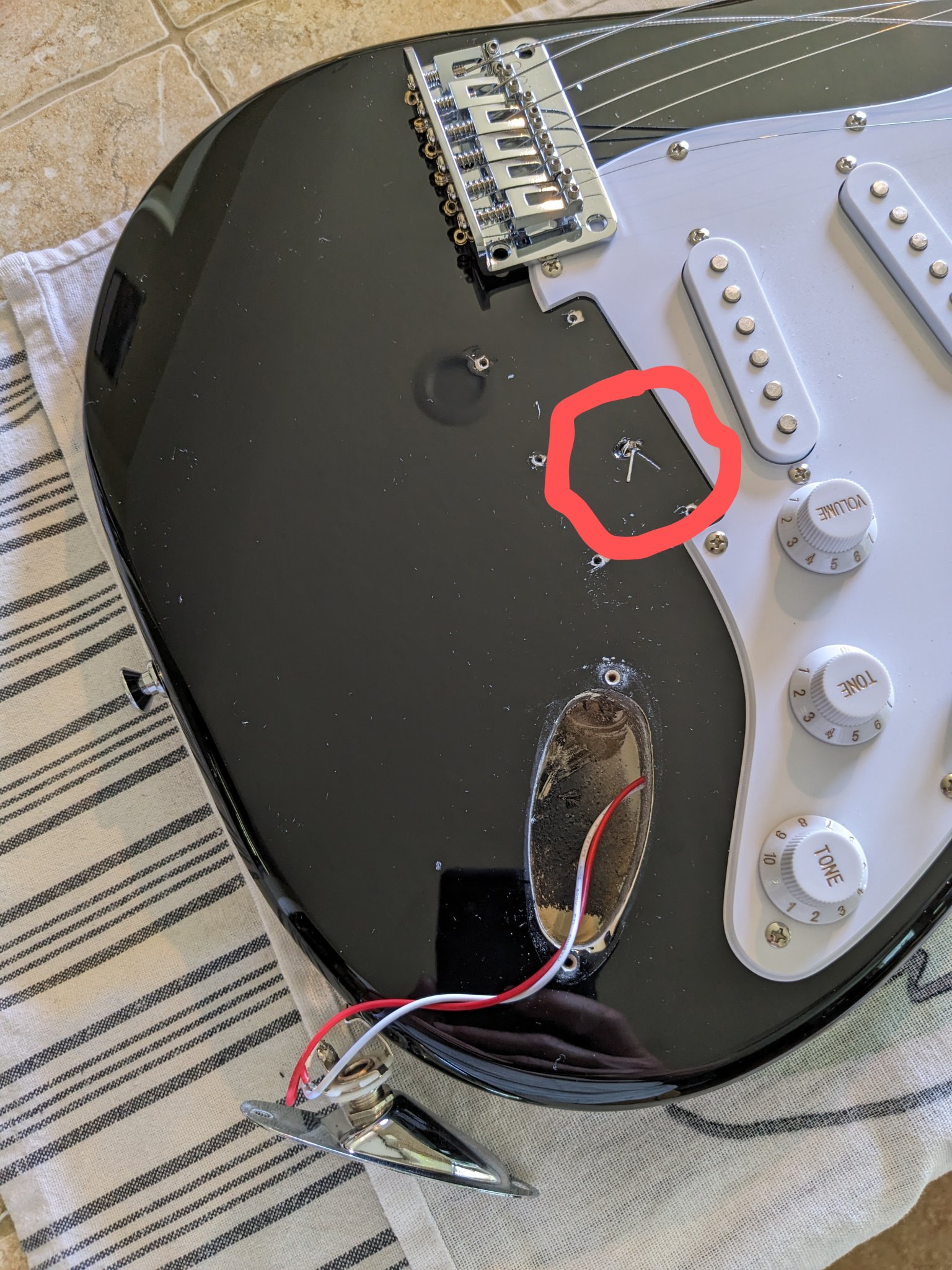

I am having a similar issue with the even cheaper version of the same: Frontman 10G. What helped a lot in my case was actually outside the amp: a bad or broken ground of the guitar bridge!
Are you by any chance using an inexpensive hardtail (as in no tremolo) bridge? If so, it is commonly grounded by sticking a wire under the bridge before screwing it in. And there is a good chance that that wire fell out. This was the case for me. If touching the guitar strings or bridge noticeably helps, this is pretty likely, I had the same symptoms.
Unscrew the bridge (loosen the strings first of course), and see if there is a stripped wire under it - there should be one. If not, trace if the bridge is grounded in any other way - it should be. If not, find a way to ground it, e.g. to the ground of the 1/4 socket.
P.S. I did all that, and it helped a lot. Not all the way - the Frontman still buzzes but it is better. My next step will be putting the screening metal foil on the inside of the guitar cavities.

Its not unusual to see such problems. Its usually the guitar and or the cord causing the problem or most of the problem. If the guitar picks up hum, the amplifier can only amplify it.
A common symptom is the buzzing/hum is less when you touch the guitar strings (assuming the bridge is properly grounded). You can also rotate the guitar around in a circle to see if the hum depends on the direction the guitar is pointing. Often there is some effect with non-humbucking pickups.
Also, some Fender guitars have 5-way pickup switches where the intermediate positions connect to two pickups at once. In that case the in the two-pickup switch positions the pickups may be designed to be humbucking when used in pairs.
EDIT: Regarding hum in the Frontman itself, most likely its just the power supply and or a lack of shielding around the electronics. Does it use a wall wart power supply?
