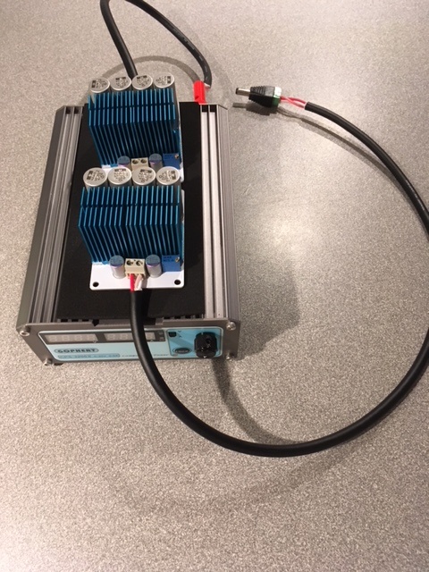

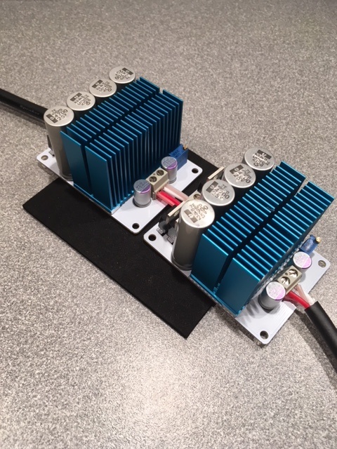

Here is another thing you might want to try out when you get your second single ps?
I have tried it out using a Gophert csp-3205II (floating lab SMPS) powering my Brooklyn DAC with awesome results in terms of SQ.
Three power supplies in series is surely over the top. However, the SQ jump is unquestionable in my setup and it could hopefully give you or anyone else food for thoughts! :)
Forgive the noob questions... but is it no problem to feed the second ps a dc voltage? (apparently not).
How do you set the voltage of the "first" and second PS if for example 12Vdc is the final output?
What happens to the max load in Ampere when put in series?
I set the Gophert csp-3205II (floating lab SMPS connected to a balanced isolation transformer with floating sec) to 14v DC/5.1A max out. The first 3A ps to 13v DC out and the second 3A ps to 12v DC out (Brooklyn's required input). I haven't actually measured the max amperage output of the last ps. The Mytek Brooklyn DAC that this combo is powering pulls below 1A consntinously and peeks during a split second during power-splitter around 1.5A. well below 3A. This is the same figures as when it is powered by Gophert alone. The important thing for me personally is SQ, and this combo sounds glorious! :)

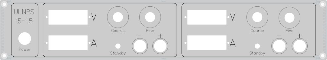

Based on aluminium profile cases by ProMa I designed a lab power supply using the LT3045 board. Nothing for audio stuff, just for sensitive circuitry on the lab desk.
As shown a few comments above I used 5digit voltmeter and ampmeter. Getting the case made took a while, but I'm currently at the final assembly.
-branadic-
