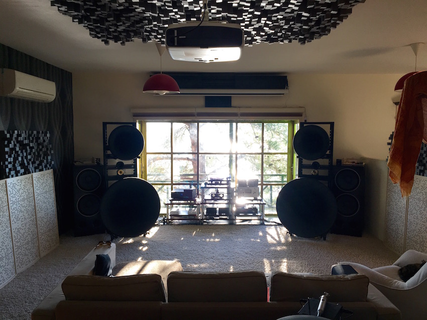

system finished at last

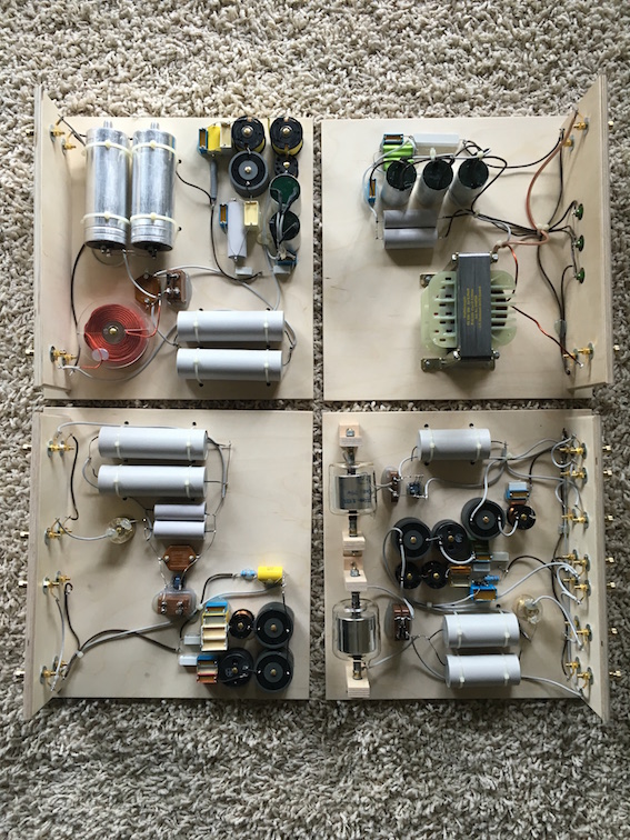

As of this weekend my crossovers have arrived. I need to thank hornFabrik for their great work and help me assisting when designing them.
This is just a first day setup and the room will be properly treated. I have also finished building all the necessary acoustic panels.
The sound, although has minor relative attenuation work, it is not even in the same league as my old system which was very very good. I will be taking a lot of measurements this week and share them with you.
These 4 boards are crossovers for one channel, so I have 8 boards in total. It is a first order filter.

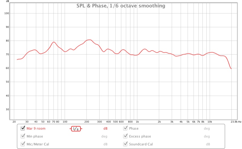

after alignment
This is taken after the first alignment of the horns from listening spot. The 200 hz tractrix came forward about 3cms relative to fostex. The 1400 hz jmlc came about half a cm and the bass horn about 6 cm forward. The system sounds best without angling the horns at all.
The next step is treating the room properly. The biggest problem is from the floor bounce of the bass horn. You see the 200hz peak, that is that. Also the back chamber of the basshorn will have more stuffing (helps around 600hz) and that peak will be tamed.
The 70hz peak is a combination of floor and sidewall bounce from the dual tad bass units. With more treatment to the wall and floor, that will be tamed a little more.

Not just from graph. I used impulse response for the alignment but it shows in the graphs as well. You can see them especially easy with upper mid and tweeter alignment. They phase each other out around crossover region. When I corrected the alignment, the dip disappeared

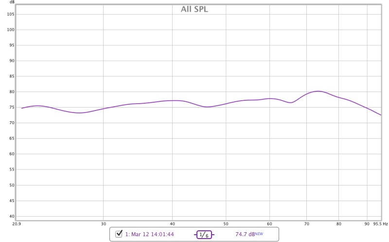

tapped measurement
Here is my measurement. Tapped from 20hz to 60hz 3rd order Linkwitz-Riley crossed to dual Tad 1601b woofers.
Tapped is pretty flat from 20 to 60hz. However I use it with the mouth at top. You may try that to reduce floor reflections. Also keep it in phase with the rest of the speakers not to have bumps or dips because of their interaction..
