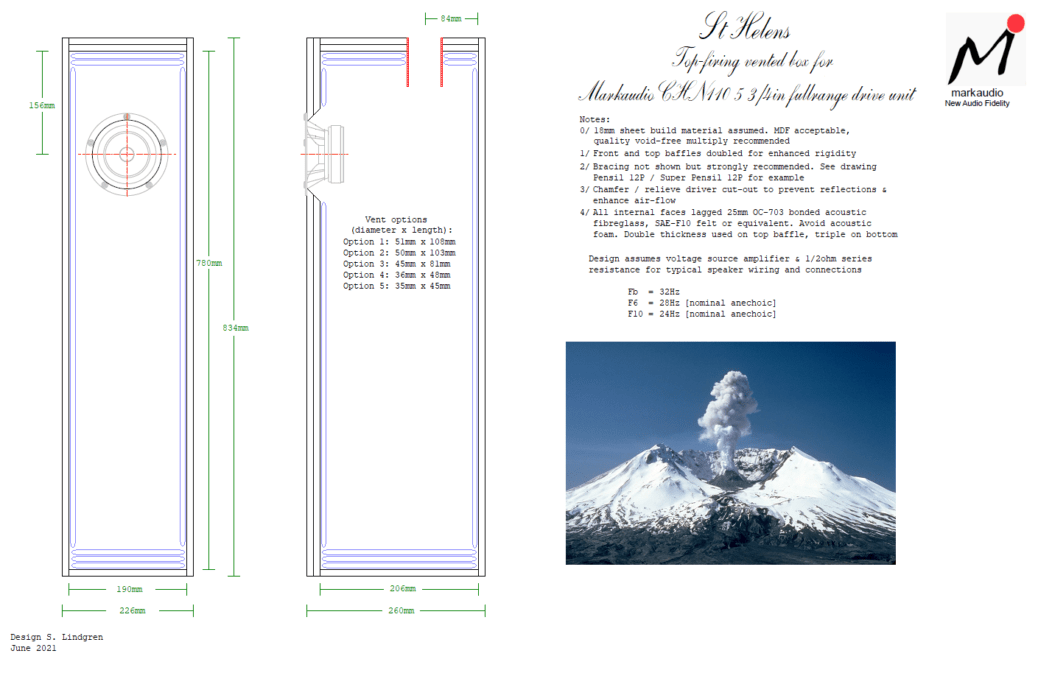

The idea is to use the CHR-120 or the CHN-110, in large boxes such as the St Helens for the latter (Fb 32hz, upward firing, 30.6 liters). Or the Classic 35 liters vented box for the CHR-120 (Fb 36 hz)
I would lean towards CHN-110 in St Helens as the driver is cheaper.

You won’t be disappointed with the CHN-110. Really an outstanding driver.
It will sound different than the B&W. Likely more DDR. No XO and no whizzer makes for a seemless range. Has a much more controlled top than ome of the pricier ones. Needs a bigger box but you get lower because of that.

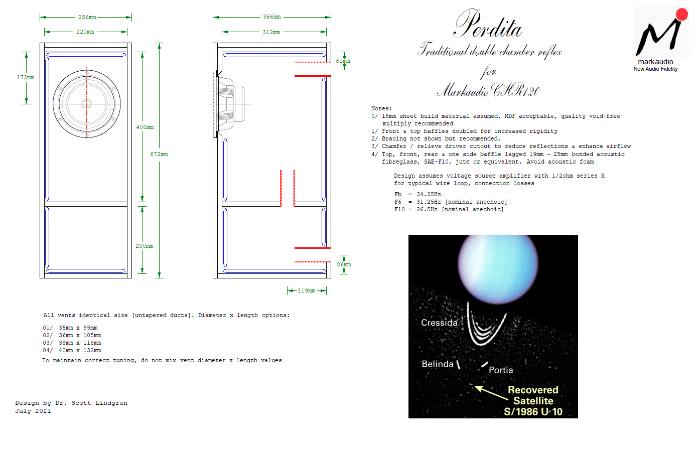

I'll have to use the CHR-120.

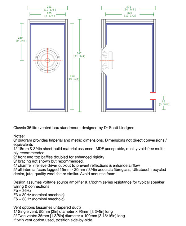

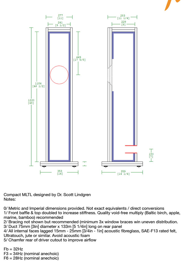

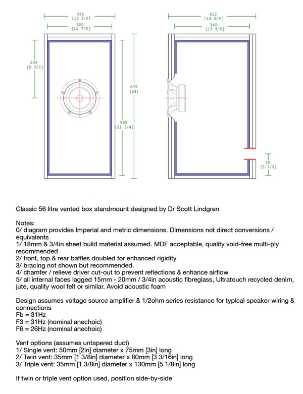

What do you think of this driver in a 35-40 liter box?
Like these.
Which one do you think is better
