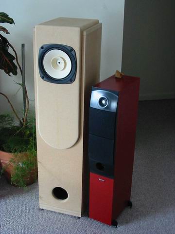

Please don't overlook the FE206E. A much better, overall choice than the 208EZ, the sigma does not have enough high frequency extension to run on it's own in my and many others opinions. True the 206 does not have the beefy, technically advanced construction of the 208sigma but it's sound is, nontheless, incredible. Plus you'll save money on the drivers and by not having to buy a supertweeter, which you can decide if you need later. I have not found the need to boost the high end of this driver.
I second the ML TL option, take a look at mr.King's site (I just built a pair of ML TL cabs with FE206e based loosely on his design and am very impressed, blows my 2.5 ways out of the water). These are fairly easy to construct when compared to BL horns.

BTW this is a pic of one of my ML TL cabs featuring the FE206E. constucted of Baltic Birch ply with MDF outer layer and still showing it's nakedness, paint to come in spring. Behind it(not visible) sits the compensation network in it's own box. Standing next to it is one of my old 2.5 way HT speakers, nothing hot to begin with but definitely uncomparable in sound quality to the Fostex.
