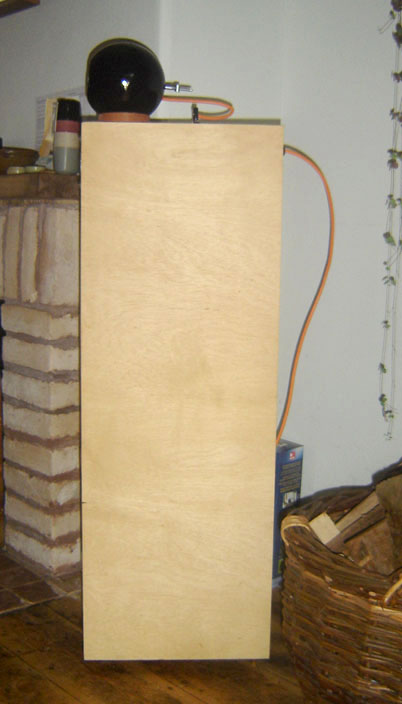

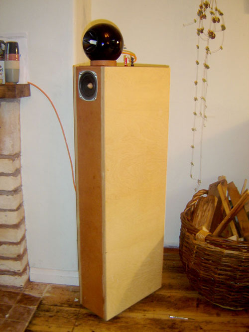

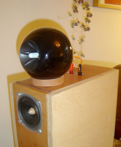

I've added some piezo tweeters to my leather Buschhorns. The tweeters are housed in (new!) toilet floats which I painted with black enamel paint. The screw/spring combination sticking out the back allows for fine tuning of the tweeter in line with the opening. The tweeters themselves have been treated with damar varnish and the horns damped with sealant. The 'crossover' is just a 22R resistor and a .22uF polypropelene cap in series with the + terminal.
