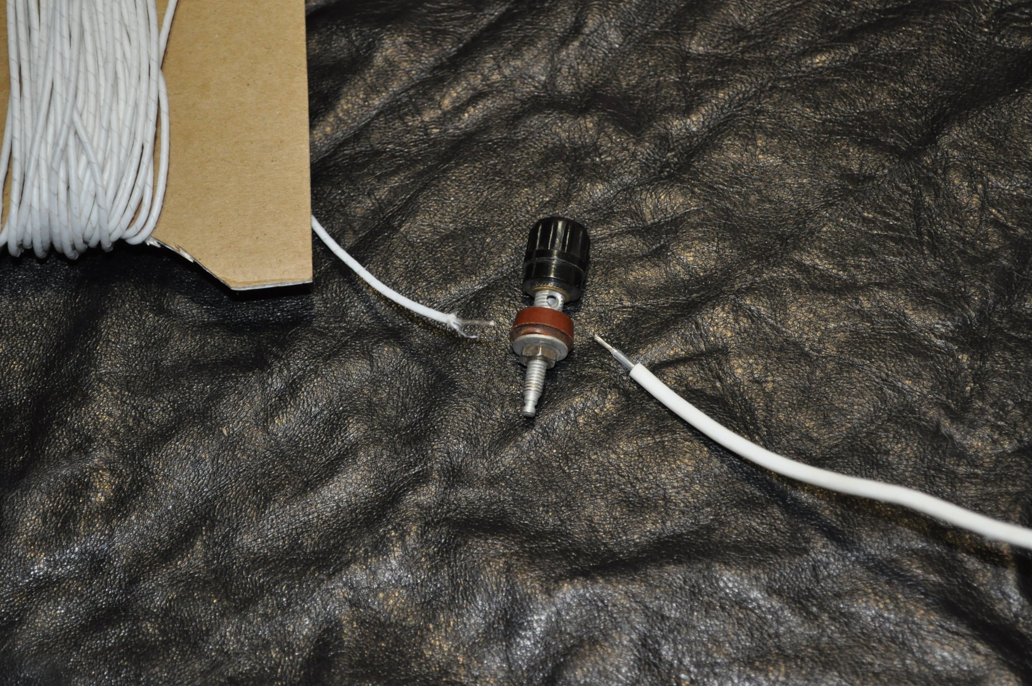

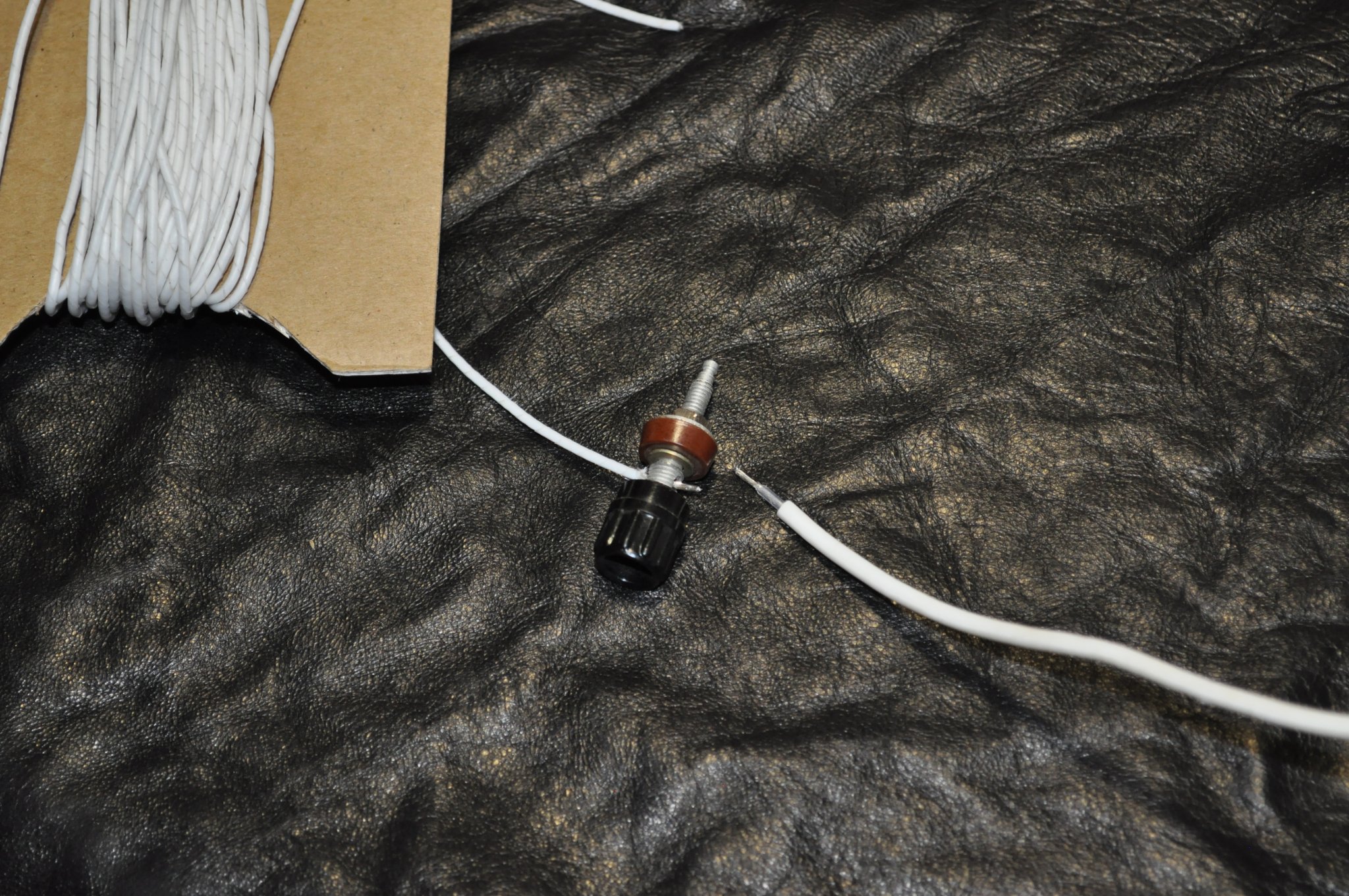

Starting to think about how to make a box for two transformers and a polarizing voltage multiplier for the membranes.
It will be some kind of flat box about the size of a subwoofer and will stand behind the subwoofer.
By the way, all the wires, literally all that connect all the components, which are transformers, multiplier, wires leading from the amplifier to the transformers and from transformers to the speakers, I used silver-plated and in fluoroplastic insulation even Soviet production.
But to do this I had to go to a nearby town and find an elderly man who has kept these wires, I remembered how 15 years ago I saw him selling them at the radio market and I accidentally saved his phone.
And all the wires that are inside the subwoofers (there are a lot of wires leading to the stators and diaphragms), I used too of this type, but in double insulation.
Connectors also used Soviet, I accidentally found them at the radio market, these connectors instrumental type material of white bronze.
I decided that since I'm making it for myself, I don't need to put beautiful Chinese "gold" connectors here:LOL:.
They are brand new and unused.
The soldering is done at the end.
I just came across them at a radio market and I couldn't stand it.
These connectors were used in laboratory instruments about 50 years ago.
But I don't have any complaints about the connectors. The only thing I think: the less mass of metal in any connector, the less coloring in the sound will be.
Ideally, it is to twist two wires with the largest area, but here it will be the only connector on the signal path from the amplifier-transformer-speaker.
We must remember that in electrostatics, where there is high voltage, the most important thing is good contacts :) .
