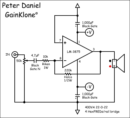

hey everyone. i jumped on the bandwagon and threw together a gainclone. i used the minimized schematic, or rather the peter daniel schematic. unfortunately, im pretty much an idiot with electronics, and im having trouble with the schematic. i know its dead simple, but there is just a couple things i cant figure out.
i figured out the whole schematic, and put it together really close p2p, and it turned out well. however, i dont get the input part of the schematic. peter has been trying to help me out, but im just such a novice, i hate wasting his time. maybe someone else in here can help me out.
from pin 8, i have a 220K resistor connected to pin 3. then i have 10K, 1W resistor connected. but then what? i know there is supposed to be a 2.2uf (or 4.7uf) non polar cap there, but then where does that go? that whole area of the schematic just doesnt make sense... can someone just simple spell it all out for me? like, part A goes into part B? i looked on numerous websites trying to figure out how the diagrams work, and how to put them together, but no luck.

This is the schematic you should use. 220K resistor is between pin 3 and 8. From your RCA jack the signal goes to the pot (if not using pot connect the input with 50k resistor to ground), then you connect the cap, the other pin of the cap connects to 10K resistor and the other lead of resistor connects to pin 8. So, pin 8 is connected with 2 resistors: 10k and 220k.

Um, that circuit needs to be powered with a bipolar supply. In other words, +V and -V. If you're using two 12 volt batteries in series and running a straight 24 volts to the power supply pins on the chip, it's not going to work properly with that circuit.
You'll need to use the batteries like this:

It sounds like you may have it hooked up to a single 24 volt supply.
The LM-3875 can operate from a single supply, but not using Peter's circuit.

ah cool. i can try that... so basically use the point where i connected the positive to negative to make the series, and make that the ground? i can try that. the batteries have plenty of juice i think. they are like 5 pounds each.

Well, the point where you connected the positive and negative battery terminals to wire them in series, yes.
And how much juice the batteries have depends not on their weight but how much juice they have. If they've been discharged, it doesn't matter how heavy they are, they'll be out of juice. :)

it doesnt have that NASTY noise in the background. however, i put in that 50K resistor like peter said, and there is a nice BUZZ in the speaker. and, its very quiet. i tried without, and its fine.
also, i am not using the 4.7uf cap on pin 8. the idiot at the electronics store forgot to put it into my bag :) maybe that has something to do do with it. i will say this thing has some POWER. im not 100% quality, but that's partly due to the power its getting probably... in the 5 minutes ive been listening to it, its gone from 26.4 volts, down to 25.33 and dropping as we speak.
any ideas as to why adding that resistor adds so much hum? (from the ground, i have a kinda star ground, and from that there is a lead going to the ground on the rca jack, and in between the star ground and the rca ground, im connecting it... i hope thats right...)
