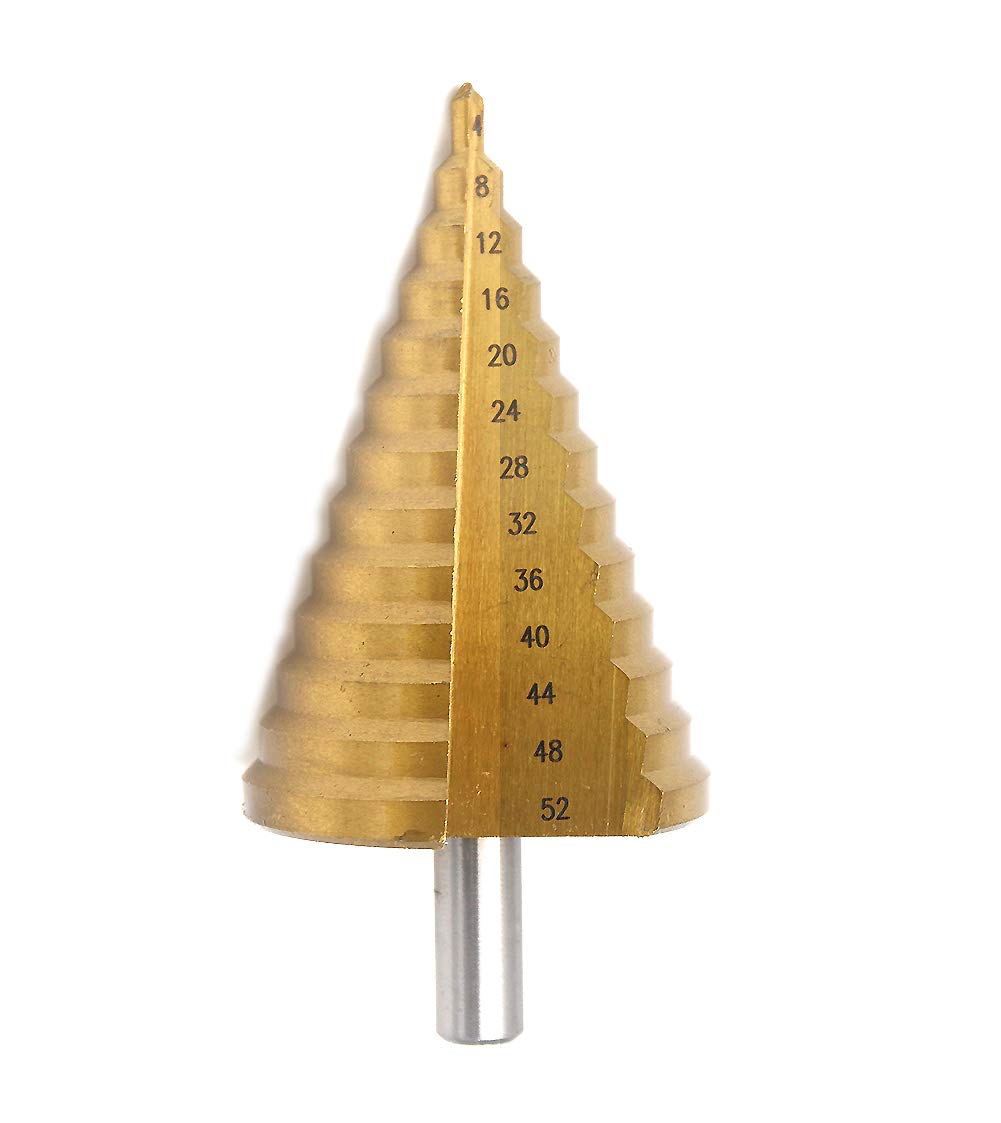

Looks like I'll be using a step drill bit.Anyone in the US know where to find an affordable metric knockout punch set that goes up to 52mm or more?( I'll take Imperial that goes to 2" )

Yeah. but The ones electricians use are usually sized for conduit. Thanks, but I'll stick with the step bit.kijiji - got a used greenlee knockout punch cheap from an electrician who'd just retired. I just looked locally and there are lots available.
This is what I'll use.
https://www.amazon.com/dp/B07C2W9X4...olid=2USCC1PBSE0K9&psc=1&ref_=gv_ov_lig_pi_dp

52 mm is nearly 2". 25.4 mm per inch. Unless you can find a used example, a 2" Greenlee-type panel punch will be prohibitively expensive (ca $150). I would use a hole saw in my drill press. An import 2" hole saw can be bought for under $10 online.
https://www.amazon.com/Koopi-BI-METAL-Replacement-Drilling-Plastic/dp/B07TMP8J62/ref=sxin_15_ac_d_bv
Drilling with a hole saw by hand can be tricky and may not make a very clean hole. I bought this small Wen for my home https://www.amazon.com/gp/product/B08ZVT5JKC/ref=ppx_yo_dt_b_search_asin_title?ie=UTF8&th=1 and have a Jet floor-stander I can use at work. The little Wen is great for light electronics work. With a drill press, you can use a fly cutter https://www.amazon.com/General-Tools-55-Cutter-Adjustable/dp/B00004T7P1/ref=sr_1_5 but do not try to use one of these in a portable drill. In any case, clamp your work securely before cutting any large holes.
Are you cutting it in aluminium? You can try drilingvholesxaroud the inside an reving by cutting between them with a hacksaw. The get so aggressive sandpaper, or a rasp to get rid of the bulk waste. And finish with a conical tube - can be a household item like a ketchup bottle. Wrap the sand paper tight and rotate in the hole by handuntil the hole is enlarged enough.
