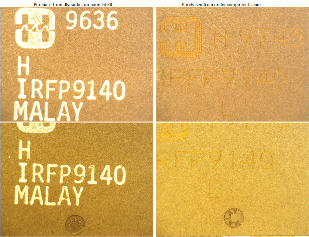

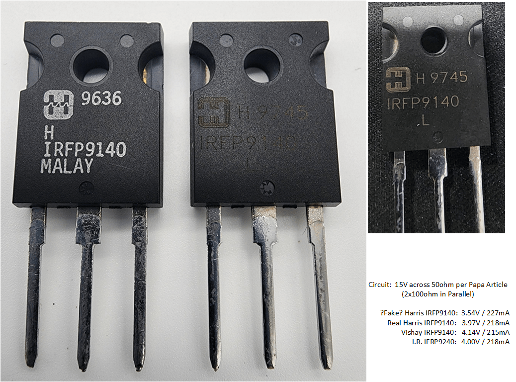

The first relevant post here is regarding determining if parts acquired are Genuine Harris IRFP9140's, or fakes/counterfeits. Below are some images and basic measurements. The date code from '96 to '97 still falls within when Harris was a company prior to being bought by Interstil, but it sure is a clearly different approach to markings from one year to the next. Additionally, the "MALAY" marking is different on the "press" marking indicating a different fabrication line.
I'm curious if anyone can confirm that the laser engraved version here has any chance of being legit. I realize Vgs can vary, so is there any way to clearly know if a part is fake via measurement? I'm willing to give various circuits and measurements a try.

Images below taken from a stereo-microscope and hence the color difference from above.

Any reference to how anyone can test the shelf problem?
By measuring transcoductance over several frequency points. Method is described in the attached article at page 5. Transconductance should remain almost the same. International Rectifier’s IRFP9140 has a gradual drop starting from 200 Hz and shelving at 1 kHz.
There is another markings and logo version of the genuine Harris IRFP9140, probably produced after 1998, when company logo was changed to slanted letters. I’ve just measured them using mentioned article and Gm doesn’t change over frequency. Input capacitance and threshold Vgs also conform to datasheet specifications.
