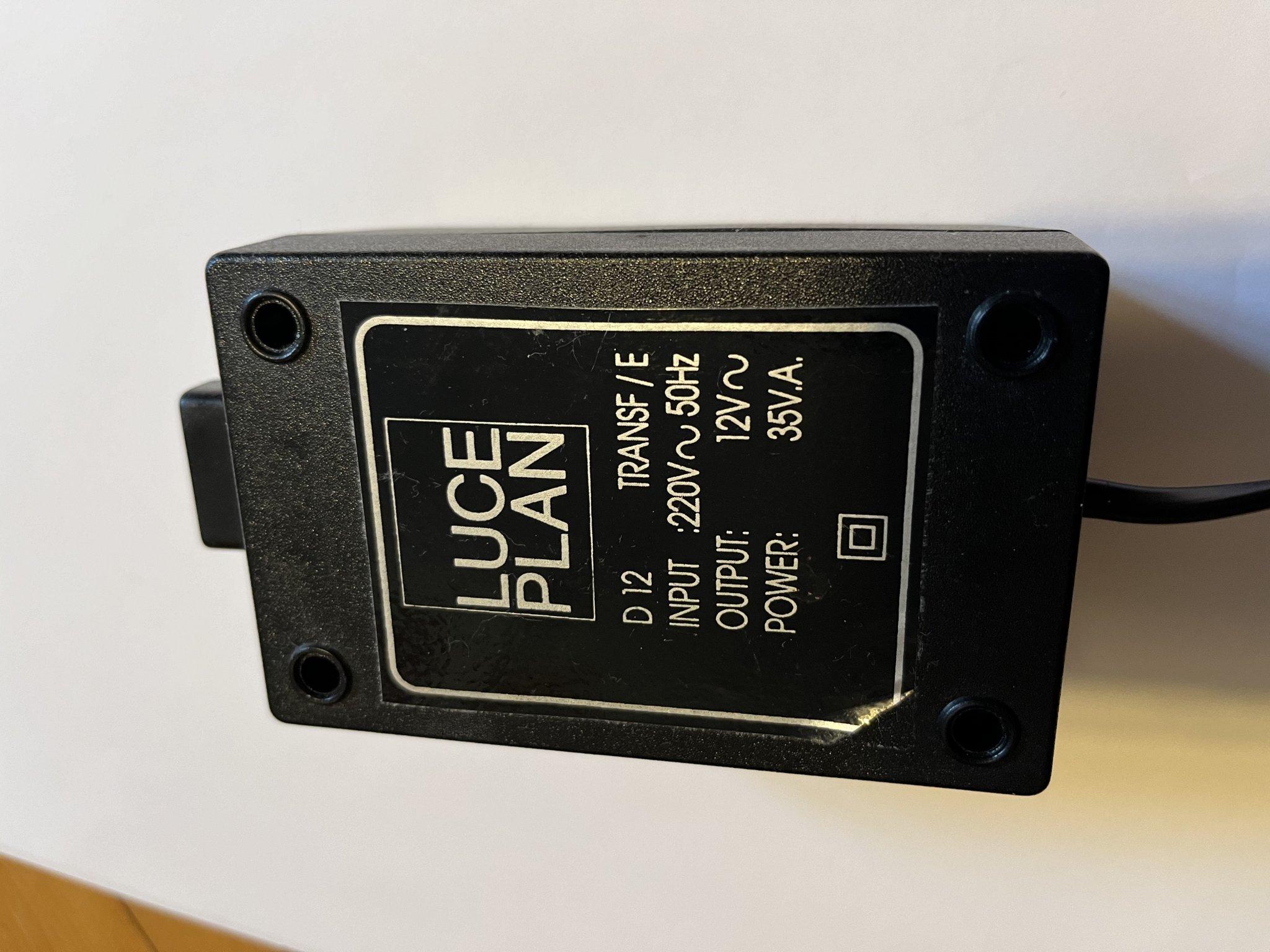

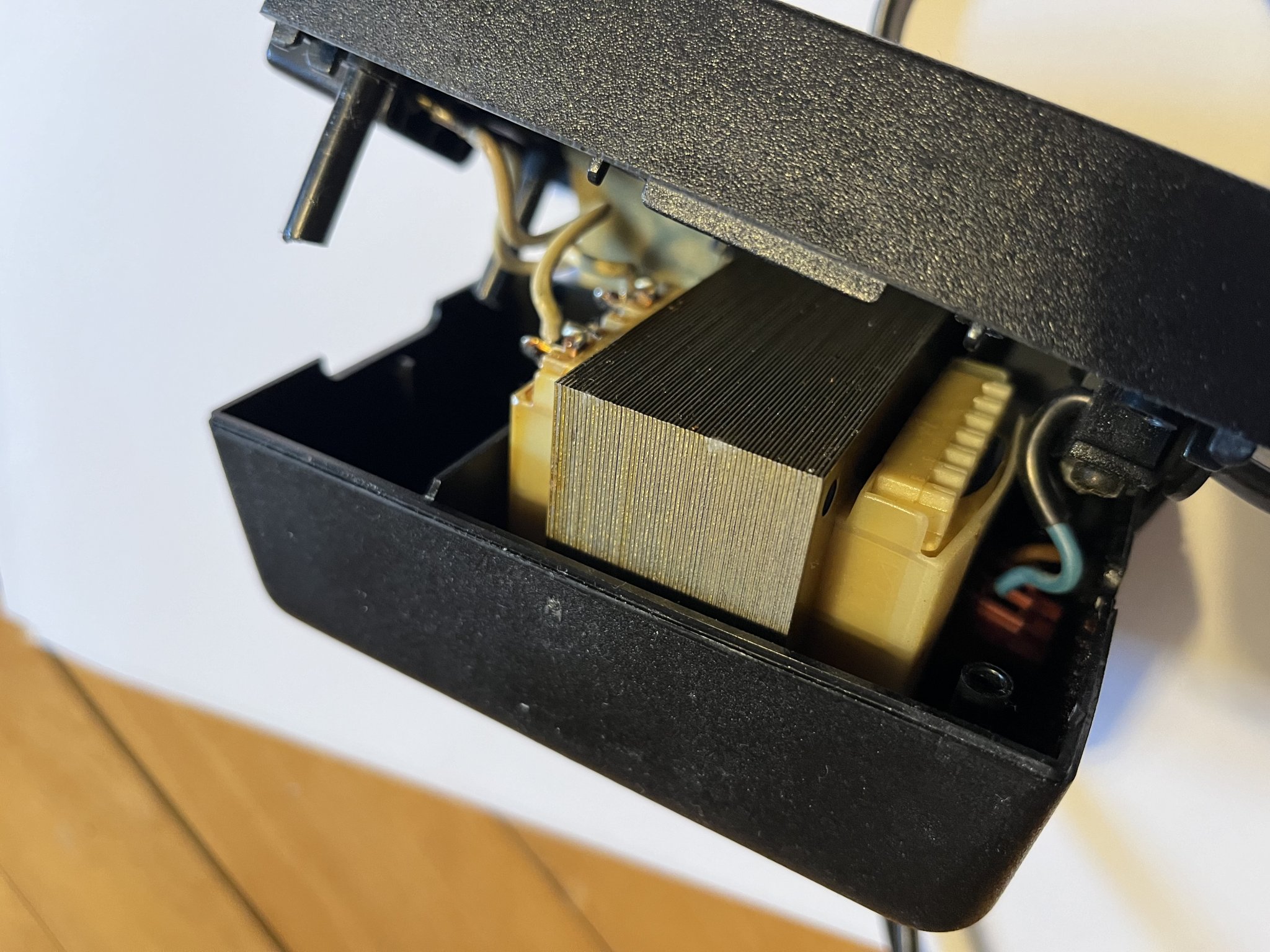

Good morning!
I am, well, puzzled by this situation: Being an old-school-type of guy, I still use halogen-lights wherever it seems not too unreasonable. Now, there's this little reading-lamp I use next to my bed and in the home-office, italian 80ies style. It's one of these late 80ies design-things, has "gliding contacts" to the bulb, runs on 12V AC, 35W, and has an on-off switch at the head (just before the lightbulb) and not much more.
Now, they seem to go down: The lamp seems fine (xformer stays cool) but when it's on the xformer suddenly turns very hot and stops working, until it is back to normal levels when unplugged and here it is again...
I wanted to check so got the other lamp: The transformer in the homeoffice is hot although the lamp was off for at least the night. I thought a lamp would not draw current when off???
This sounds like a shorted turn, possibly more, in the primary - so the transformer is junk (and a hazard, as noted above)
It could be taken apart and the bobbin rewound, but perhaps easier to find a new transformer or LED transformer (SMPS) that can supply 3A at 12V.

The description of when the transformer is heated is a bit unclear. If that transformer does not heat up by itself when it is connected to the mains and switched ON, when the lamp is not connected, and there is 12-13VAC on the secondary, then everything is fine with the transformer and the problems should be looked for in the lamp. It is old, maybe the insulation of the wires has loosened somewhere, so they need to be replaced. If the switched ON transformer heats up without a connected lamp, then the problem is in the bridged windings in the primary or secondary, and that is thrown away and a new one is bought. Transformer 12VAC or DC power supply of appropriate power according to the power of the lamp, and it is better to be twice as strong.

The original transformer, with double insulation, becomes warm because it draws about 3W when the lamp is off due to inefficient magnetic design, and it is normal. This may lead to shorted turns over time. It you need to replace it, you must use a medical grade, double insulated (no ground connection) SMPS from a reputable manufacturer because the output wires are exposed to the touch. For the same reason, it must have a good short circuit protection and current limitation calibrated to the need of the 35W alogen lamp because the wires may be accidentally shorted out and this may pose a hazard. On my experience, faulty/damaged wires are also a common issue.
