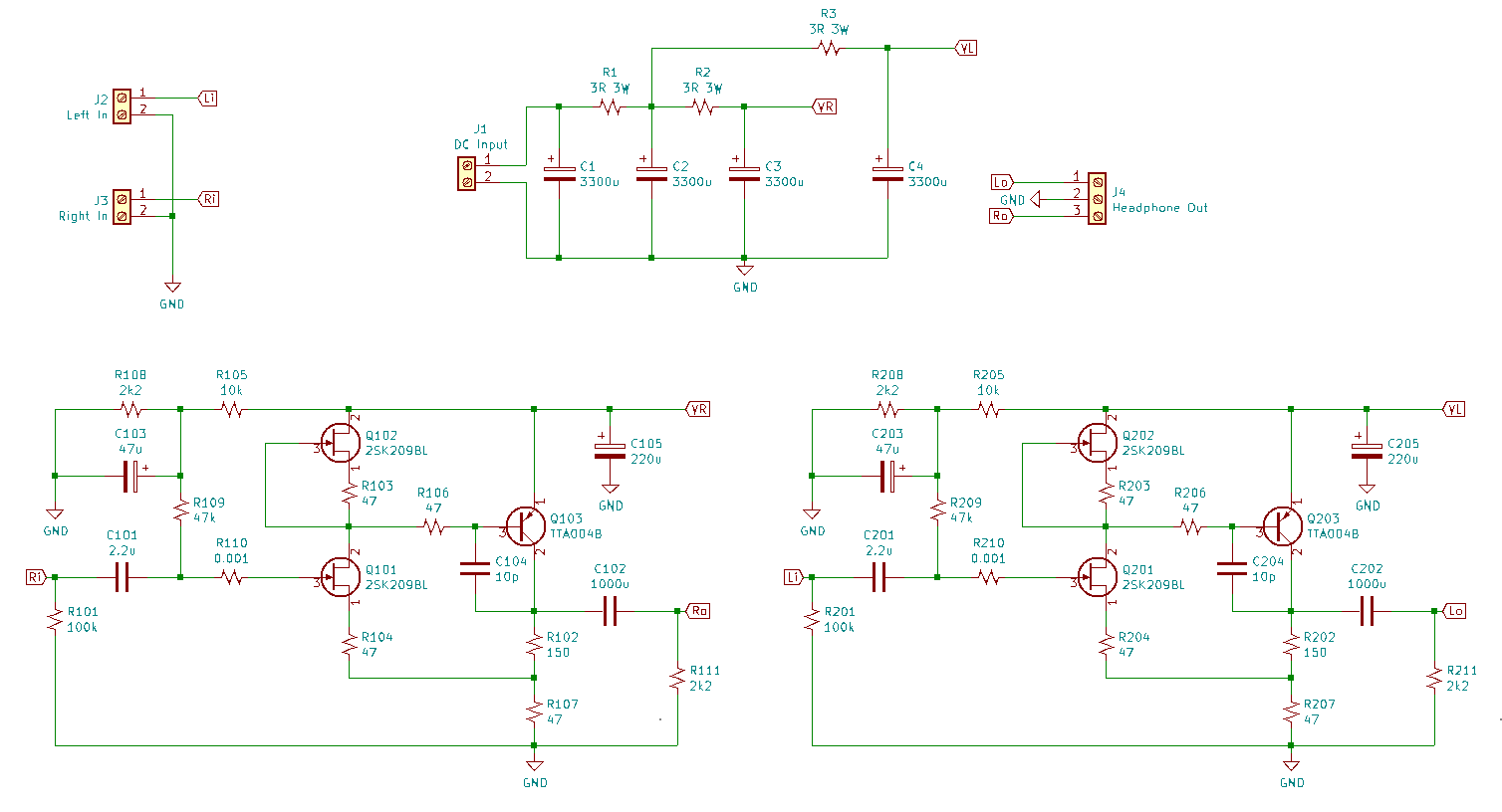

This amp piqued my interest for a desktop HPA for office use, due to its simplicity and ready availability of parts. I've put together a PCB using Bambinz's CCS mod, and a TTA004B in place of the DZT because my phones are 32 ohm. It's not the prettiest layout, but I wanted to use mostly THT components and still come in at under 100x100mm to keep the PCB's cheap. I added a CRCRC filter on the DC input, with separate second filter stages for the left and right sides.
I did have one question though: what is the best method for finding the resistor combinations needed to raise the bias current to ~125mA? Just plugging values into LT Spice and seeing what happens?
Pictures of layout and circuit attached. Would be happy to share the files with anyone interested in building a simpler version of the amp, if that's OK with xrk! Also of course, any critiques are welcome.
