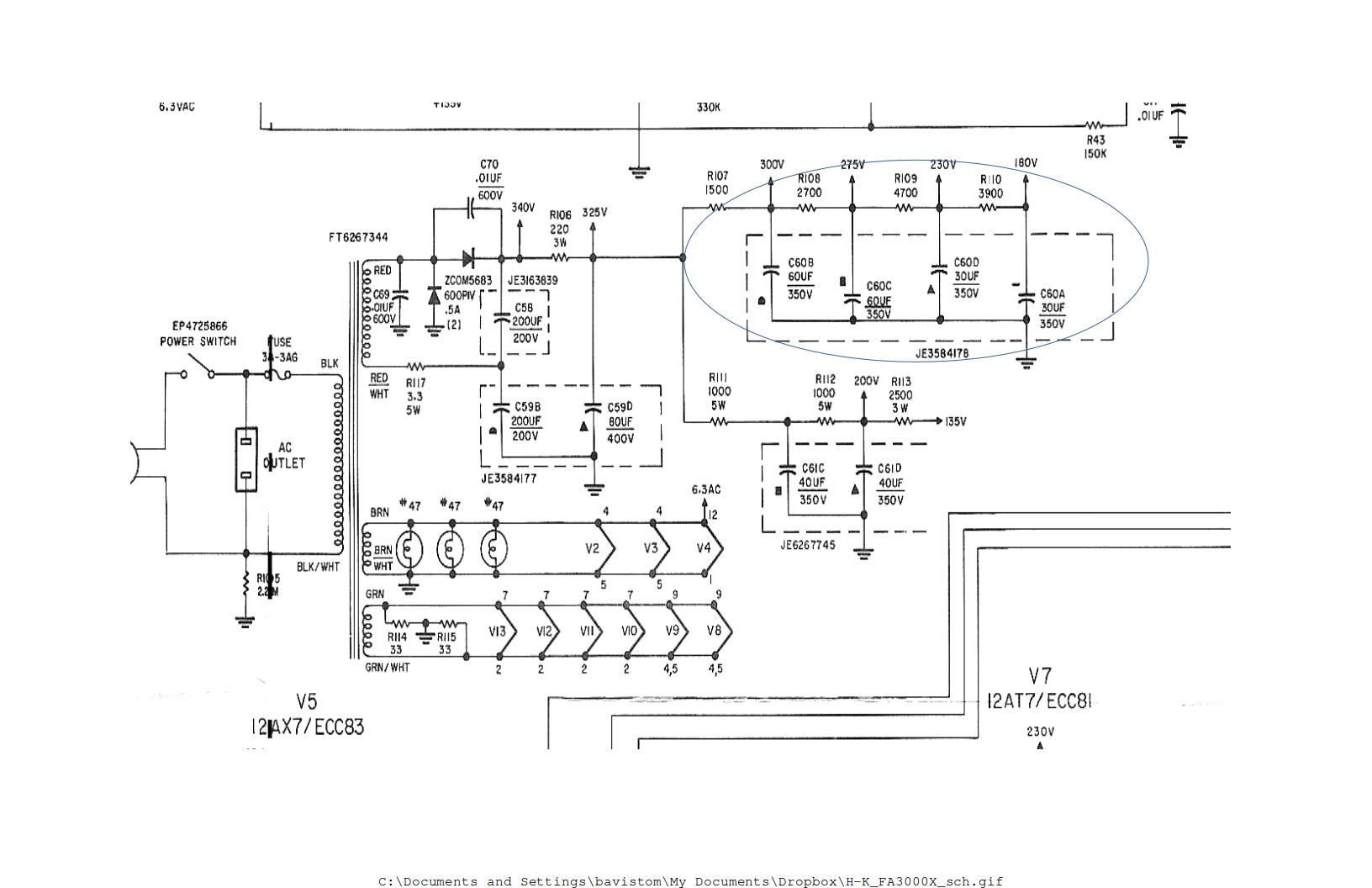

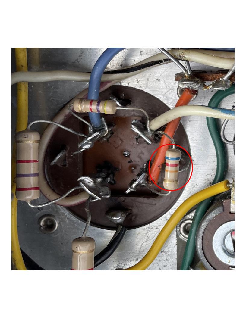

Hello All, I just received some replacement electrolytic caps and I don't understand why someone appears to have replaced a 3900 ohm resistor with a 62000 ohm value on the C60 electrolytic cap?? (See the attached pictures). I'm trying to decide if I should follow the schematic or just keep what I have. Now I have the Harmon-Kardon FA-30X and this schematic is for the FA-3000X but I couldn't find a FA-30X schematic. My gut tells me to follow the schematic and use a variac but my gut is wrong about 80% of the time! Any advice would be appreciated!!!

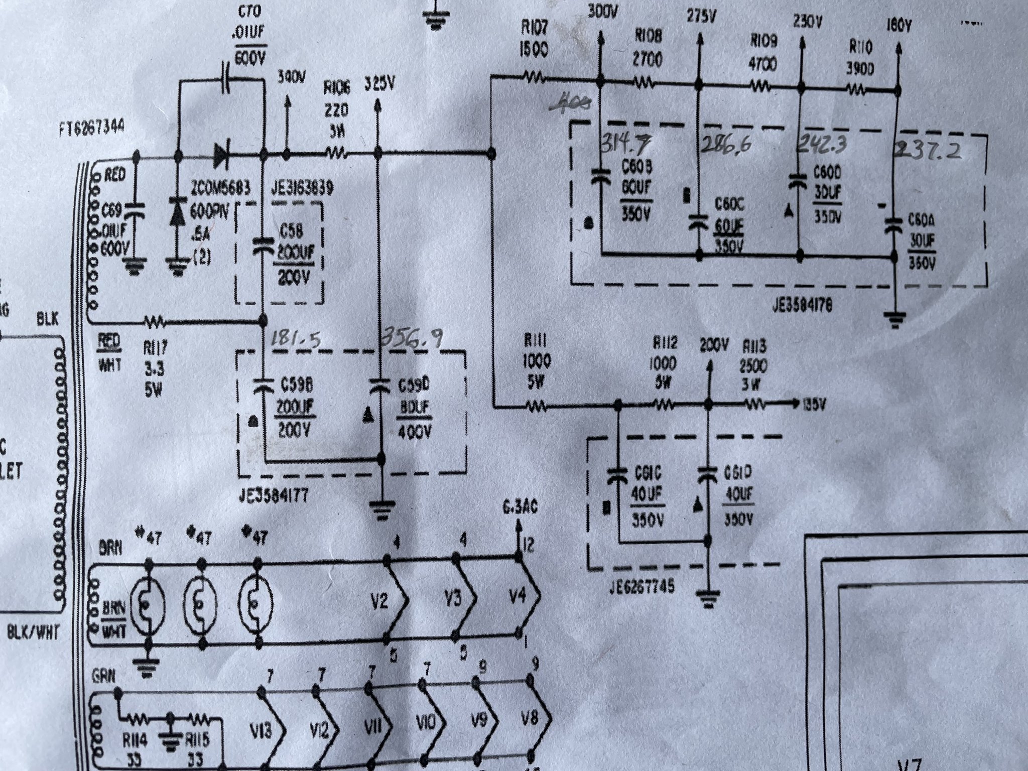

I replaced all the power supply electrolytics in my Harmon-Kardon FA-30X. I bought this thing on ebay so there have probably been half a dozen people fiddling with it in it's lifetime. For example, in the attachment titled "C60 (copy).jpg" there is a mysterious 62K ohm resistor circled that is not on the schematic. I put it back to a 3900 ohm resistor but I noticed that after playing the receiver for about an hour the power transformer was hot to the touch. Today, I powered it up to take some voltage measurements, (see attachment "schematic02.jpg").

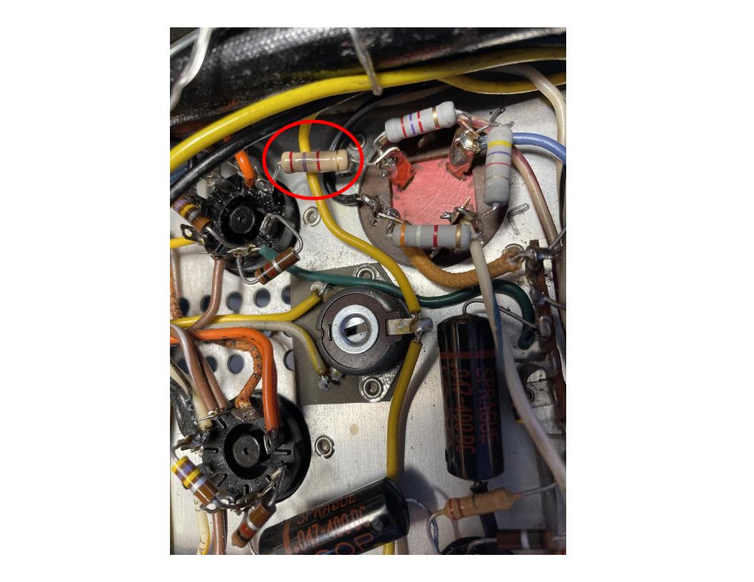

One thing I did different this time was that I left out all the tubes for the FM section of the receiver. I was curious if any of the resistors around the power supply electrolytic caps were hot. Oh yes! The circled resistor in the attachment "C60_07062024_02.jpg" was very hot to the touch! Also, I am wondering if it is a different value from the schematic? If I read the schematic correctly it should be 1500 ohms. In attachment "C60_07062024_02.jpg", the circled resistor is 2700 ohms?
I find schematics mystifying and perhaps I could be mistaken, either way I think the circled resistor in attachment "C60_07062024_02.jpg" is way hotter than it should be.
Sorry but I don't understand anything.
Let's move forward step by step.
To begin with, what is your mains voltage? (from your wall outlet) because it seems that all the voltages are too high and in the same proportions except B+4 which is a problem which will be seen later.
As a point of reference, see if you have 6.3Vac on V2/3/4.
