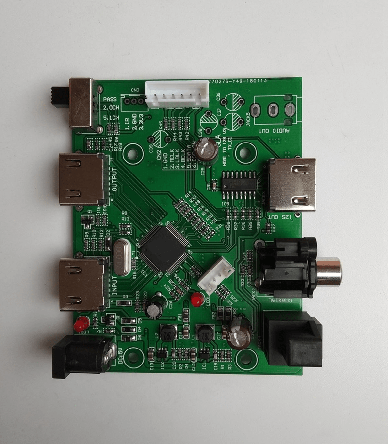

I read the ad, it says "
Note:
- The picture of the product is for reference only, and the right to improve the product is reserved. Please refer to the actual product. Thank you for your understanding!"
I guess the board you get is pictured in the ad, unless they "improve" the product? Anyway, based on the pic in the ad.....
1 is Ground
2 is MCLK or Master clock.
3 is LRLK or Word clock
4 is BCLK or Bit clock
5 is SDATA or Data
6 is DSD ON ??

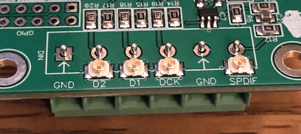

On the BIII Pro,
DCK is Bit clock so DCK to BCLK (4)
D1 is PCM LRCK(Frame clock) so D1 to LRLK (3)
D2 is Data so D2 to SDATA (5)
Ground on DAC to Ground (1)
Looking at that board, I would run in asynch mode, that is use the clock on the DAC.

I did receive the board a few weeks back. It looks legit. I'm in the process of moving right now and won't have a suitable workshop till December unfortunately. But I will find out for sure. I'm hoping it works as I'll use this for a great room setup and a living room setup.
