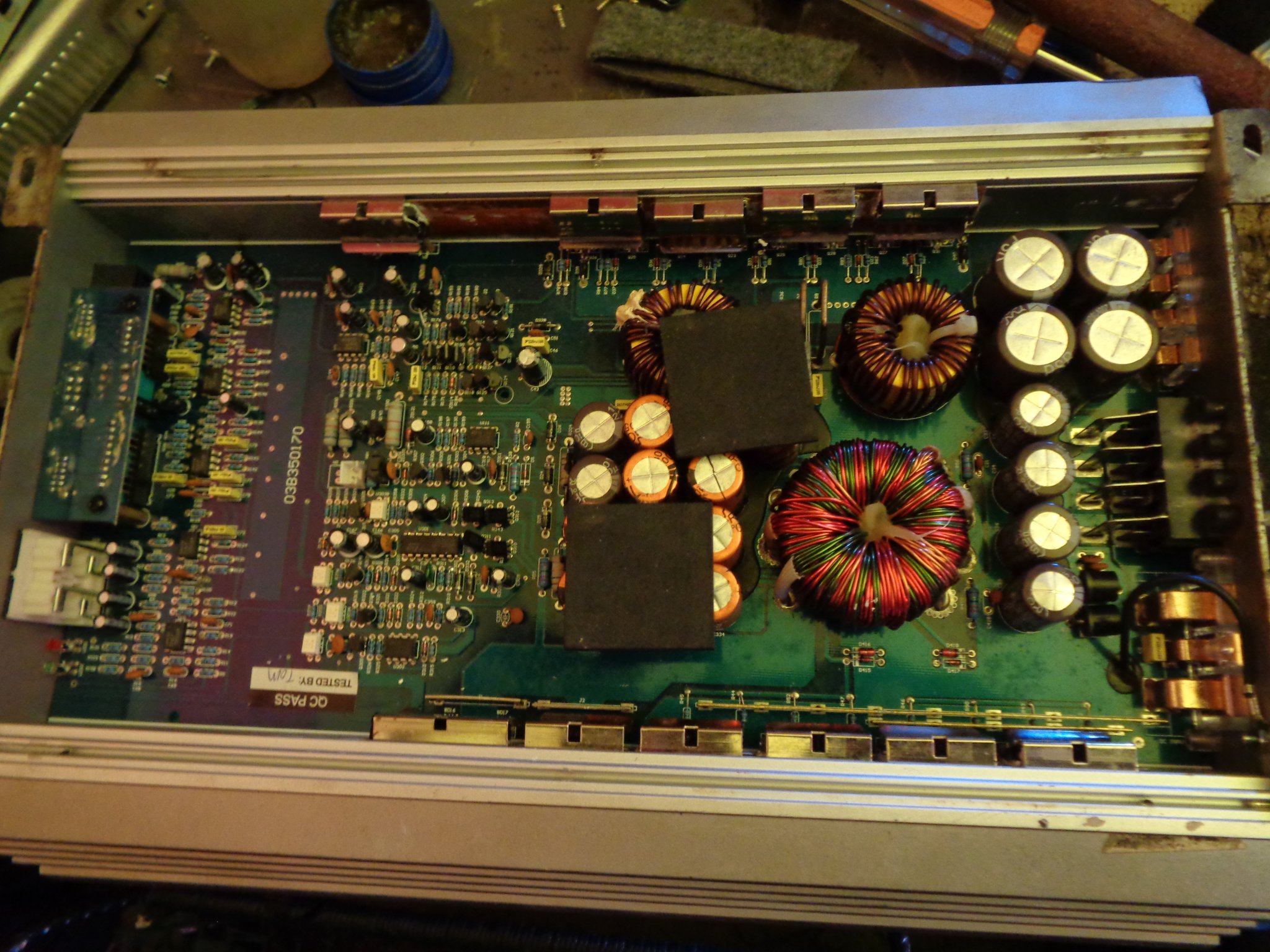

The eurovox brand amplifier, model: EV-A1000D
This amplifier does not have audio. Check with the oscilloscope. I do not have a pulse train in the gate. Apparently the transistors Q110, Q111, Q112 were manipulated. I don't know if they are the correct license plates. If anyone had information about the amplifier or which pulses to check, I would appreciate it. much Greetings.
Thanks for responding Perry Babin and share the pdf file, but a complete photo will help better, since the wave to excite the mosfets of the digital amplifier comes precisely from those drive transients that seem to have been removed
If audio comes out of the U2 integrated circuit at terminal number 1 and number 7, something interesting is how it compares the audio signal and triangular signal to generate the square pulses.The drive module is integrated into the PCB.
