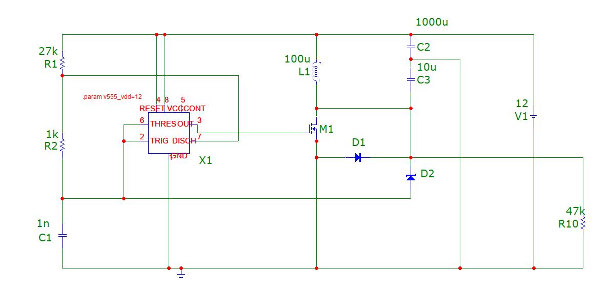

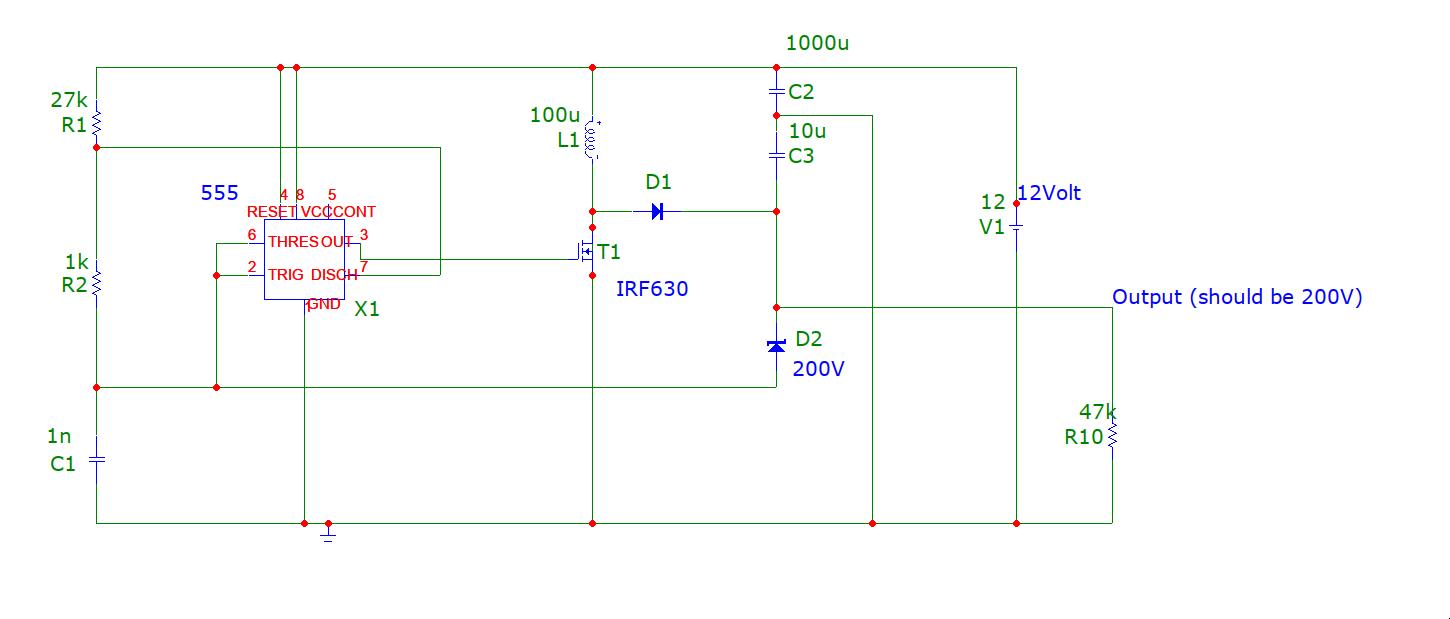

this post can be closed. I did mistakes in shorting some wires in components, error found :)

is there someone working with Micro Cap? I am beginner with spice and i want to simulate a schematic that is from a book and it works in real very nice.
It is a booster from 12 to 200V with 555 and FET. In Simulation i only get 23V on the output, but it should be over 180V.
Maybe i have an error in there, but i cant find. It would be nice if someone is using Micro Cab and would load the circuit to check.
Thanks,
Andreas
