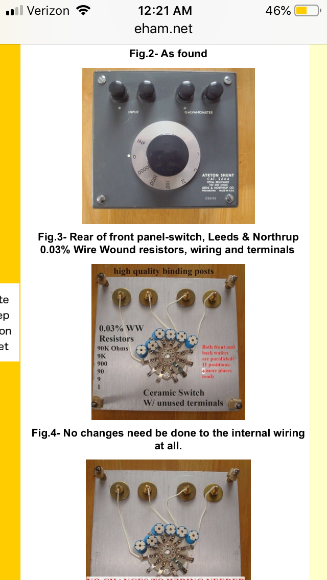

Not sure if this is the correct location for this question but here it goes.
I’m building a dual mono passive preamp using Dact SMD pots. The chassis for each is
a repurposed Leads and Northrop Aryton Shunt Galvonometer. There are heavy duty binding post terminals with large brass posts. For aesthetics and simplicity’s sake I would like to keep these. What sonic degradation might I experience forgoing the RCA jacks here? I have
Read that RCAs are a flawed design sighting skin effect and phase issues. I don’t have an issue with them though I’ve always thought that a solder joint is the weakest link in the signal path.
Rockaway said:
I have
No. You can safely ignore anyone who told you that. RCAs are flawed, but nothing to do with skin effect or phase. RCA is often flimsy, can have poor contact resistance, and makes the signal contact before ground. However, it is successfully used in most domestic audio systems.
The weakest link in a signal path is the transducers: microphones, speakers.
Using binding posts for inputs may mean a bit more hum because you unavoidably introduce some loop area.
I know that capacitance is a factor with passive pre’s.
The shielding on an RCA jacket must contribute to this. If I keep
Exposed area of the cable short on the top where it attaches to the binding posts seems like little RF could “get in”.
The brass posts inside are within the thick walled aluminum chassis and theoretically
Immune to RF magnetic fields ground loops etc.
