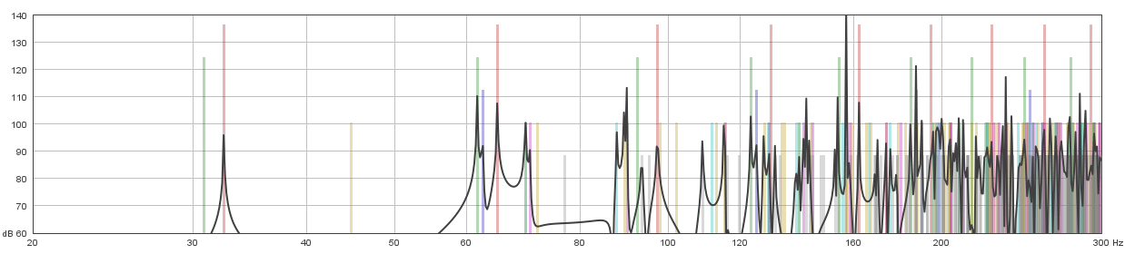

Whereas most rooms have problems with boomy bass, yours is a literal bass killer :confused:
There's indeed a great loss of anything below 120-125Hz.
Front wall treatment will bring MASSIVE improvements.
I've attached pictures of REW room sims below. I assume that your speakers can reach 50Hz.
Moving them around has little effect. The only way is to do heavy room treatments, and follow the advices of other users, who I have no doubt, are far wiser than I am :)
#1: No front wall treatment.

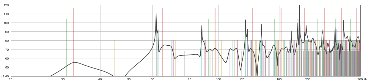

#2: With 0.5 front surface absorption. Still huge dips, but further treatment in other areas will help (P/s: further experimentation tells me they're probably the front/back wall, left wall and floor :))
