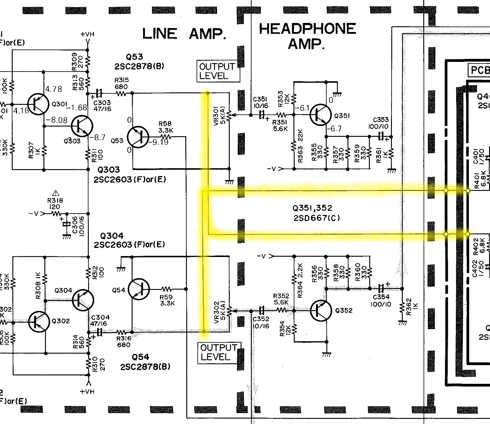

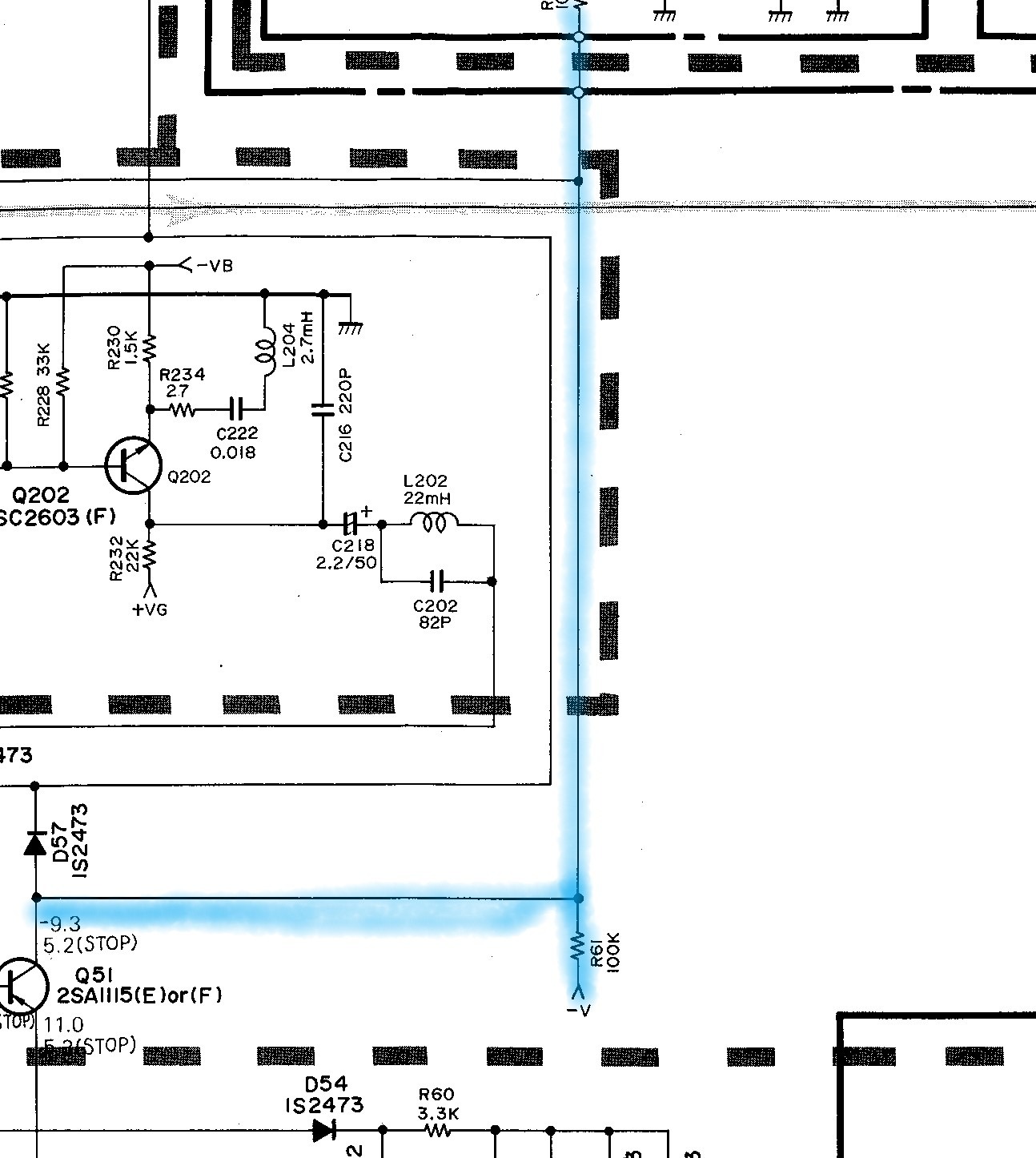

I have figured out this boards 5 wires going in are +VCC which is 12.7, Then V-, Then Ground, Then 2 audio signals, and the standalone wire was the hardest to figure out but I believe its another +Vcc (The standalone wire is the one at the bottom of the LCD picture below traced in blue) Through metering different things and reading component numbers I figured out which wire is which in this 5 cable ribbon.

This image below is the two signal lines going into the board.
This last image is the blue standalone wire that goes to a few capacitors and such then the power supply.
I hooked it all up and it doesn't work.
My only idea is one thing I questioned all along.... I don't know what kind of audio signal this is running off of. Its internal in a tape deck from a bookshelf system so it is not amplified. It also appears to cut in with the headphone jacks so I figured it was some type of analog basic R+ and L+. For testing purposes I hooked it up to my amplified speaker positives but had the volume down almost to zero.
NOTHING! I am hoping you guys can look at these pictures from the service manual and help me figure out what kind of signal I need to get this meter working. I would like to stay with the original HK meters instead of something more modern just for aesthetic reasons.

I'll describe how the circuit works, assuming it's working properly. The "PCB-3" is driven by two audio signals corresponding to the two channels being monitored. Signals would have an amplitude of a few volts peak-to-peak, roughly preamp line out levels as a guess. Q401 is a unity-gain buffer and drives a diode rectifier that converts the AC signal to DC (D401 and C405). The detected voltage is calibrated via VR401 and passes to the display sub-module; the larger the positive detected voltage the larger display amplitude. The other channel has duplicate circuitry. The signal in blue appears to be an enable control that that activates the display, i.e. an electronic power switch.
Your description mentions a LCD display, but the schematic claims a LED display. In any case, I imagine there's a display driver IC controlling the display elements. If there a type number visible, that might be insightful re sensitivity of control inputs.
