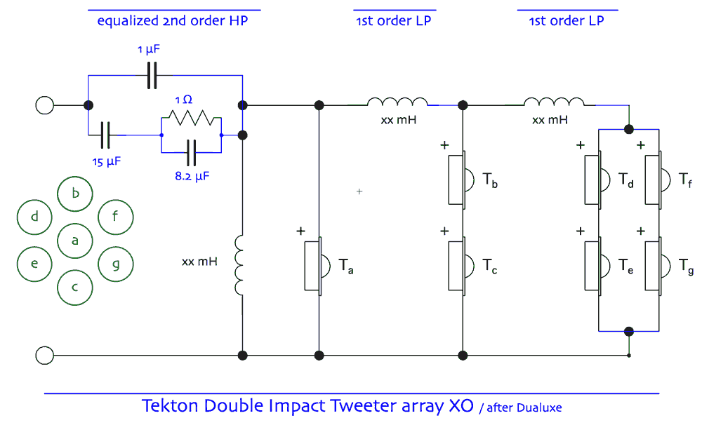

I have a pair of Tekton Double Impacts and I am trying to understand the details of the tweeter array. I created the attached schematic from my pair.
Can any of you crossover gurus break this down and explain the functions of circuit?

I am no XO expert but this is what it looks like to me:
dave
If planet's scema is right it makes sense to me. I see it as an array that grows in size as the frequency goes down.
Ta is the "point", then gradually at a lower freq Tb Tc come into play and at this stage there is rightly a vertical "line array" of 3 units, then eventually at a lower freq still the entire array is active.
diyAudio Moderator
Joined 2008
The resistor shelves the capacitor at some frequency *. Around this point and at higher frequencies the capacitive reactance is below 1 ohm and the resistor is effectively shorted. At lower frequencies, 1 ohm is added to what the 15uF capacitor is doing.
The 1uF capacitor almost looks to be unnecessary, but is likely making a subtle but wanted change in the response. Simulating would make this much easier to understand.
* [about 20kHz - 1/(2*pi*1*0.0000082)]
Could someone explain the second order high pass and equalization circuit? I cannot find any resources that explain the equalization portion of the circuit layout. Thanks!
I believe that mess of capacitors in the top left of the circuit is largely an attempt to protect the amplifier and to lower the cost of the circuit.
For instance, a very high quality 15uf cap is expensive. But it looks to me, that they've done the following:
1) the 1uf cap is probably an expensive one, and they're using it to bypass the 15uf cap and the 8.2uf cap. (If you put a 1uf cap in parallel with a 8.2uf cap, you get a 9.2uf capacitor array.)
2) The resistor is likely there to raise the overall impedance, to protect amps that can't deal with a 2ohm load.
If the designer didn't care about blowing up amplifiers or saving money on capacitors, he could've made the circuit with ONE capacitor, instead of three caps and a resistor. Once you boil it down that way, you can see that the cap and inductor in the start of the circuit is a simple 2nd order high pass filter.

Here's a sim.
First off, here's our drivers : SB29RDNC-C000-4
$58 from Meniscus : SB, SB29RDNC - Meniscus Audio

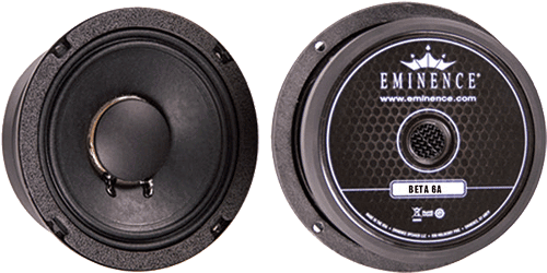

Eminence Beta-6A
$65 from PE : Eminence Beta-6A 6-1/2" High Power Midbass Midrange Woofer Speaker
Side note: I don't know how they make a profit on these speakers. Even if you built these yourself, you're looking at nearly $700 for the midrange and tweeter array alone. The Internet says the speakers retail for $3000 a pair? That's a crazy price.
First off, here's what the circuity would look like with no xover filter whatsoever. This is the basic response you'd expect from a nice soft dome tweeter. 87dB efficiency, a F3 at 1200Hz and output to 20khz.
Here's the response with Tekton's seven element array. There's a series of things happening here:
First off, with a center-to-center spacing of about two inches, the array elements will begin to destructively interfere with each other at about 2khz if they're all playing full range. That's a big IF; the whole point of this xover is to "power taper" the elements on the outside, similar to what D.B. Keele does with his CBT array. Only the center element is getting full power.
Instead of conventional power tapering, the Tekton array filters out the highs but not the lows. This means that below 3khz, the seven element array is basically behaving as a single diaphragm that's approximately seven inches in diameter. This is nice because it narrows the directivity, similar to what a waveguide would do.
In the sim, you can see that the center driver (red) gets full power, the top and bottom tweeter (yellow) get approximately 100% as much power (each) and the outside tweeters get 25% as much power (each.)
The graph is a bit deceptive, because the yellow curve represents *one* tweeter, not two. IE, the combination of the two will be louder than the yellow curve suggests.
The most important part about the whole circuit, is that every tweeter is lowpassed except the tweeter in the center.
As if all of this wasn't confusing enough, the low pass filters on the outer elements do one more thing, which is that they CURVE the array. This is because the inductors introduce a delay. So the lowpass filters curve the array, just as if the baffle of the loudspeaker was curved. Curving the array should extend the highs and widen the beamwidth of the array.
All of this is fairly standard stuff if you've read up on the Keele CBT papers. Very similar idea.
In a nutshell, the Tekton speaker uses an array of seven tweeters to raise the on-axis efficiency to about 93dB. The tweeters hand off to an array of high efficiency prosound midranges. The net result should be a speaker that looks (fairly) conventional but has efficiency and directivity control that's similar to a horn. In a lot of ways, it's a two dimensional CBT array.

In post twelve, I made a couple of arguments:
1) The six tweeters in a ring are not playing full range, they are low-passed
2) That mess of capacitors in the front of a circuity isn't necessary. You could do this with a simple 2nd order filter. The mess of capacitors is likely to lower cost by using one expensive cap bypassed with an array of inexpensive caps.
To test this hypothesis, I made another model.
This model has a couple of features:
1) the mess of capacitors is replaced with a single cap
2) The ring of six tweeters is replaced with a ring of six midranges
Picture this array, but replace the six tweeters in the outer ring with six midranges instead. The center tweeter remains unchanged.
Here's the results:
The idea is the same. A single tweeter playing full range in the center, surrounded by six more drivers that are low passed. In this case, the drivers are Tymphany TC6 midranges instead of SB29 tweeters. This drops the cost A LOT. Seven tweeters costs over $400, whereas one tweeter and six midranges costs $106. The use of midranges instead of tweeters makes the rolloff of the array shallower. The overall efficiency is a little bit higher. The impedance is a LOT lower; about half as much. So if you did this, you'd have to tweak the crossover to match it to your amp.
Basically the use of midranges instead of tweeters in the ring lowers the cost a great deal, but the efficiency suffers because the tweeters have an efficiency of 87dB while the midranges have an efficiency of 84dB.
If it were me, I'd use midranges in the ring instead of tweeters. The use of tweeters raises the efficiency a tiny bit, but at an enormous cost, basically quadrupling the cost of the array.
