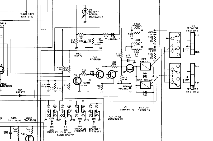

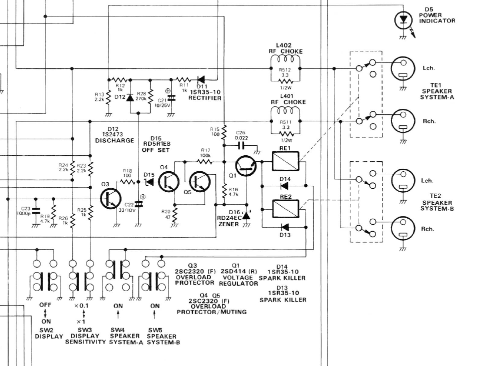

Ok, so some more testing done, and it's the power amp that is cutting out. When i turn the volume up, after just a few minutes, the relays will starting clicking off for a few seconds, then back on. If I turn the volume down it will happily play with no issues.
Hard to be certain, but it also sounds slightly distorted. I've set the bias to a total of 24mV across both test points, there was conflicting info in these threads, wondering if that could be part of the issue?
I've measured DC offset at up to 70mV in one channel, so I assume that's the trigger. I have tried to adjust but it jumps all over the place, not sure whether that could be the trimpot (will replace anyway) or something else. I have done the mod on the input circuit capacitors.

Yes. I set the offset to correct values a while back and then went chasing some issues with the pre-amp. With that solved, the only remaining problem is that both channels will regularly cut out for a second or two at high volumes.
At low volume it seems ok. The relays are switching in and out so I assumed it is something to do with the protection circuit and had a closer look at the offset.
I only have a multimeter, but on one channel it is a lot less stable and moves up and down over time. The trimpot is also very sensitive, moving it by 5 degrees can make the offset change by 200mV.
So I will replace the trimpot, but wondering if there is anything else I should be looking at.

From the schematic, the amp seems to have a DC gain of about 18.4 V/V. I estimate the the offset pot should produce about +/- 72mV at full rotations at the wiper terminal. In turn, this should yield about 2.65V peak-to-peak adjustment range observed at amp output. I would think that 200mV adjustment would correspond to roughly 8% of the adjustment range of the trimmer. Are the 20V Zeners (D402, D404) regulating properly? Do both channels behave similarly?
Another interesting clue would look at DC across R406. It will reveal net base bias current drawn by Q402 and Q406. Ideally it will be 0mV. Compare with the other channel for insight. If adjacent range is badly centered, the base currents of Q402 and Q406 may be badly mismatched. Let us know what you observe in each channel.

Yes, D402 and D404 are shunt regulators and should present about 20 VDC across each. They are probably OK, but if they were open, they would exacerbate offset drift and make the DC trim much more "twitchy."
There's a large number of possible culprits. The problem could lie within the PA itself, or it might be a defect in the protection circuitry. Since the problem seems to be provoked by increasing volume, my suspicion is a protection problem--- but that's only a guess. The protection circuit is shared by both channels, and looks at both DC offset and current drawn; this makes diagnostic isolation more difficult.

Just a last thought, since the DC offset is drifting for both channels, that would imply the issue is on a common circuit, ie on the power output display board. I had read these could have heat problems so I pulled it out and had a good look - no obvious issues there. It's hard to get at so can't really measure anything whilst active.
** Is a DC reading of up to 50mV ok for the speakers? ** I'm assuming that if it gets close to damage levels the relay will kick in so I'm ok to keep using it as is.
