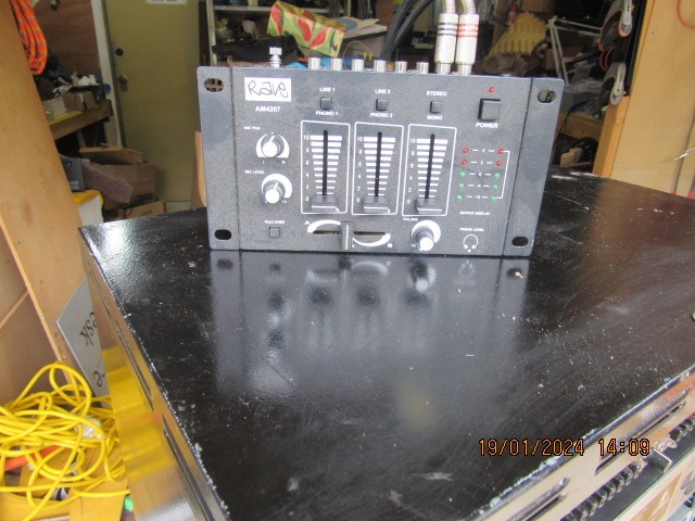

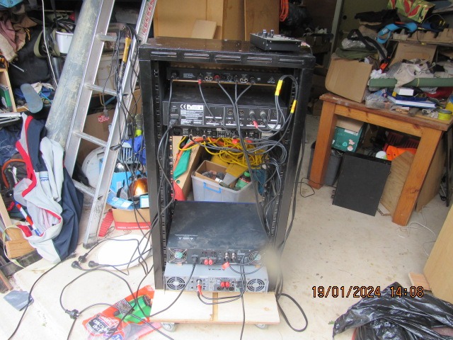

Here's the pix of the rack
The little mixer isn't what I want but it's all I could find at short notice, my old mixer seems to have developed a terminal fault after 40 years. So no echo or anything ATM.
So top to bottom
Behringer Ultragraph Pro
Behringer Ultracurve Pro
B :: CX3400
Australian Monitor SY 800
Peavey PVi 2000
I just went out and bought 4 SpeakOn connectors and will wire up some HD cables soon
The amps can probable put out twice what the speakers can handle so I'll need to be careful. I think that the only short cables I need are from the Ultracurve to the crossover and I'm picking up a pair 500mm long tomorrow morning.

Taking advice from Brett I am running the signal cables down one side and the power cables down the other so at the moment I'm looking for a vertical power strip that doesn't cost me a kidney

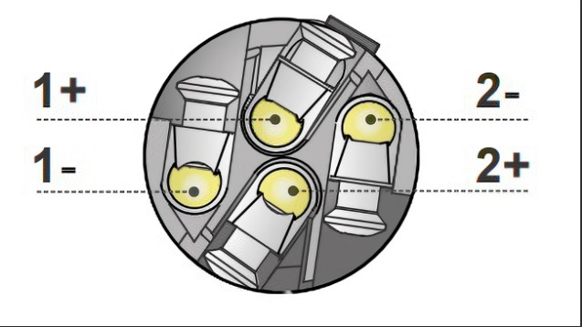

I think I've been sold copies of the Speakon connectors I just bought, Just double checking on the wiring of 2-pole connectors' Which connector terminal is the hot ?? These are not marked so I guess Chinese copies

That seems to be good method to keep a rack tidy and organized... which is a good thing, but on the other hand I routinely run AC and signal(balanced XLR) cables right next to one another between a mixer and powered speakers with no issue, so like everything else your milage will vary.Taking advice from Brett I am running the signal cables down one side and the power cables down the other so at the moment I'm looking for a vertical power strip that doesn't cost me a kidney
So no numbers on the rear of the connector block? This is the Speakon pinout as viewed from the rear where the wires attach.think I've been sold copies of the Speakon connectors I just bought, Just double checking on the wiring of 2-pole connectors' Which connector terminal is the hot ?? These are not marked so I guess Chinese copies

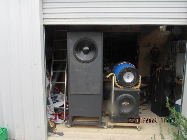

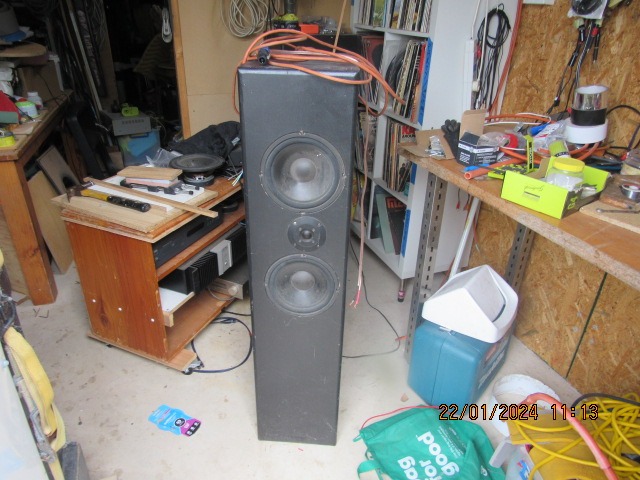

Just some pix of the home party set-up.
Mainly for interest and will be subject to change naturally.
I made the 18" last year and the other woofers are roadkill projects, had the Kicker 15 for decades but The Boss didn't want it in the house because it was too big, so I put it on wheels and the Alpine was found on the roadside and needed a minor repair to the tinsel lead. Running the 4R drivers in series as the 18 is an 8 R driver
The 600 litre box for the 18 is loud enough and deep enough on its own but I'm using the others because I have them
The tops are actually the very first pair of speakers I even built the year I joined the forum. Tandy 8" with 20 ounce magnets, 32mm voice coils and 6mm P-P excursion and an Fs of about 40Hz. I was lucky and got something right first time and been using them ever since.
